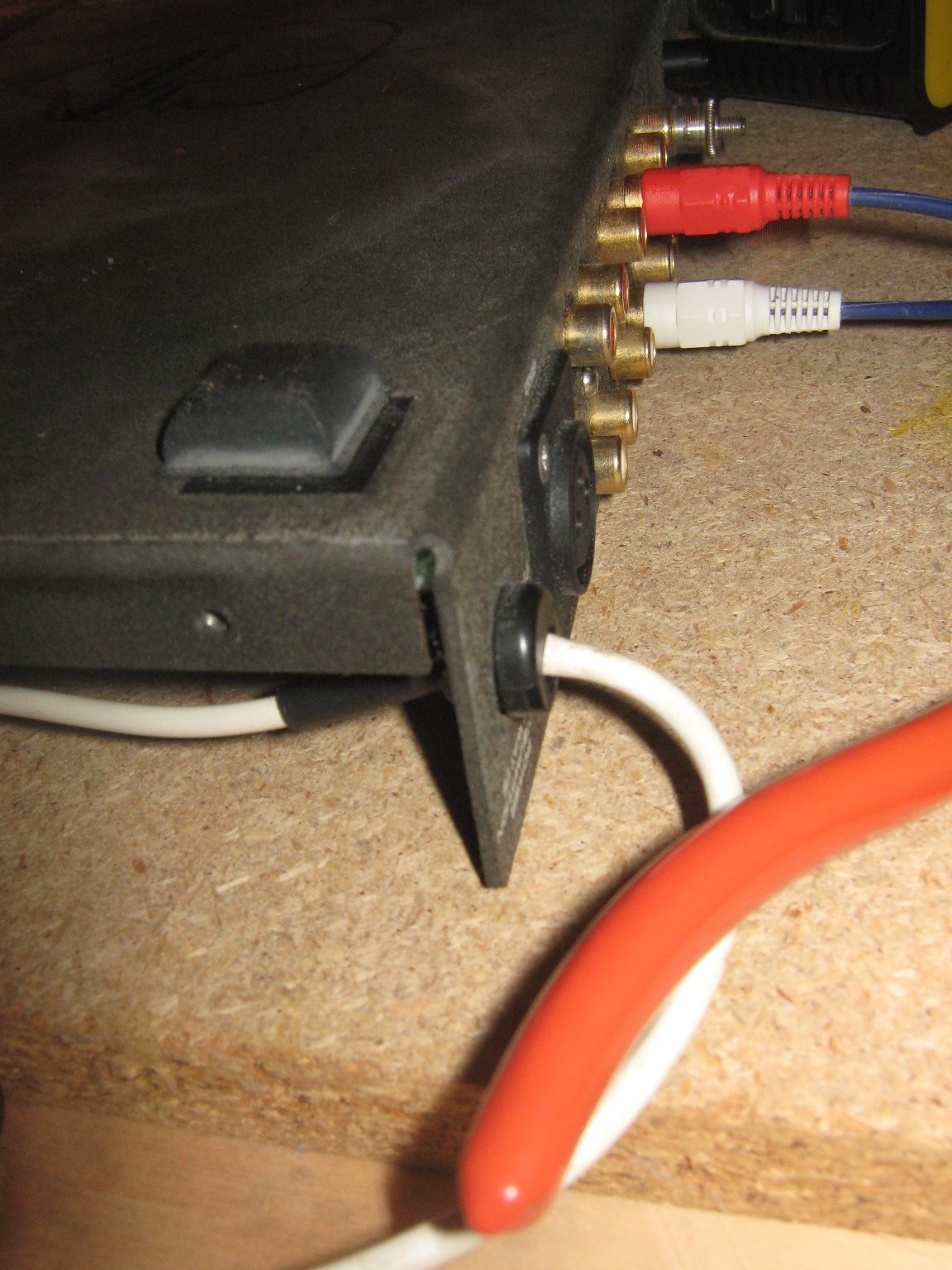

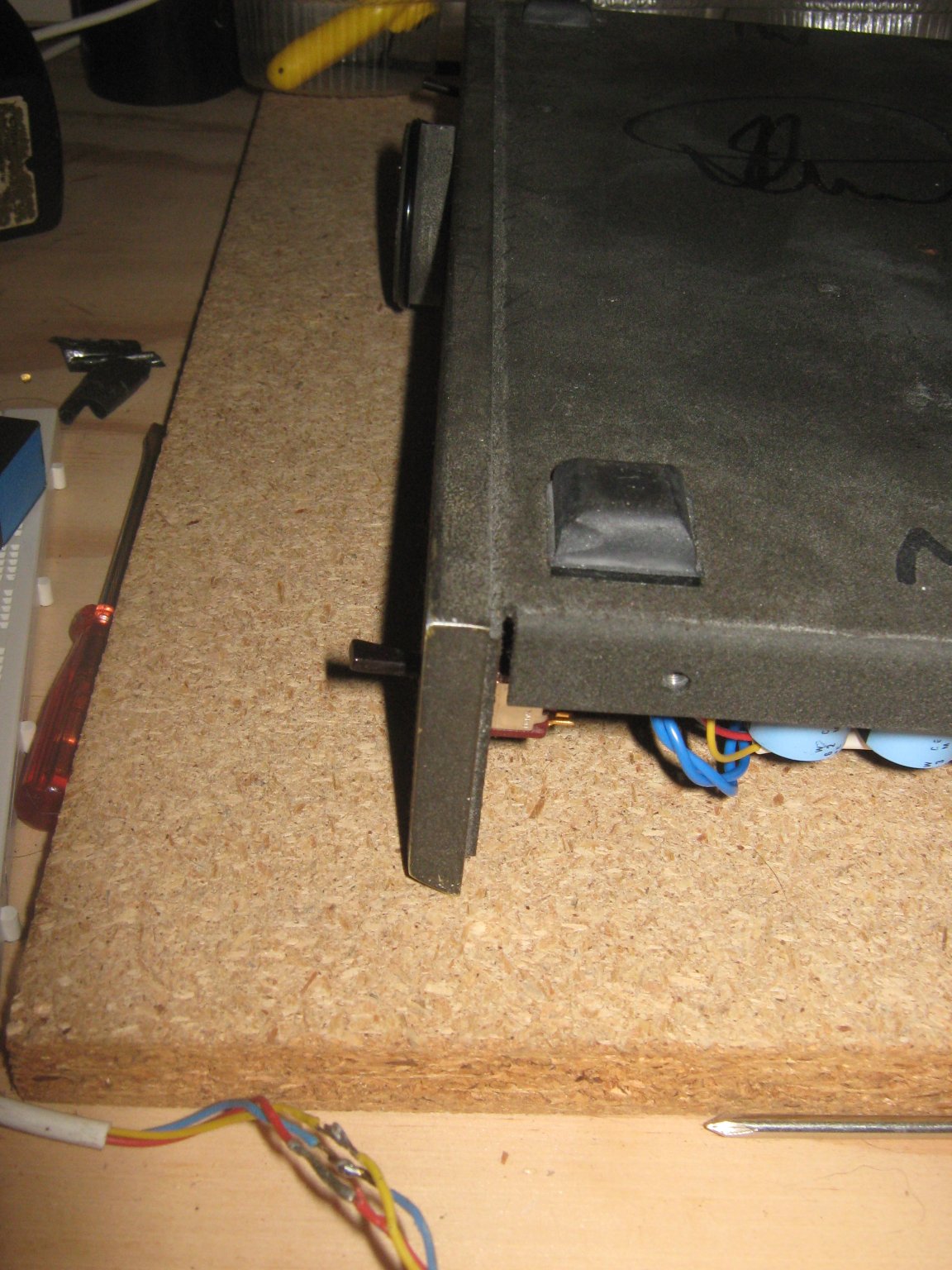

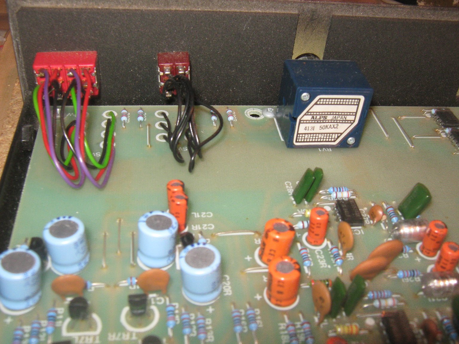

It looks very straightforward... if it needs pulling apart we can come to that later.
Measure initially with all the wires intact.
From what I can make out there appears to be 3 pins on the PCB (near the on/off switch) marked as 0, 15 ?? and 15 with a yellow wire going to 0 and two blue wires to the pins marked 15.
So first test... and I can't see any rectifiers (diodes) near this area so we have to test to see if either AC or DC is present.
Set your meter to an AC volts range (750 range is OK to start) and measure between the yellow to each of the blue wires on those pins. Keep the black lead of the meter on the yellow pin for these tests. If its AC you will see around 15 volts on each blue pin with respect to the yellow.
If you don't measure anything or the readings are low then we see if DC is present.
Set your meter to a DC volts range (say 100 volt range) and again measure between the yellow to each of the blue wires on those pins. Keep the black lead of the meter on the yellow pin for these tests. If its DC I would expect (from the markings) a reading of plus 15 or so volts on one pin and minus 15 on the other.
So that's the first step. Is the unit dead ? I don't think you mentioned what the actual fault was.
Also, can you make out the device type markings of those two black, 8 legged integrated circuits behind the volume control. If we know the type we can identify the supply pins and see whats what 🙂

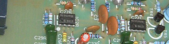

the 2 arachnids seem to bear the legends "NE5534AN" and "S 8419". There is some white script on the PCB near them
I think the relevant bits are IC2R for 1 and IC2L for the other. (There's also a C27R and C27L, close by, I hope that refers to
the adjacent little orange M&M thing.)
There are 4 other arachnids, all are inscribed with "M340" and "LF353N".

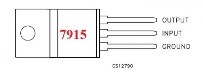

Your meter flipping between - and + when showing approx. zero (0.00) is normal.
The NE5534 and LF353 are "opamps" and have their supplies on pin 4 and pin 8.
The readings from the power supply seem odd (and it may well be a faulty PSU) so the next check is to put your meter on the 20 volts DC range and measure between ground (use that big knurled nut on the rear panel) and pins 4 and pins 8 on those opamps. Keep the negative lead of the meter on the ground point.
What voltage do you measure on pin 8. What voltage on pin 4 ?
(those voltages from the PSU look wrong because if it were AC from the adapter then 3.9 volts AC is far too low to work with, and if its DC then there should be a plus and a minus rail with respect to the yellow. And your measuring two negative voltages. Everything points to the PSU being faulty at the moment)

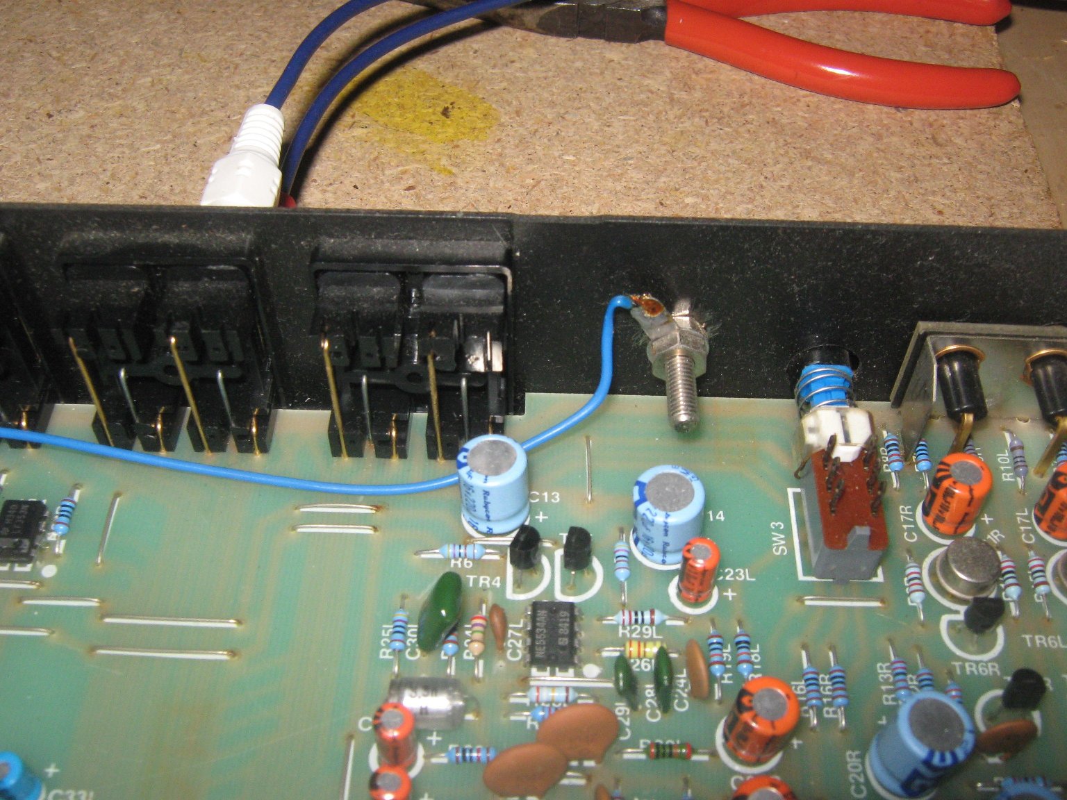

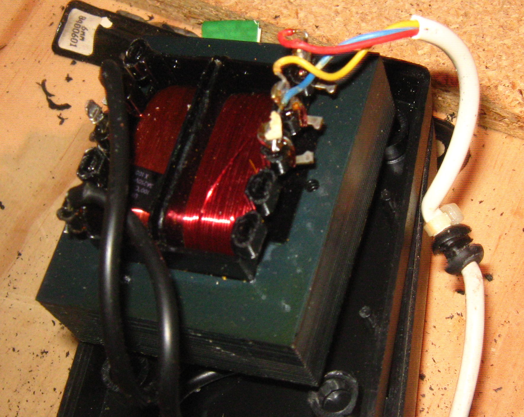

OK, some random fiddling and slight change in symptoms.
Turning the power brick over in my hands, seeking an attack vector, I noticed what appeared to be a movement of a weight inside. I would not be surprised if it turned out to be the alien larva that secretes the magic smoke stirring in repose, or perhaps a loosely mounted small transformer. Pure conjecture, of course. Deciding to pursue the loose transformer theory, I runned the power strip upside down and pressed it down on the power brick, which lay on its back with the plug pins pointing up. I then did the measurements over.
0V 15V 15V wires:
200 ACV:
Yellow to LHS '15V' +15.2V
Yellow to RHS '15V' +15.2V
20 DCV:
Yellow to LHS '15V' -0.14V approx
Yellow to RHS '15V' -0.14V approx
NE5534AN" and "S 8419" Opamps :
20 DCV range, for both opamps - there is some unsteadiness, perhaps due to my trembling hand:
Pin 4: -14.1V <> -14.2V
Pin 8 +11.8V <> +11.9V (LHS seems slightly higher)

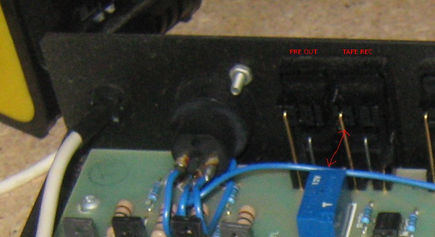

While moving power strip and brick into position, the pre (with nothing else connected) sometimes makes a gentle but disturbing 'tick' sound, perhaps as bits jostle for position inside the brick. However, once everything does settle, the pre is silent.
Interestingly enough.....the left channel on the pre now seems to work. The right channel is still silent. Except......
Both left and right 'pre-out' channels give the standard horrible 'missing earth' shout through the speakers, if the pre-to-power
plugs are re-arranged by someone too lazy to switch off the power amp. If the RHS pre-out is connected to the power amp, there is no sound...except...if I touch the multimeter probe to one of the copper bars in the pre-out internal chassis-mount assembly AND the one of the copper bars in the adjacent 'tape-rec' internal chassis-mount assembly, then I get a faint musical signal through the speaker. This signal does not seem to be affected by the volume control.
I tried to show this bridging with a red line....please ignore the blue wire which refuses to move. I'm guessing the bridge is Pre-out's Right channel
hot to Tape-rec left channel hot. Just a guess, though.
So...does this support your theory that the power brick is unwell? I'm scared to move it....

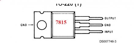

Is it safe to hypothesize that I could benefit from a new 15 - 0 - 15 ACV brick? Is there anything special I should look out for in seeking a replacement?
Or is there still a concern that there should be a -15V somewhere? (I interpret your earlier comments to mean that this would be only if the brick was supplying DC)
I have the idea that the 'missing channel' problem is why I stopped using the pre, long ago. Will I need access to the bottom of the PCB to fix this? I suspect there's no happy ending here, if that's the case.

Without moving the brick, I then got these measurements for the 8-legged crawlies:

The terms REG1 and REG2 are printed on the PCB, near these 2 chips.
REG1 is closer to, and parallel to, the back panel:
7815
UC8420
KOREA
REG2 is closer to, and perpendicular to, the front panel:
7915
UC8419
KOREA

The 7815 and 7915 are standard voltage regulators and I would have expected the NE5534 etc to run on the full output of these which should be very very close to the stated 15 volts.
This is what I'm thinking...... the PSU is faulty, particularly as you say something is loose. Are the voltage readings really a good indication of what is going on... by that I mean that a definitive check would now involve the use of an oscilloscope to see if the DC voltages are "clean". Could the loose part in the PSU be a reservoir cap ? That could give all sorts of misleading info.

I have completed my desecration of a British audio sacred site by opening the brick. It seems the 3 retaining screws were covered by plugs of some sort of plastic formulated from Mr Bowers' hatred of me. Anyway, inside we seem to have a transformer and another component - could it be a fuse? I don't see anything else electronic inside, other than wires.
BELOW:
Looking at the bottom (the side closest to the power pins), it seems a plastic post or pin of some sort broke off (it was lying inside the case).
I don't know if this is an old injury, or was caused by my fiddling. I hope it's not an issue.
BELOW:
Looking at the top, on the side that receives live AC from the wall (the primary side?) , it seems there is a component with some alphanumerics on the side "UM1" or "UM1" "100 degrees C" and "3A 250V" (it looks like it might be "3A 250V ~" - perhaps that little squiggle is an AC symbol) and "X100"
BELOW:
This I assume is the secondary side, with the 2 wires Red, Blue and Yellow that connect to the pre.
Do these pictures speak to you? Other than saying "I wish he'd get a better camera and learn how to use it"
I took a deep breath and plugged the open transformer into my power strip and measured it. The primary has 228V between the 2 wires (on 750ACV range). The secondary wires have a little over 15V (200 ACV range) which seems encouraging. The 15-0-15 PCB
points seem to be giving me 24V(Yellow to Blue) and 31V (Red to Blue). This seems a bit odd, have never seen this before....it's late and I am nervous about that open trafo, so I don't trust my measurements - will put away the grown-up toys for now.

So it really is AC coming from the brick. There must be a diode bridge unsighted in all the other pictures of the main unit. That's one thing that has kept puzzling me. The other component is a thermal fuse to protect against overheating. Sounds like 100C and 3 amp rating
Its normal for secondary voltages from a small transformer to be a lot higher when unloaded.
Anyhow, we have to measure the exact voltages on all 6 legs of those regulators, the 78 and 7915. Measure from ground (negative meter lead on ground for all). Notice how the pinouts are different for the negative 7915.
Expected readings would be plus 15 volts and negative 15 volts respectively for the 7815 and 7915. The inputs voltage should be at least 19 volts or higher (all DC). The ground pin should be at zero volts but measure it to confirm.

I did notice this stain at the base of one of the 4 biggest capacitors - it's the one closest to the power switch.
Could this be enough to cause all the problems? Or at least, is this something that will have to be fixed before it is worthwhile to continue testing?
Also, when you mentioned the words 'diode bridge', I thought of these things.
There are 3 of these little black cylinders with the silver collar. They are labelled D1, D2 and D3 on the board.
There is also a hockey puck-shaped thing labelled BR1. They are all very close to the power switch , the 4 biggest caps, and the '0V 15V 15V' landing. I tried to indicate D1 D2 and D3 with red lines.
So...regarding the possible cap leak - Do 'we' need an operation?

Your last picture does indeed show the "missing" diodes and bridge rectifier I mentioned earlier.
So it sounds like you have some breaks on the wires from the tranny... that's an easy fix... new wire. Or you could try shortening it, the breaks are probably where it is stressed at those cable grommets.
The cap may or may not be a problem. Hard to say just from the picture. Sometimes they have glue put on them on them to help with mechanical stability.
Fix the wire first, then we can see what is happening.
