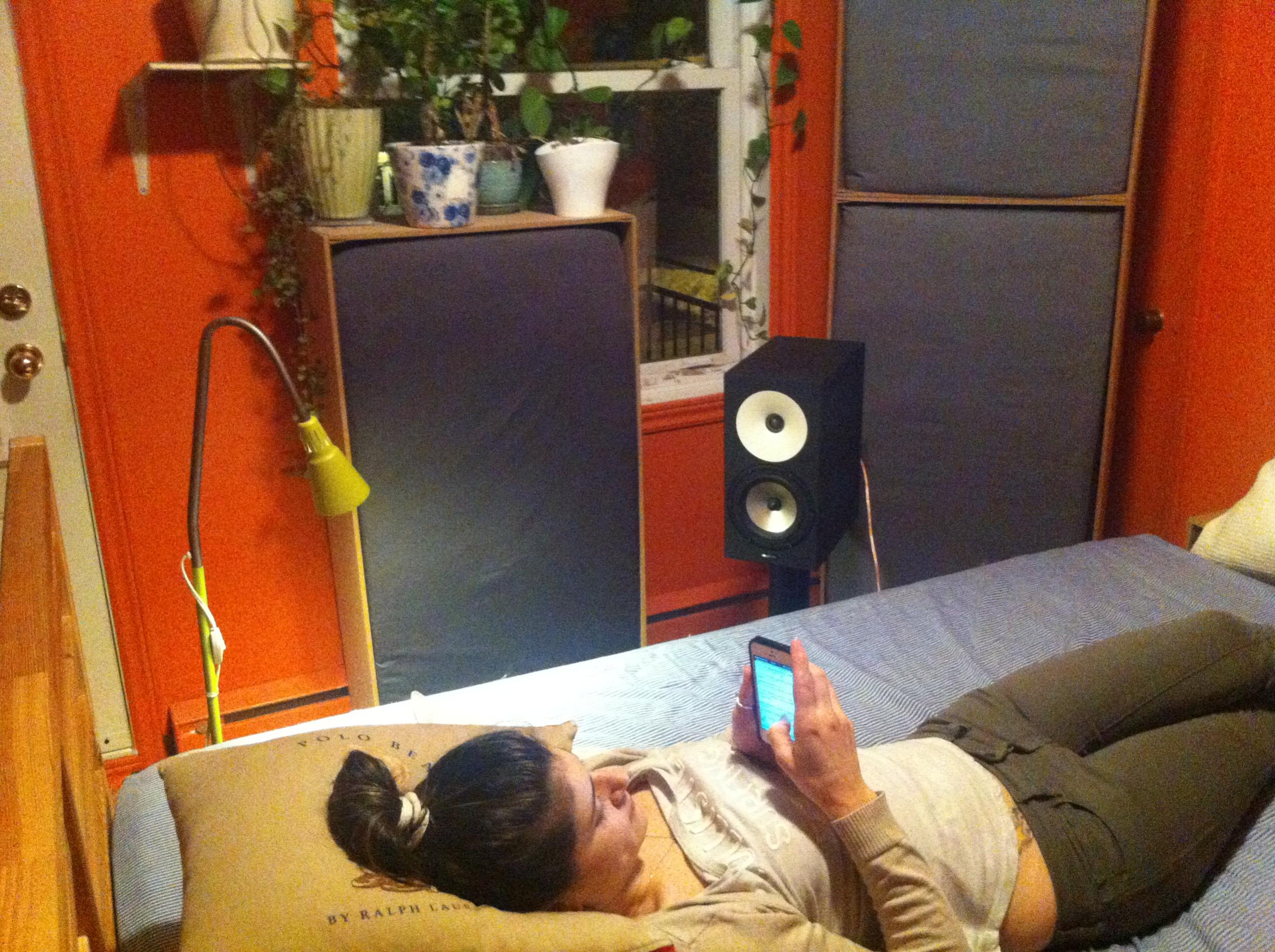

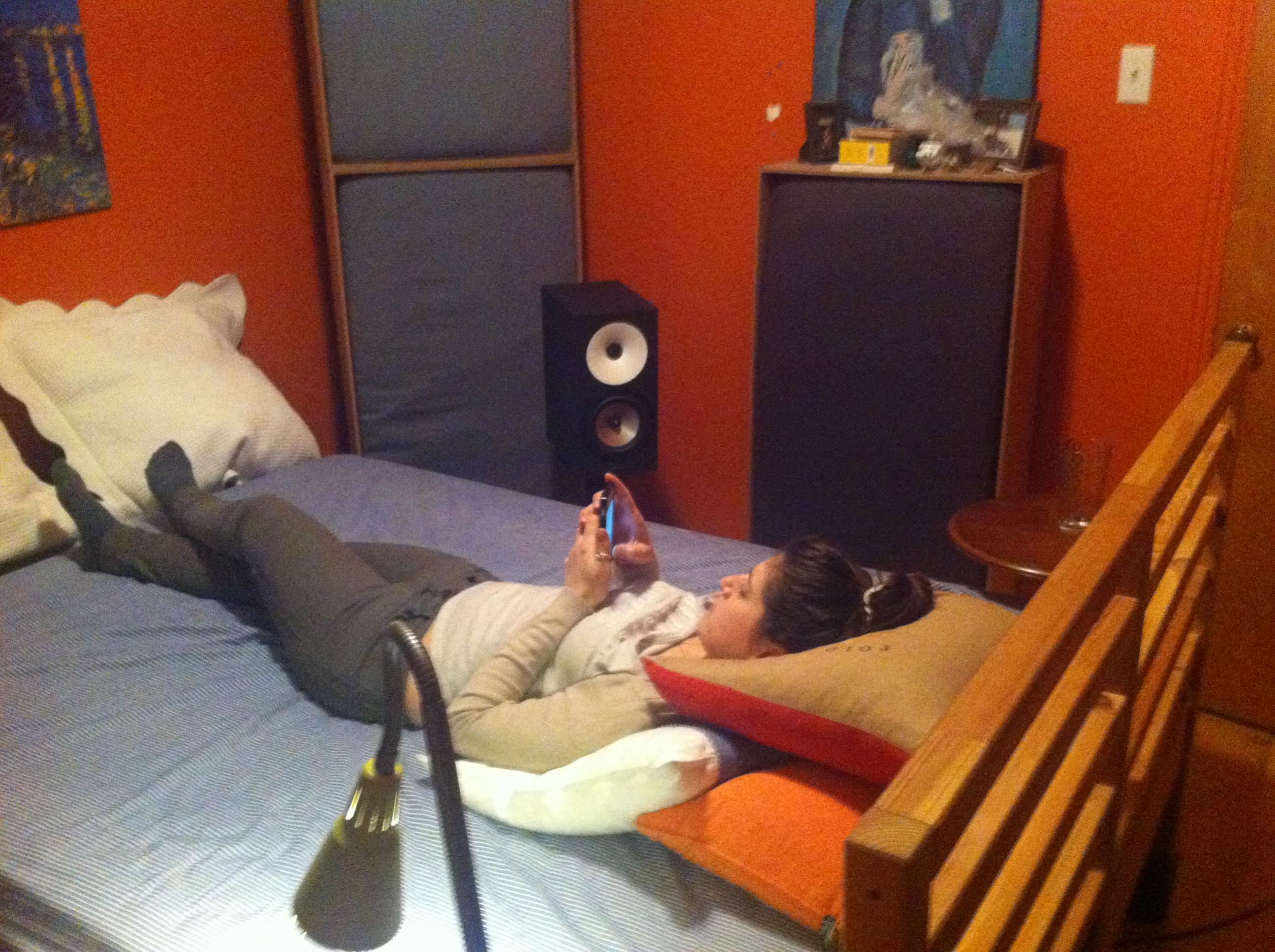

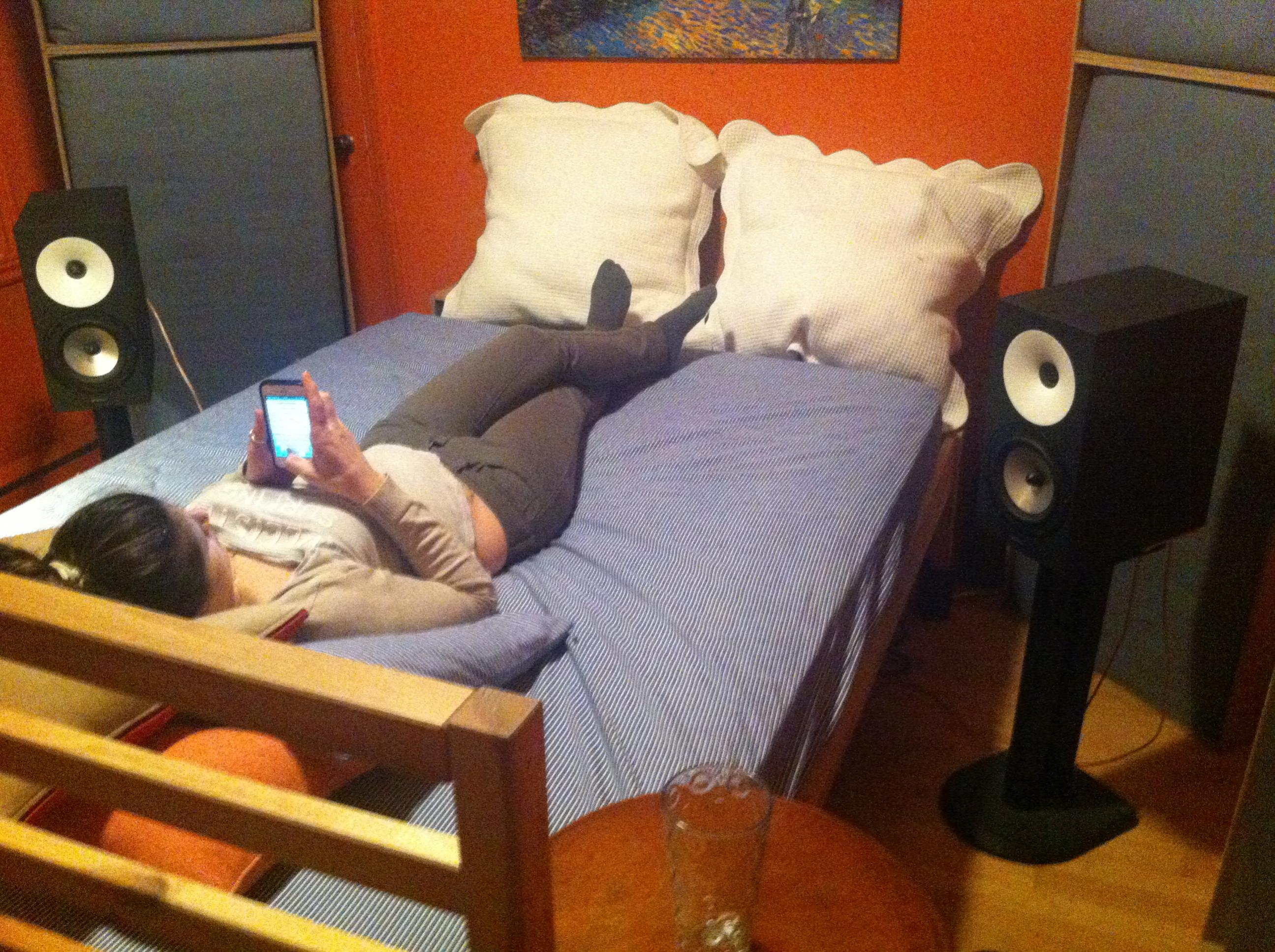

I have been trying it in my system and quite shocked by the instrument seperation it provides, the details in HF is greatly increased and total holographic soundstage, even the bass is more tight.
I have tested on me, a friend and my GF, we all three much prefer the setup 4 feet away from LP and the speakers 6 feet apart compared the ordinary way ( 6 feet away from LP and speakers 6 feet apart)...
Ive attached the two setups (the normal way) VS the Joachim way (when my GF is in the picture)

ok, ive just finished setup with your exact ration 2.85/2
People really should try.
Ill be listening for a couple of weeks but so far, the sound is spacious, I still have a strong phantom center. the sounds weirdly sounds more coherent with more space between the sounds which allow for better understanding of the music.
It reminds me of headphones. I hear much more details in HF. I really like it!
I've had a similar set up for a while. It works very well however it is far better with broadband absorption on sides and rear wall which allow the speakers to completely disappear. The sound stage becomes precise and enormous. Proximity to the rear wall can be a problem unless you absorb the reflection. It's too close for diffusion. This is with woofer with waveguide tweeter speaker set up also.
definitely, I use side walls boradband absoprtion and on the back wall as well. when my GF was listneing, as I rearranged the side wall reflection, she commented right away how better the sound was once I placed accordingle the side wall panels.
Im VERY impressed right now by this unorthodox placement.It creates a bubble of sound and its just much more enjoyable.

So many people repeat the equilateral triangle mantra its starts to be believed as the only way when it's just part of the necessary compromises in fitting speakers into a domestic environment. But using a bed as room treatment is a tad extreme 🙂
Given you are talking nearfield listening that seems to match the way a number of recording studio designs are done (which are also generally nearfield even for the big soffit mounted ear killers).
hehe, no the bed is not for room treatment, its just so nice to enjoy music laying down! its a bonus that it helps for floor reflection.
yes, it seems that as default, people respect the equilateral triangle as if its the only right way.
I must admit its the first time i try a unorthodox speaker placement and im very impressed.
