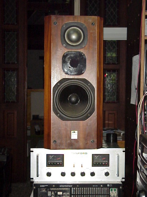

Got an old pair of Jmlab 703 Opium speakers.
I hope someone over here knows these old guys.
One tweeter and one mid are broken.
I haven’t the slightest idea where to find those speakers and if the 703’s are worth repairing.
A lot will depend on the price of course.

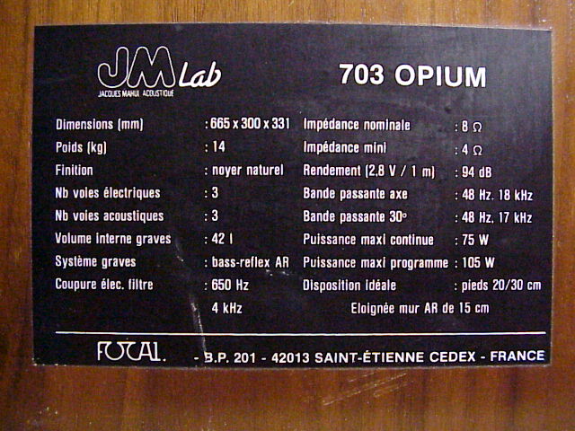

Thank you, that's exactly the same speaker.gary f said:The mid dome is a Seas 3'' dome.
Now, for your info, here's a picture of the backside label.
Could you possibly point out replacements for the Seas and the Focal?
/Hugo - not a speaker expert.
I think you could easily use the vifa D75MX-41-08, it's a 3'' dome, almost same sensitivity, fs, BL and Sd. Same rated power too. It cost 39.50 US$$. It is almost plug and play!
For the tweeter, I don't know the caracteristics of the Focal so it's a little risky. You could always buy any tweeter you like and fix the crossover by ear or with some measuring equipment.
Good luck!

Joined 2002
For your pleasure, and with an old Stanford 4 channel PA-amp 😎
Found a Focal tweeter who would fit mechanically.
Unfortunately I can't find any info on the old T101.
Should I take the risk?
