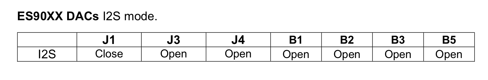

I have three questions, I couldn’t resolve reading through the setup pdf:

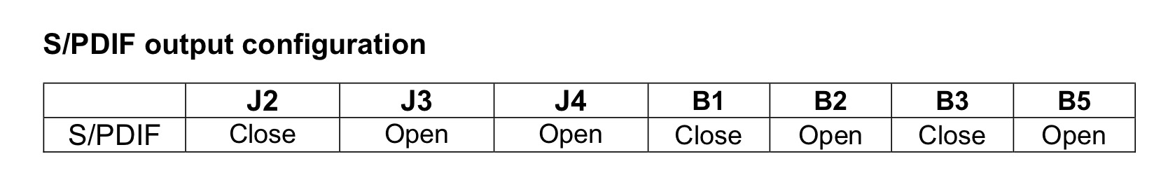

1) what would be the scheme to connect I2SoverUSB v. III board to an ES9038 DAC in I2S mode using internal clock (configuration: J1: closed, J2: ?, J3, J4, B1-B5: open, according to configuration table), in the pdf there’s no specific scheme for this type of DAC. I have GND/LRCLK/DATA/BCLK to connect (no MCLK since I am using internal)
2) when I configure it for ES90XX DAC in I2S mode, can I still use the S/PDIF output (for this B1 and B3 should be closed according to the table)?
3) I remember, I read that I2S and S/PDIF is active in parallel. The board shows up in LibreELEC (Linux Distro) as JLSounds Analog and JLSounds S/PDIF, two options. I guess I have to use Analog for I2S?

According to the config document B1-B5 should be open for ES90xx type DACs. See pic.I normally jumper B1, B2, and B3. That gives both 22/24MHz and 45/29MHz clocks, and I2S output format.

For S/PDIF B1 and B3 should be closed, see pic.

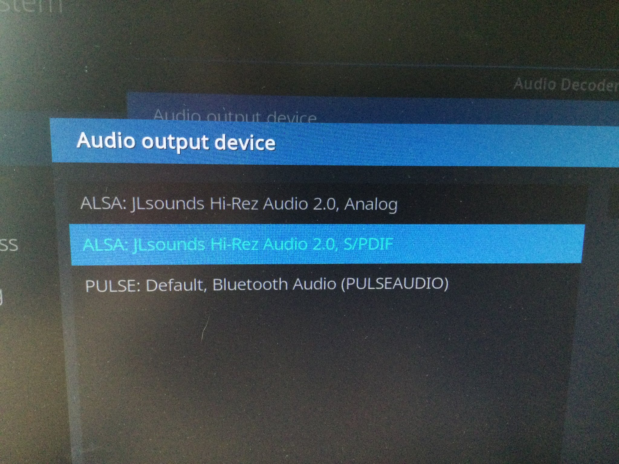

I don’t use Windows. I use a Rapi4 with LibreELEC. This reports the IF as two devices to chose from, an Analog and a S/PDIF device. See pic. From this it’s hard to tell which one does what and which one to chose and I didn’t find any info. Its a great product and the documentation has room for improvement…

JLSounds replied to my questions:
In order to operate I2SoverUSB with a ES90xx you have to:
If you use a Linux host (like LibreELEC), you’ll see two IF to chose from, the IF to select is:
- J1 closed for I2S DSD channels correct, internal MCLK
- J2, B1, B3 closed for S/PDIF (J1 can left closed for parallel operation), internal MCLK
- with B5 closed I2SoverUSB expects MCLK at H3.3 (depending on H3.1 isolated or H1.4 non-isolated)
- JLSounds Analog for I2S - tbc.
- JLSounds S/PDIF for S/PDIF -tbc.
- Digital Line Level
- JLSOUNDS I2S over USB v. III - use with ES9038Q2M
