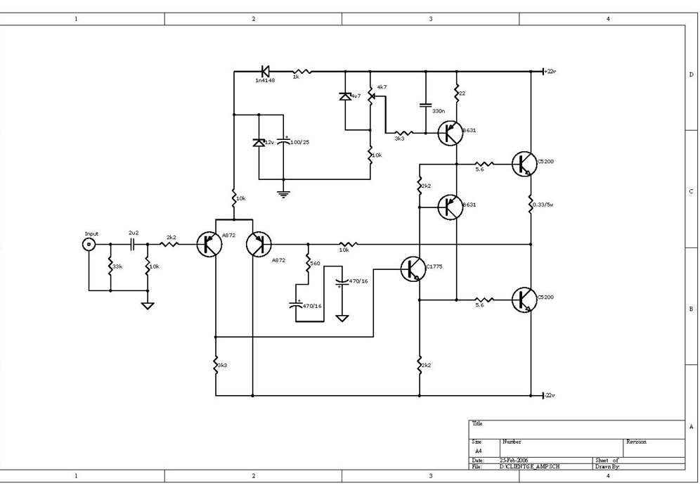

Has anyone modified the input stage of the JLH to a 'differential input' ? What was the result?

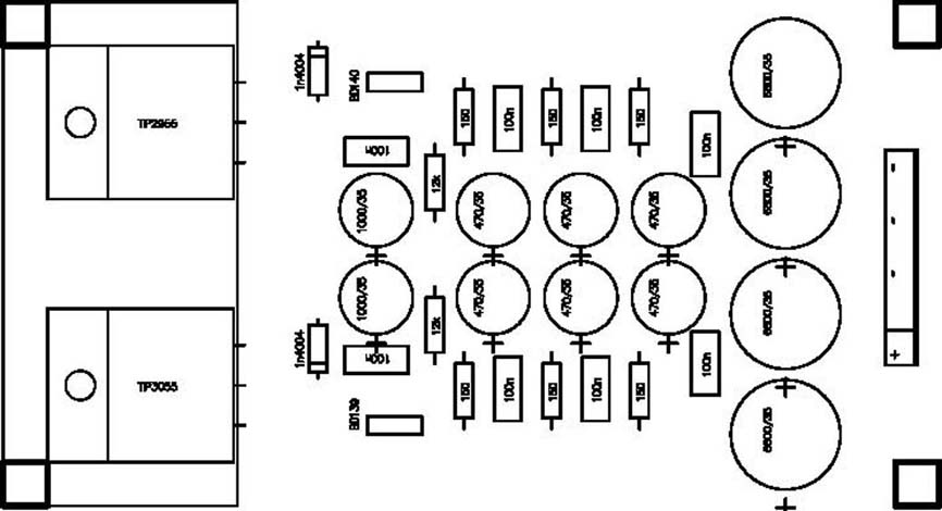

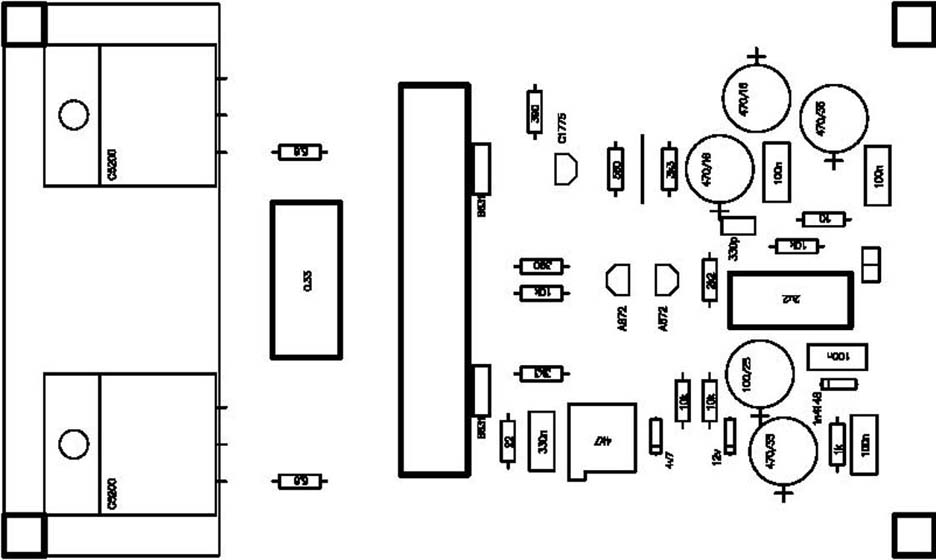

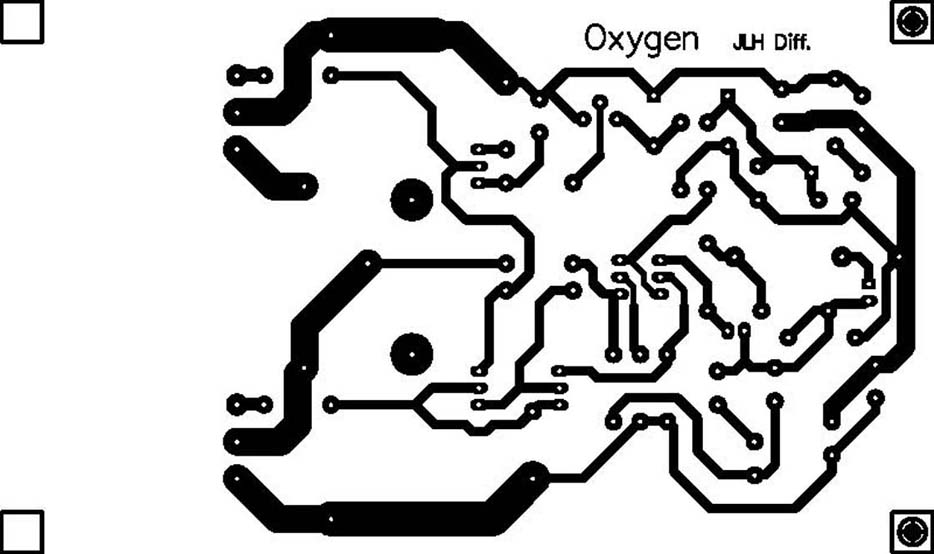

I have a few PCB layouts for the JLH and the power supply. I can send you the images if you want it.

I understand it. There are so many topologies that provide good sound and one of the accepted input topology seems to be a differential input pair. Sadly I am a physician but have experience soldering and setting up amps (basic setups like bias Iq etc) so am unable to change the design and experiment.
The differential input change should be easy on the JLH amp. If someone has built it and it had sounded worse then I wouldn't want to do these changes. But i haven't seen one post telling that the differential input is sounding better or worser. That's what intrigues me.

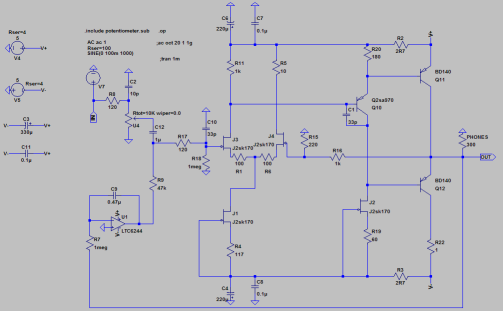

I know this is an old thread, but did anyone try this? How does it sound compared to single end input?
I was thinking of giving it a go in my headphone amp with JFET input. I think there's too much of low order harmonics giving it a bit of a grainy and forward sound (not measured), and I was thinking a differential input would reduce this.
