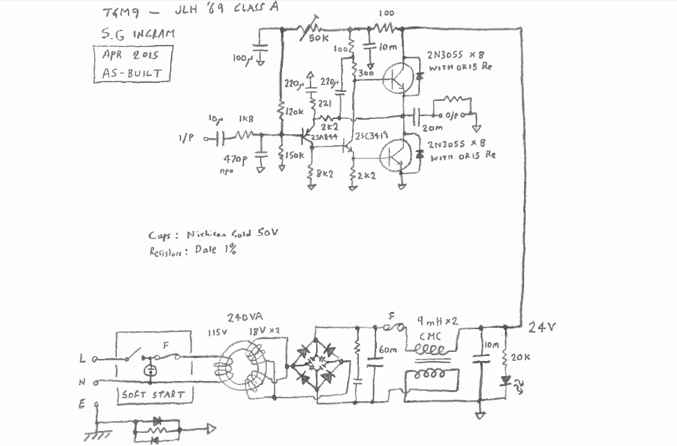

Working properly, the classA JLH is a very good amp. I built one as my first ever hifi amp and had the issue you did, basically, as mentioned earlier, old transistors suffered from bi-polar gain droop and also low gain, some power transistors had a gain as low as five!. I would measure the gain of the devices first, if its low and I suspect it will be, then change to a more modern type, or if you are feeling very brave you can use the SiC design I posted a few days ago.
maybe parralell two 2n3055's will do the job
You can parallel devices, I used 16 of them for one channel. But you can't run in Class AB without changing the topology and even with parallel devices the sound is still ultimately limited by these old output devices. In my case the power devices were all riveted to heatsinks, pulled out of two old power supples but I have been tempted to drill them out and replace with something modern. Nevertheless, built as-is the design is a 'classic' and the sound no doubt close that which JLH enjoyed with the original.
http://www.diyaudio.com/forums/solid-state/268846-tgm9-my-version-jlh-69-class-amplifier.html

In the original 1969 version of JLH can I mod it to use N channel mosfet's ( i have some lying around )
While you could certainly 'get it to work', I think this is one amplifier where doing so would be sub optimal in pretty much all respects. They would not be a drop in replacement (whether laterals or HexFets) and would require alteration of several of the resistor values.
I wouldn't use FETs for another reason - the amplifier was designed around there being base current into the output devices. Nelson Pass did a FET version but it was never popular. The bipolar JLH on the other hand has been extremely popular.
For me, I would not add the 'shunt' thing either, you want it to be a JLH classic and operating in Class A - that's the whole point. If you want Class AB then build a different amp. Or look at Elvee's Circlophone, rich-biassed Class AB.
One change you could consider is to improve the PSRR with an RC filter in the power rail to the front end of the amplifier - see attached.
