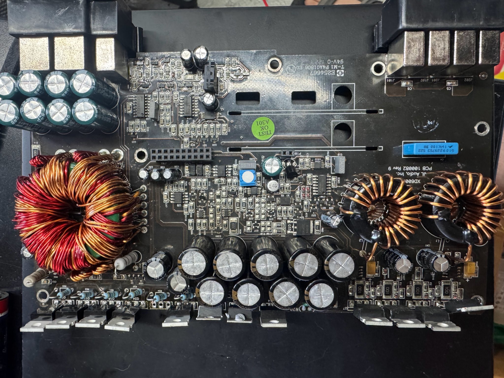

Photo: tomorrow or Friday, when I next have time to get down there. Typical JL construction: 6 FETs on right side with inductors for power stage, 4 FETs on left for output. Could be a spitting image of other single channel JL amps pictured here.
Drive circuit: not sure. Any thing to read to learn how to figure it out? Are you talking about like what kind of FET drivers they're using?
Drive circuit test: no, didn't test with a load prior to reinstalling PS FETs. Replaced all 4 drive FETs, didn't test drive circuit.
Of note: two surface mount resistors close to the 4 drive FETs were noticeably hotter than the rest of the circuitry in the area. 0805 size maybe?

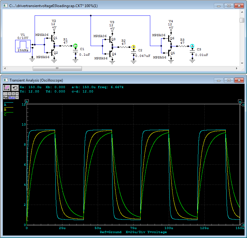

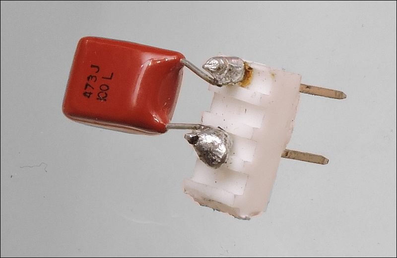

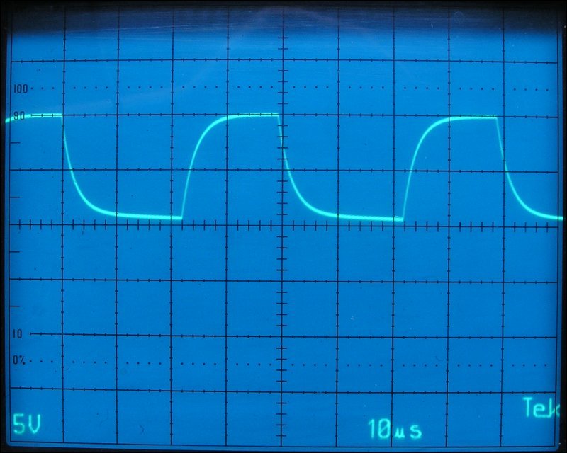

You should always check the drive circuit with a load. I use a 0.047uf cap (seen below). A 0.1uf to a 0.01uf works well for the power supply. The header is to make it more robust and easier to handle. The last image is what to expect with 47 ohm gate resistors and the loading caps mentioned.
The waveform without a load, even with a defective driver circuit, may look like a clean square wave but when loaded, it can' pull back to ground. The scope image below is what a loaded circuit will look like for a good drive circuit. If it's not good, the waveform won't go back to ground as is shown.

Ok... Pictures.
https://photos.app.goo.gl/hmbitetugAx1axap9
You can see the 5th FET from the left has been removed ... because it blew.
Did you check the drive circuit yet?
If you remove the PS FETs (to check the drive), check to see if any of the op-amps have supply voltage without them being in the circuit.
