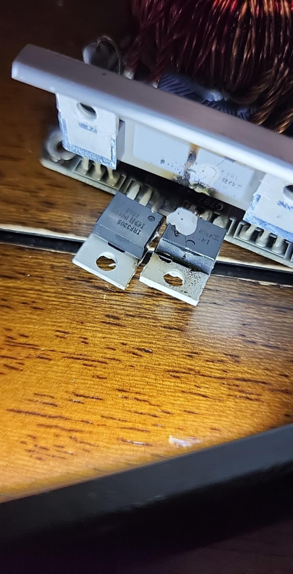

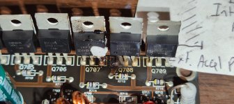

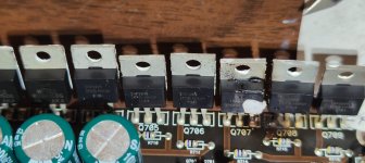

I return once again in need of help. My buddy reached out to me about his amp not working (power light not turning on). Quote " i was beating the crap out of it to be honest. But once i smelt a small amount of burning wires I cut all power and turned it on once since them. I had to tap it to come on.". Not sure what "it" is or where...he also sent me a picture of an exploded mosfet, Q707, IRF3205 (? based off the one next to it, not sure that is the correct number).
Now, i know blind part replacement is bad, but, if there are no other visibly damaged parts on the board, would it be a good place to start by replacing the exploded one, and maybe the two on either side of it and seeing if it works?

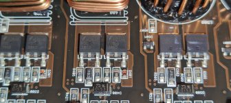

Check the output transistors (FDD3860s?). Is any single FET reading low resistance between any two terminals in any combination (1-2, 1-3, 2-3)?

I need to get my hands on the amp, once I do, I will report back. I assume if its reading low, theres a shorted output transistor and will require further back tracing to find all damaged parts?
