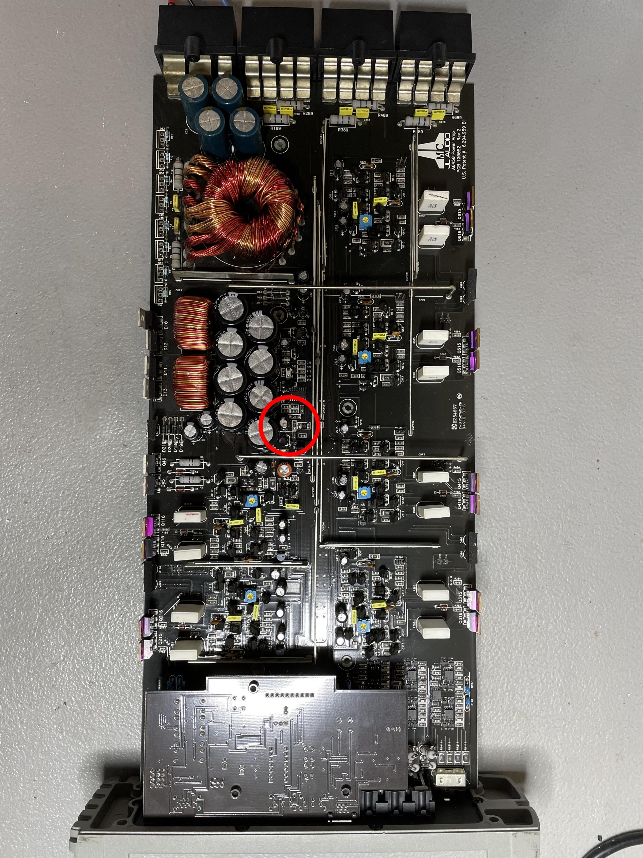

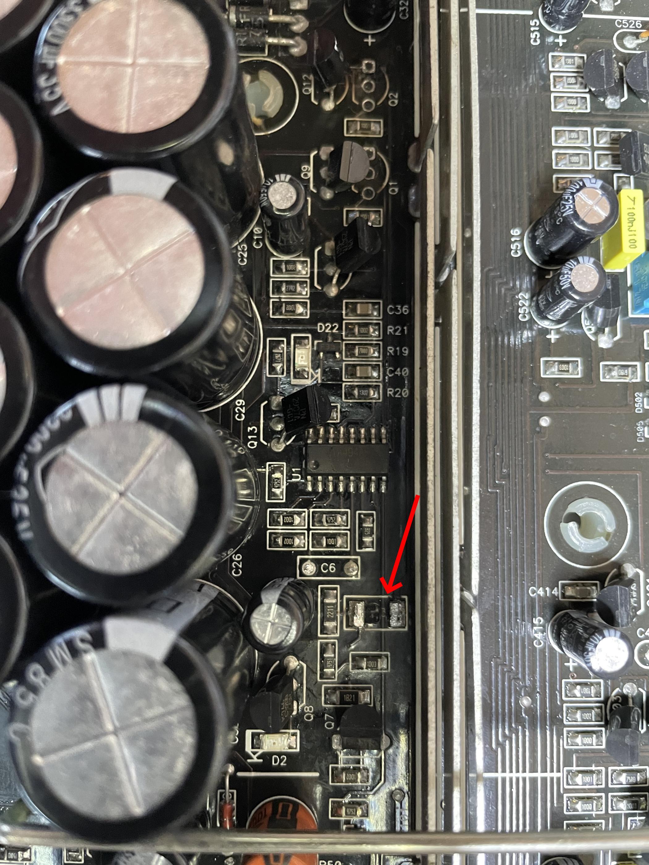

P peeby Member Joined 2020 2021-02-24 6:15 pm #1 2021-02-24 6:15 pm #1 Looking for the value of SMD resistor in the drive section of the PS. I believe it to be a 3/4 watt 2010 size SMD. I believe the non-marine version of the amp is the A6450. Thanks Attachments IMG-0416.jpg 731.1 KB · Views: 94 IMG-0415.jpg 908.9 KB · Views: 86 P Perry Babin Member Joined 2003 bcae1.com 2021-02-24 6:32 pm #2 2021-02-24 6:32 pm #2 If it supplies B+ to the collectors of the NPN power supply drivers, it's a 10 ohm. P peeby Member Joined 2020 2021-02-24 6:45 pm #3 2021-02-24 6:45 pm #3 Thanks Perry You must log in or register to reply here. Share: Facebook X (Twitter) LinkedIn Reddit Pinterest Tumblr WhatsApp Email Link
