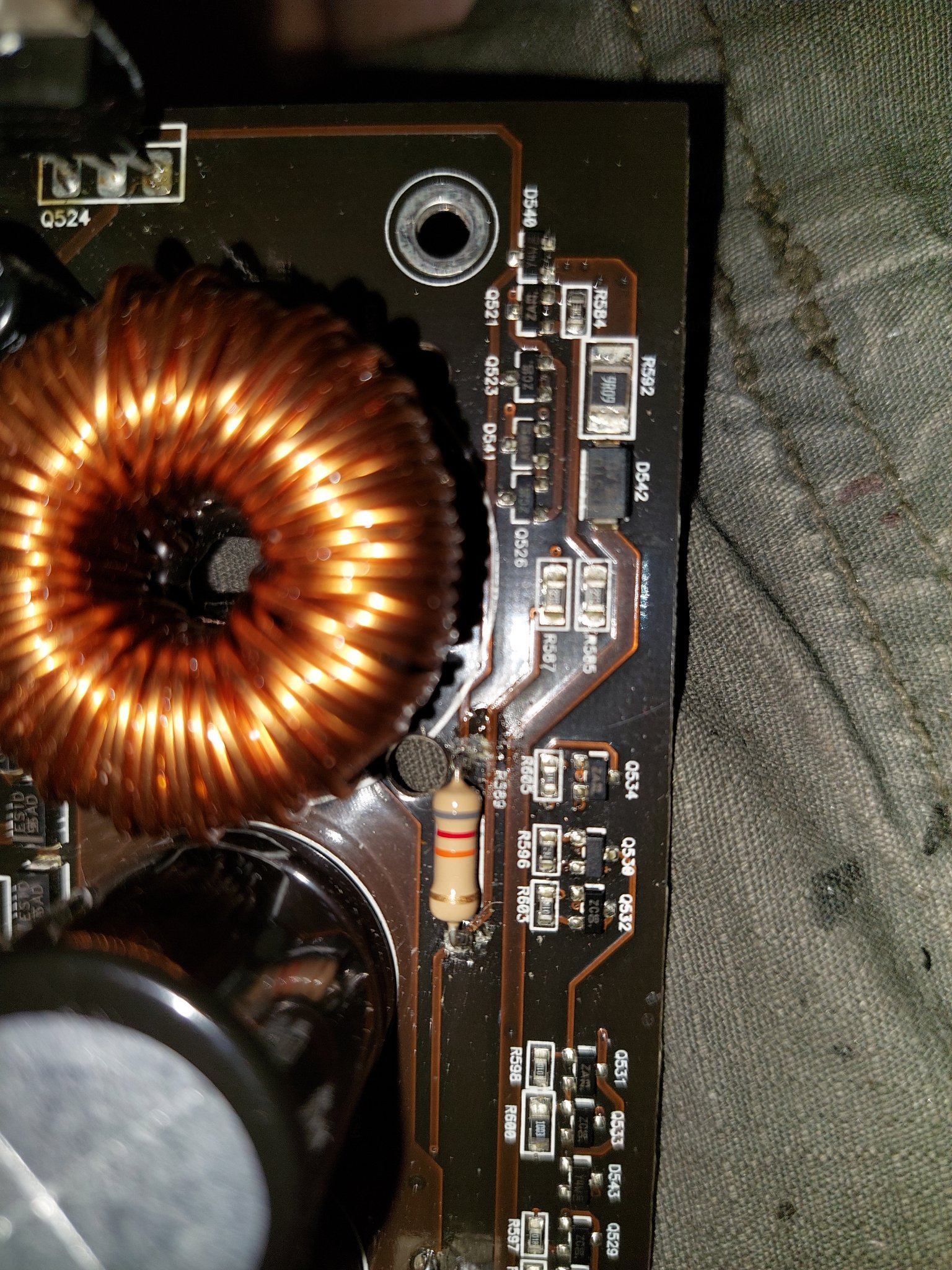

I have a hd750.1 with and few outputs shorted and the power supply torrid raised off the board. In a few of these I have found that the torrid had broken completely off repaied them and the amplifier worked. This one has a open or burnt resistor directly behind the torrid R592 I need the value of this resistor it's defaced so I can not make it out.

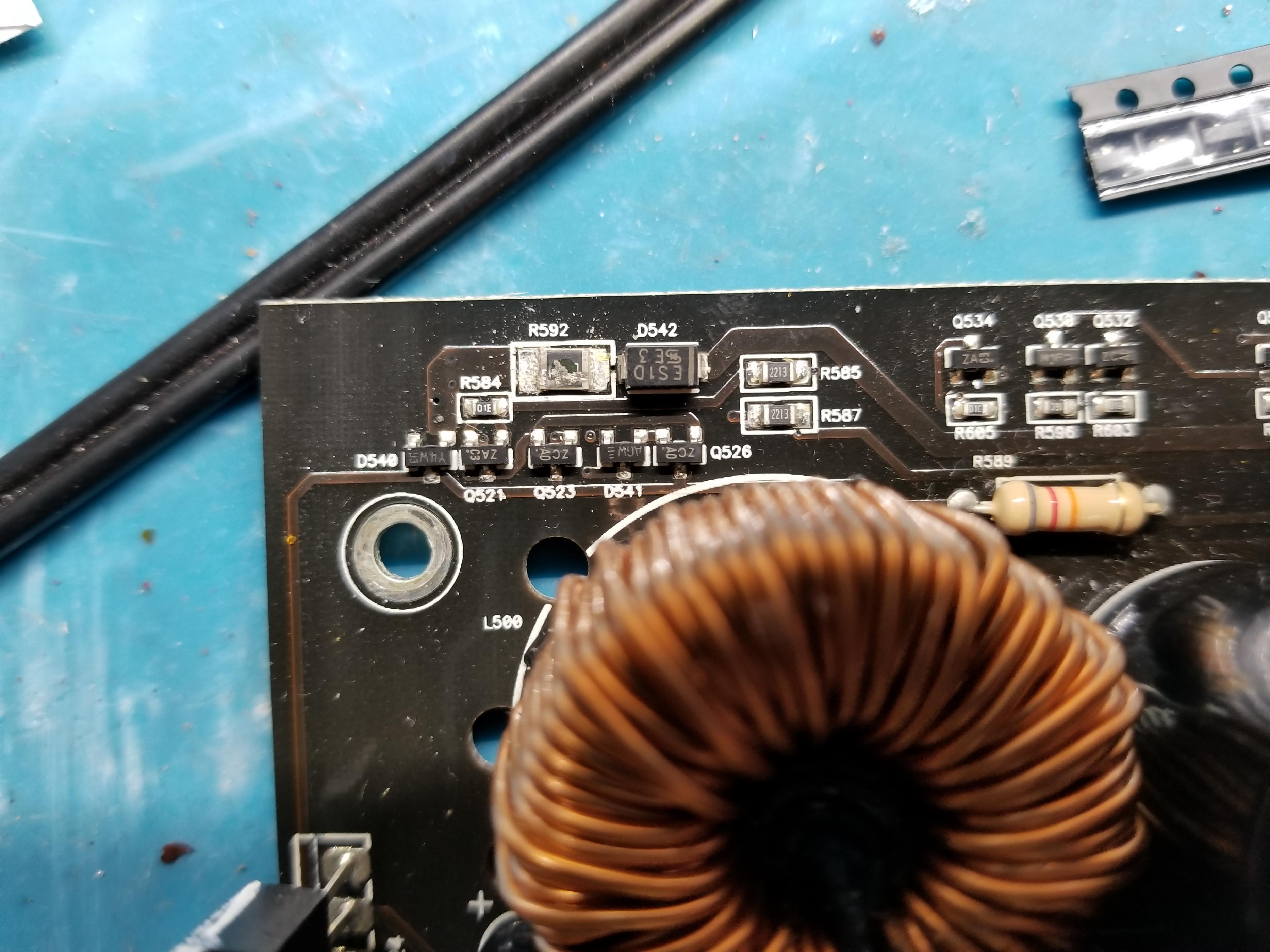

Not sure if anyone ever answered you but it's a 9.09 Ohm Resistor. See attached.
