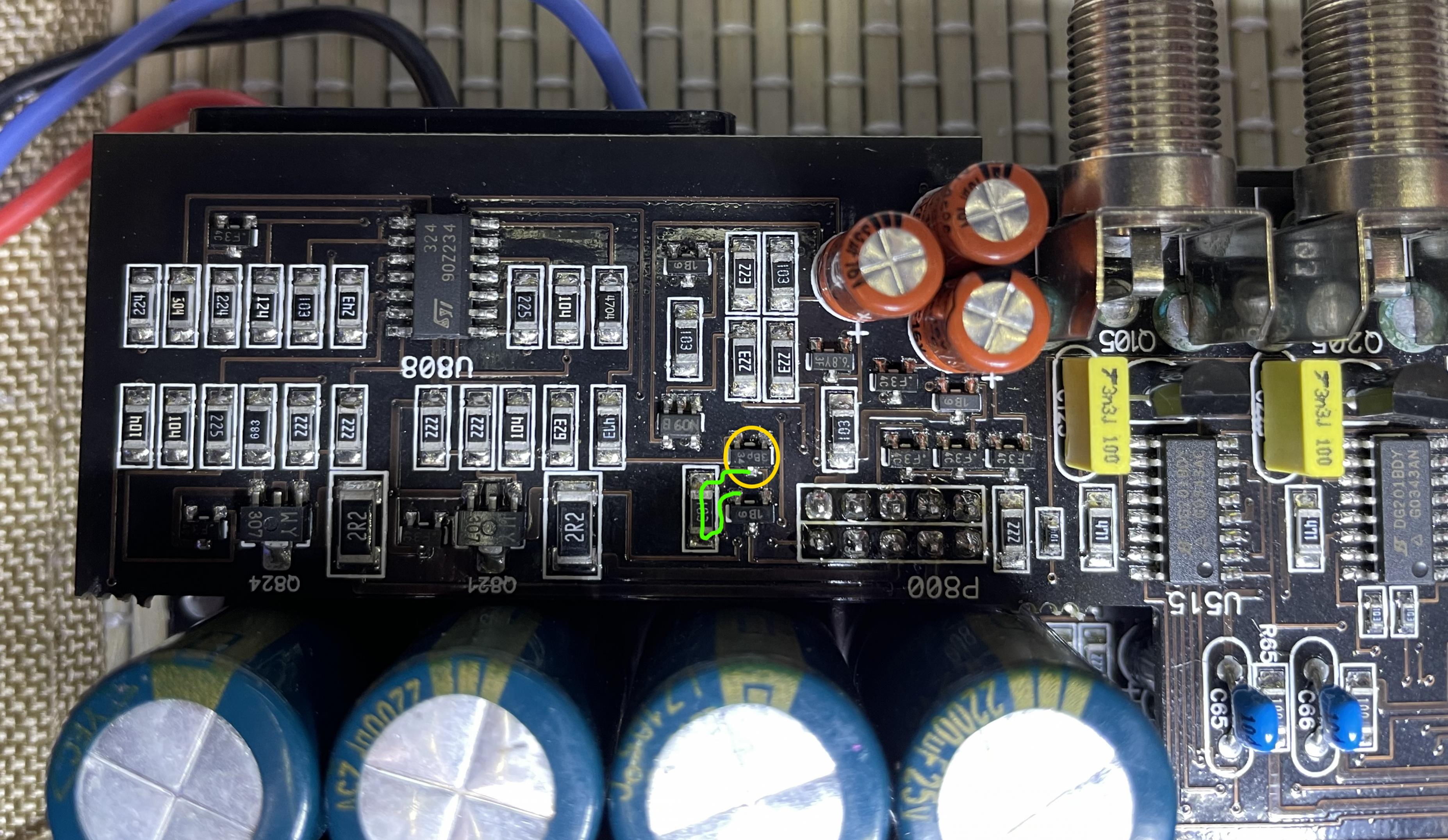

Replaced one channel of the AB outputs and got all 4 AB output boards running.
Amp remains in mute. There is no gate voltage to any of the 4 Jfet muting transistors - not sure yet where the muting is for the Class D sub channel.
If I remove jfet channel operates normally.
All voltages are correct on all 5 channels.
Trying to trace out where muting originates. Maybe on the preamp board close to the remote power on section?
Anyone have any knowledge of what/where the muting circuits are?

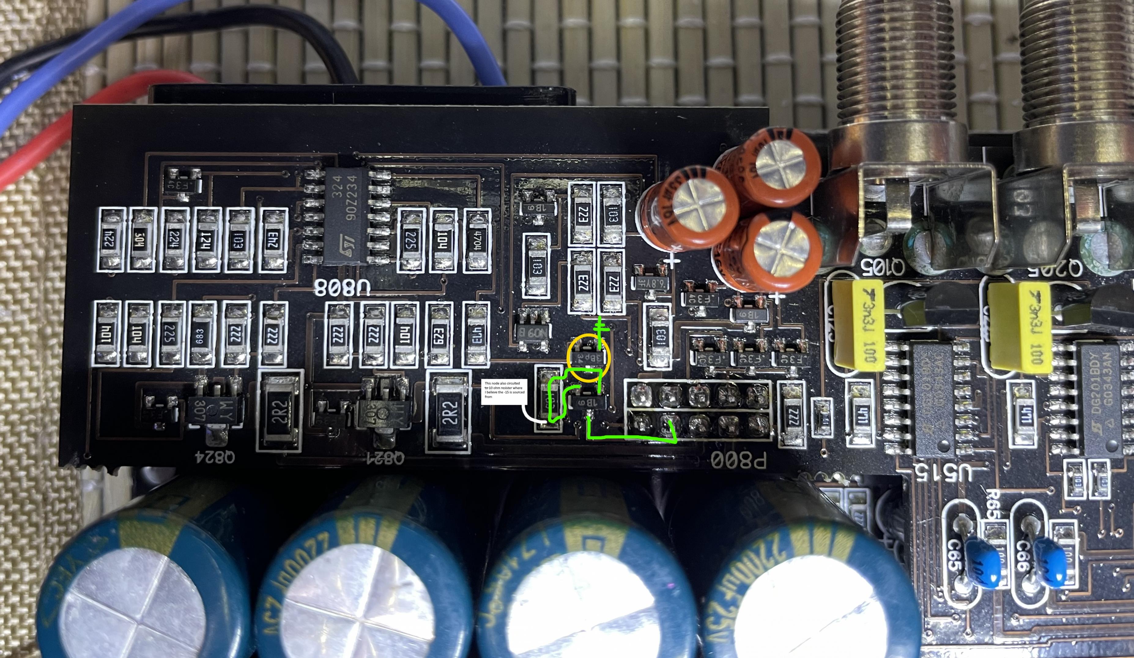

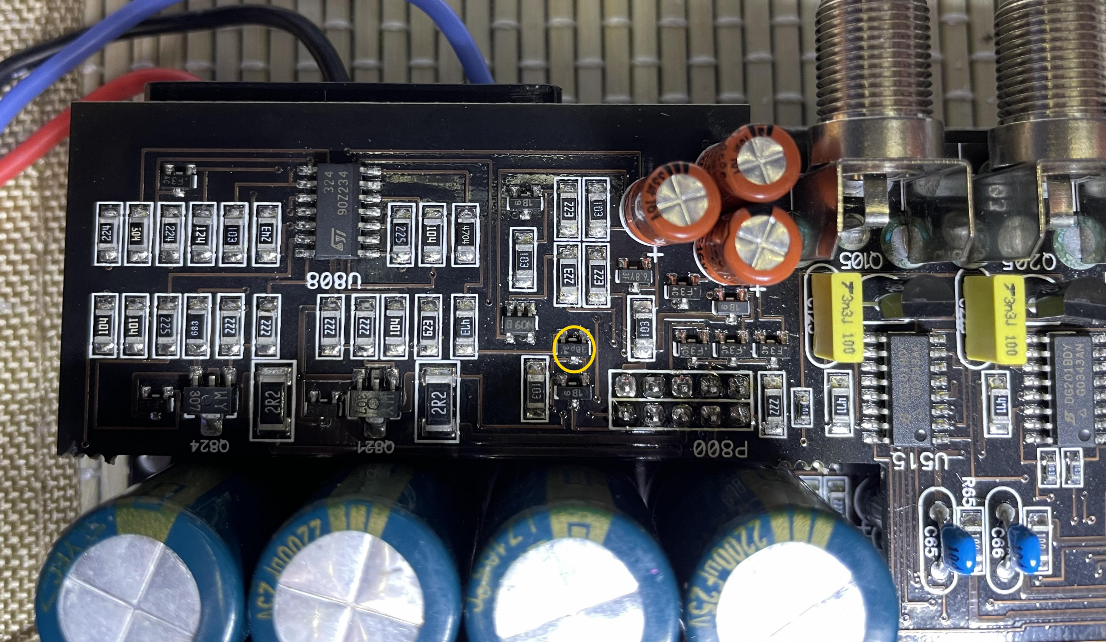

This is the only transistor I can find with grounded base.
