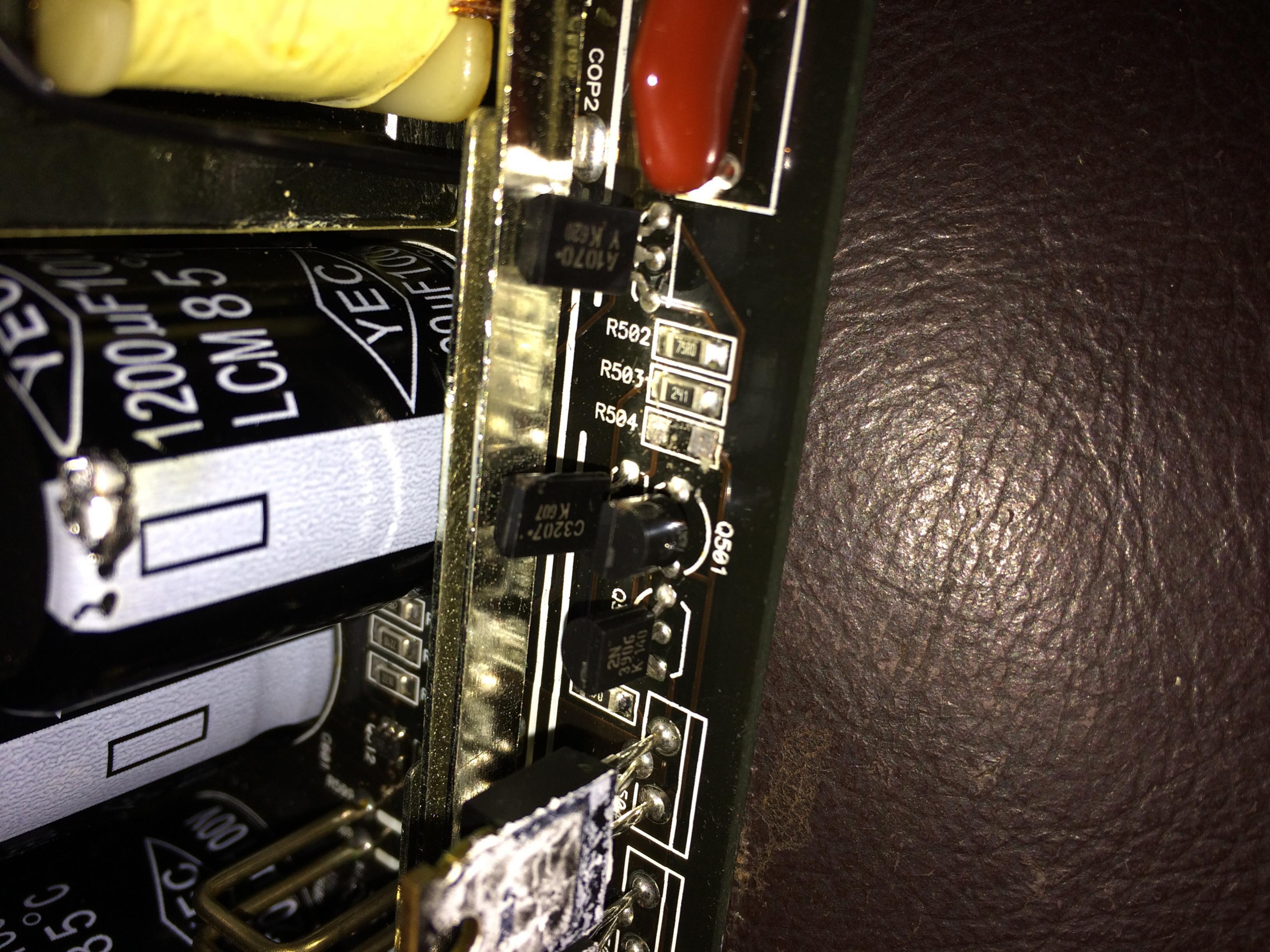

Ok I installed new power supply fets and gate resistors. I used IRF3205 with the 47 ohm resistors. The problem is the fets start to get hot as soon as I apply remote. Could it be R504 is missing? The outputs don't appear to be shorted.
Possibly. Pull all of the outputs, clean the solder from the pads and power up the amp. Does it power up and draw only about 1 amp?
I installed a 470 new smd resistor problem went away no more hot mosfets not even the outputs get warm. I put it back together and tested for audio it seems to play. I'm using my iPhone as a source to play music but when I touch my phone it makes a buzzing sound not like a high pitched sound like when you touch the rcas it makes that buz sound. But it still plays.
