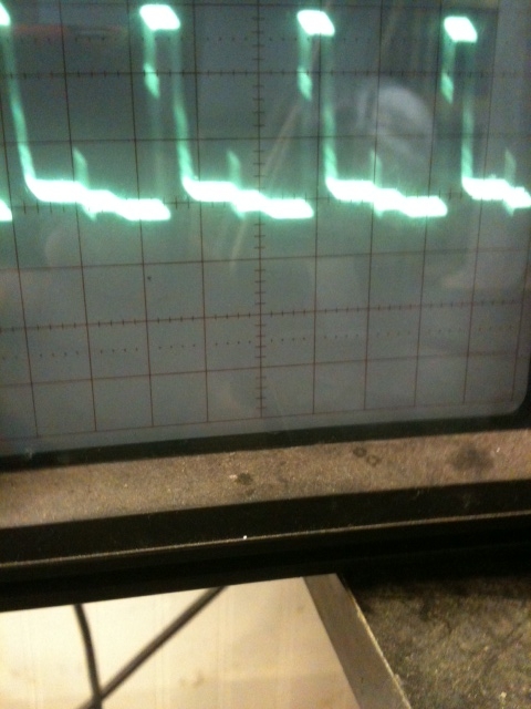

Replaced the Gate resistors , The drivers for the power supply fets and replaced the Power supply fets..
With just power and ground hooked up the amp will draw excessive current..
Any ideas on what to check?

Power supply fets are getting hot..
If the outputs are out of the amp the amp powers up and idle's perfectly..
If i put the outputs in the amp and only hook power and ground up NO REMOTE the amp will draw excessive current and the power supply fets and the outputs will get hot

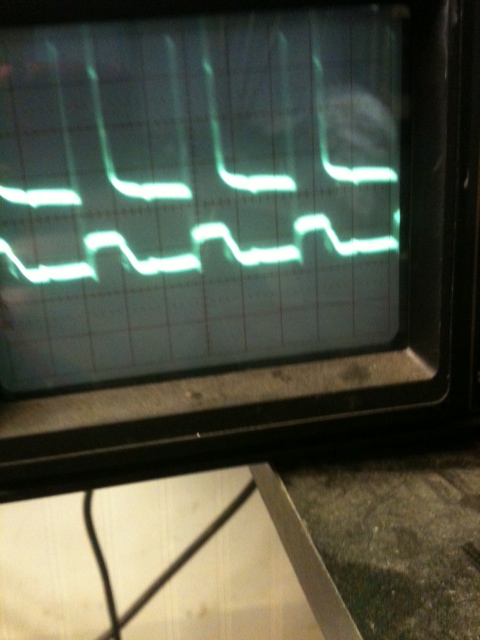

On Pin 14 i get a square wave but it is bouncing around the display on my scope.. Its a square wave but its not clean and not steady..
Pin 11 i get nothing that looks like a square wave at all It just line going everywhere

If i remove 2 outputs -- Q404 and Q407 the amp will not draw excessive current..
With the 2 outputs still in the amp If i hook just power and gound up the amp will still draw about 1 amp of current..

When you make/break the remote connection, does the power supply produce pulses and then stop producing pulses?
Do you get rail voltage when the amp is drawing 1 amp?

Yes

Yes i get 60 amps of rail voltage on the outputs with just power and ground hooked up

Confirm that all gate drive signals are identical then post a scope cap of the drive signal at the gate leg of one power supply FET.
Without the scope settings, it's difficult to tell. Please read the 'Best Initial Settings:' sections on the oscilloscope page of the site.
Try this, set the DC supply voltage lower. You want the drive to go to the full duty cycle. Does the current draw increase?
Is there anything i can stick in the B+ wire to drop the voltage since I cannot adjuust the voltage on the power supply?
A resistor but it's not a good choice because the voltage drop will depend on the current draw.
