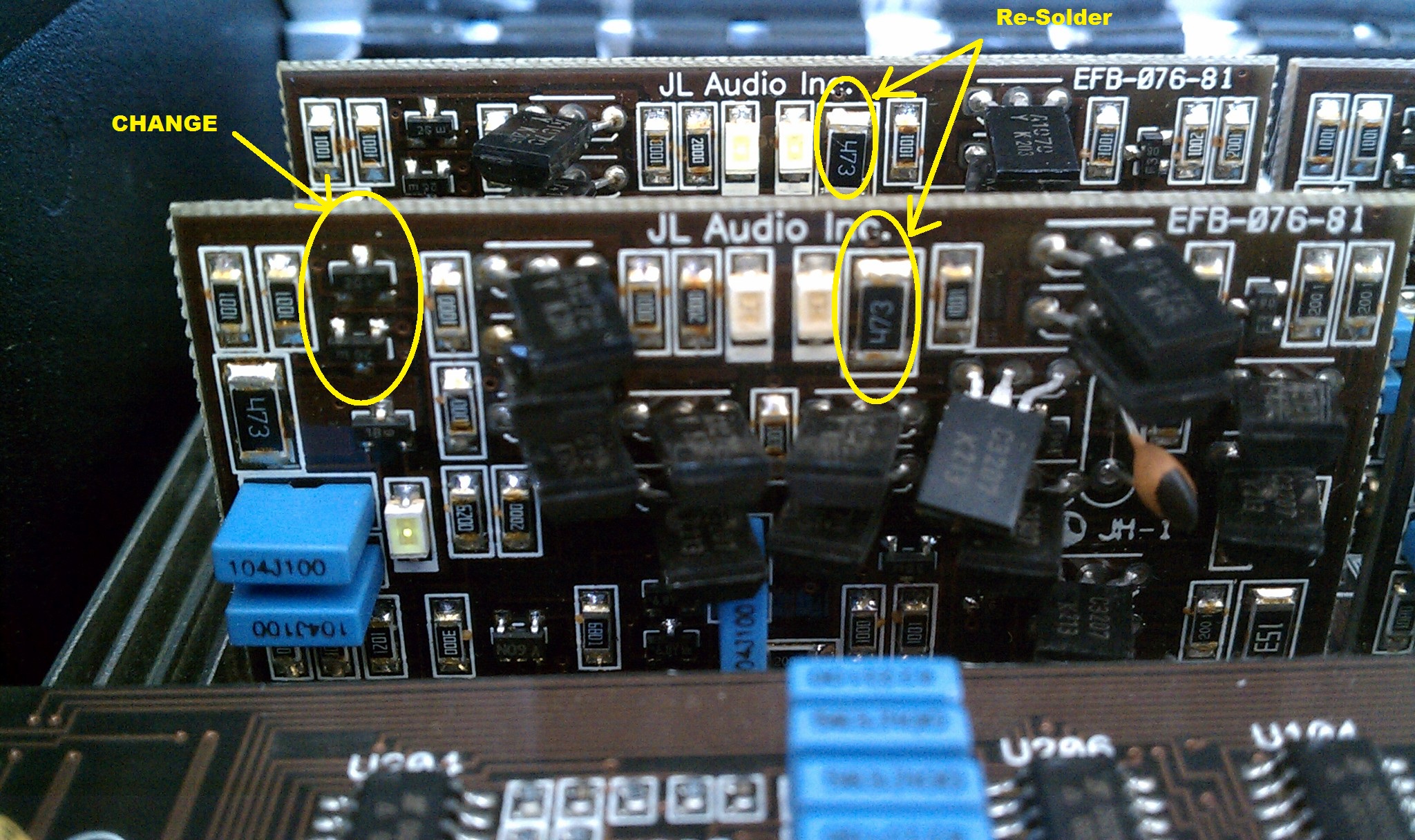

If all of the LEDs are lit on the driver board, the problem is likely the two differential amplifier transistors on the top-left corner of the board. There is also a 620 ohm resistor that often burns when those transistors fail.
Are you talking about this (also took notes on the 473 resistor from other thread) (notes on picture)

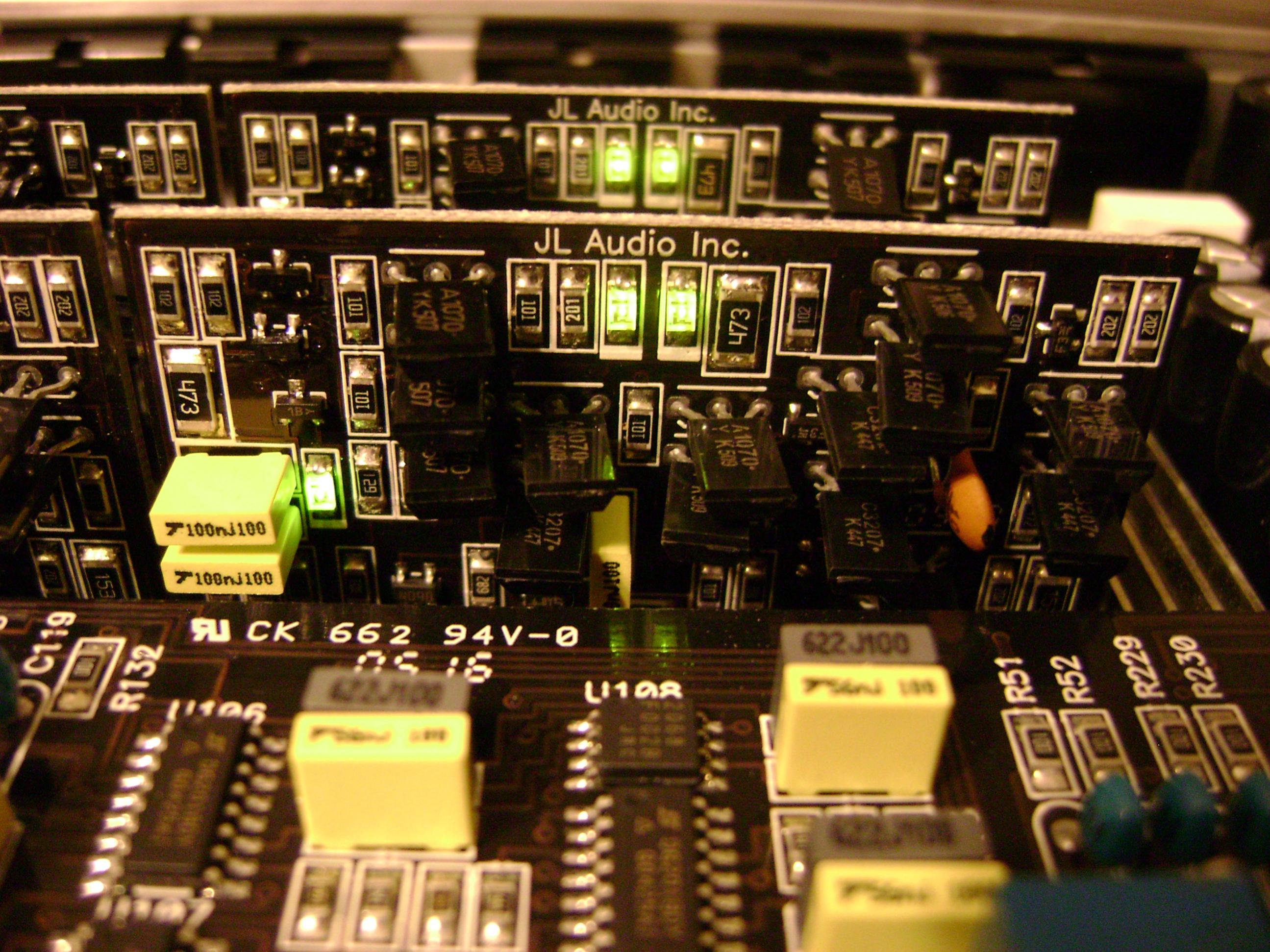

The 2 top lights in the defective channel board are not lighting up...

OK (again 😀 ) I just read in other posts, that the 2 top-left transistors are BC850C's I noted that one had different voltages than the other 3 boards. I removed it and now all the lights turn ON and the amp is no longer demanding a lot of current...

It was the "B" little transistor in Perry's diagram, that was it. Fired it up and it runs like a champ, channels seem like they are the same level all and it sounds clean and crisp!

Here's a Pic with all the lights on and the amp running 🙂
