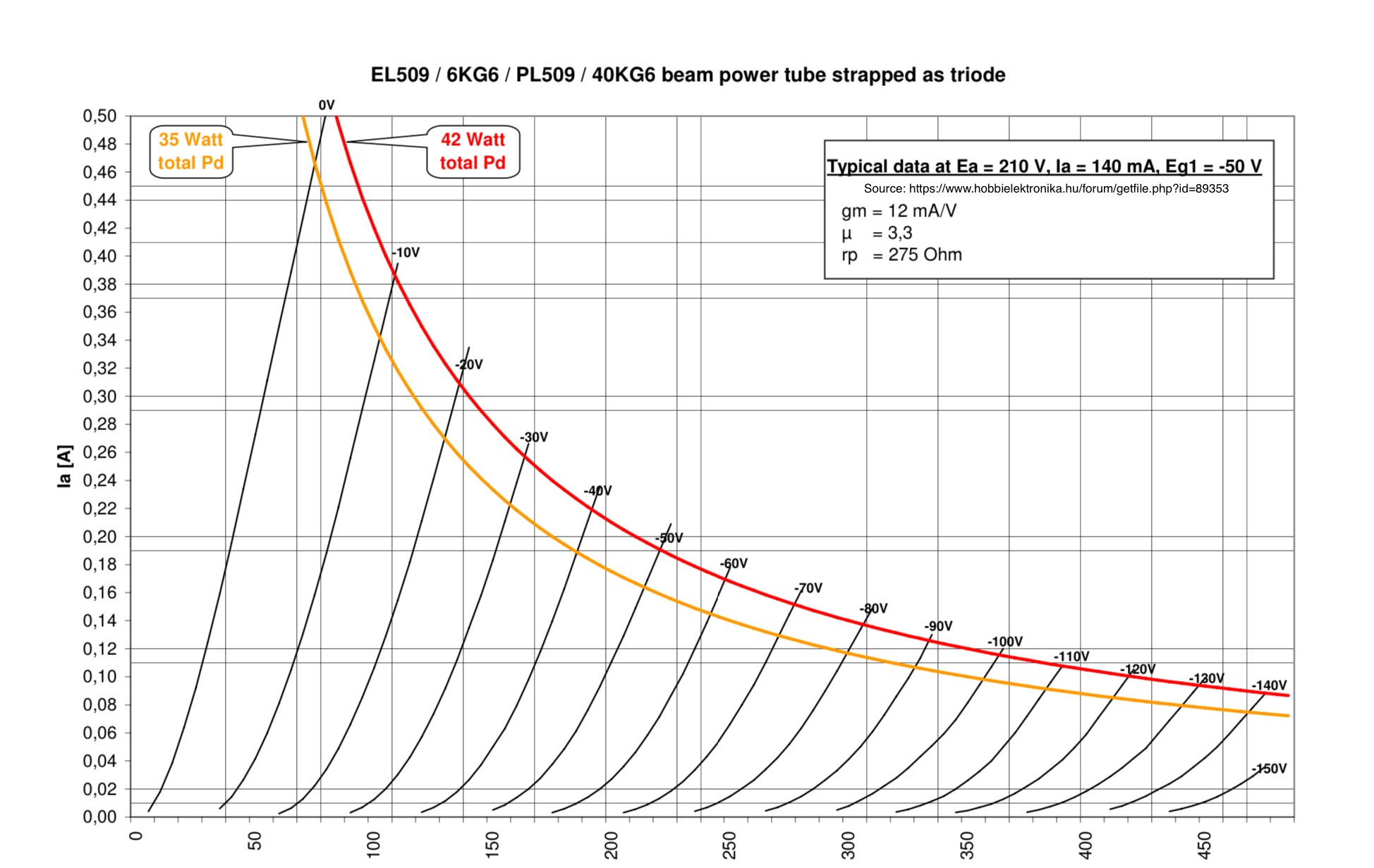

It's a bit of an odd duck. The data sheet looks more like a KT88 than a real EL509/6KG6. You'll need a lot more grid voltage compared to a KT88, but you don't need to worry about the screen voltage rating @700V. A real EL509/6KG6 screen is rated at only 300V.

Web links have a nasty habit of going away so I’m posting those curves here (with acknowledgement of the source added).
check:
The triode curves at 160V plate voltage and Vg -30V gives approx 240mA of current,
The JJ data sheet Transfer Characteristics at 160V on plate and g2 with Vg -30V gives approx 200mA (plate) + 40mA (g2) = 240mA

Those curves are from the original TV sweep tube EL509 / PL509.
The octal JJ - EL509 might be quite different.
