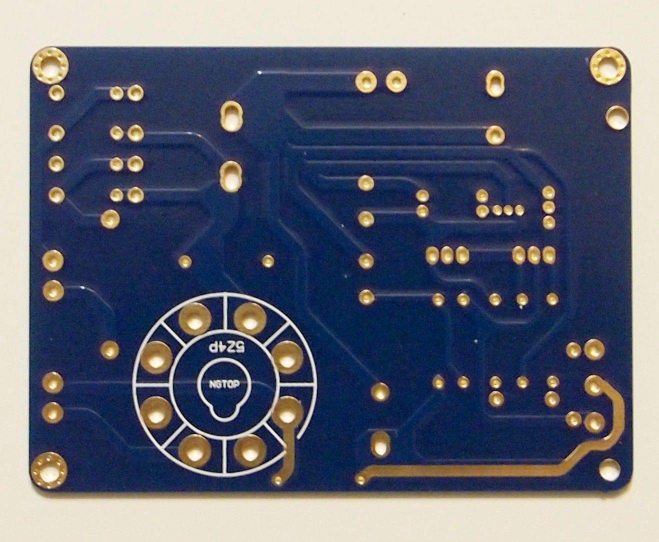

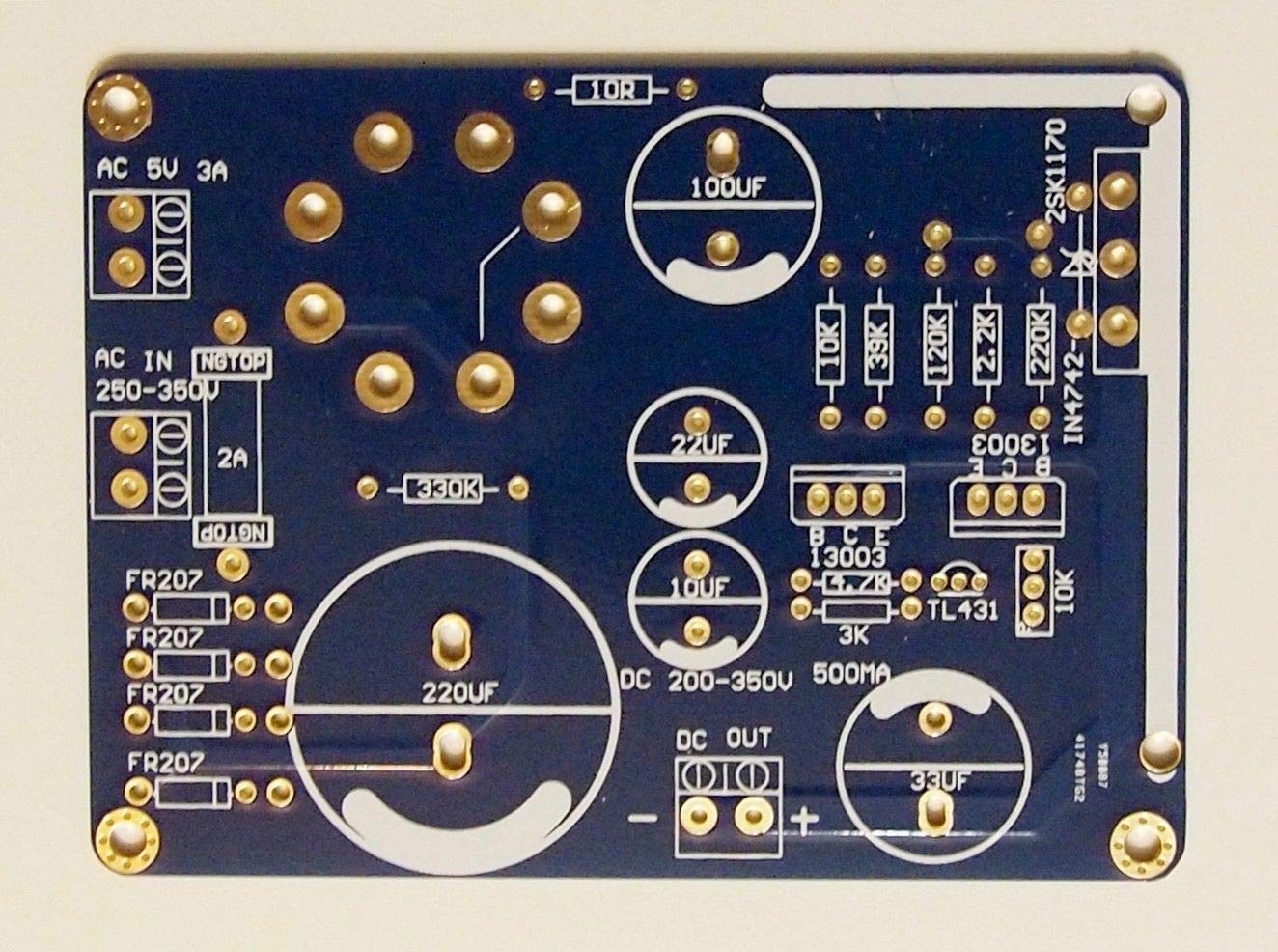

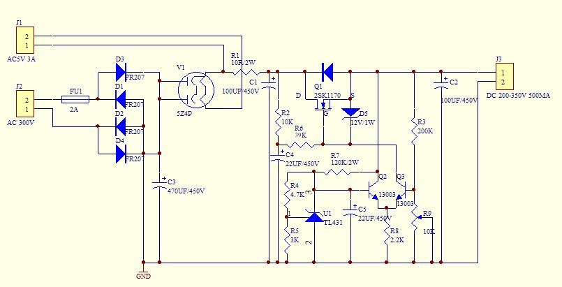

Hi guys. I bought the Kubota high voltage regulator board on ebay and assembled it as labeled on the board but without the tube - used the bypass connection on tube socket. Connected the power supply (270VAC) and got 180Vdc on the output - no load. I started regulating just to see how high could the output voltage get before connecting the load (available I had only 6.12kOhm ceramic resistor, so the current at 300VDC would be at around 50mA - just for test). The output voltage was responding. Then a connection got loose, so I switched it off to fix the wire. When connected back the FU1 fuse blew. After replacing the fuse (I used fast blow instead of slow blow because that's what I had available) there was no output voltage anymore. Troubleshooting revealed all rectifying diodes D1, D2, D3, D4 (FR207) destroyed. Replaced the diodes and checked all other components for damage and proper values (on the attached schematics there is no 330Kohm resistor paralleled to C3 cap - discharge resistor).
Next step was connecting power supply back (270VAC). SAME RESULT - blown the 2Amp fuse and this time only D1 and D2 diode destroyed!?! 😕
Now, I do understand the necessity of a Slow blow fuse (as per instructions, but I had only fast blow available) because of the inrush current for the caps. What I do not understand is the destroyed rectifying diodes (I'm not that deep into electronics)? Does anyone have an explanation?
p.s. You will probably notice that some of the component values on the board (C2, C3, C5) do not match with schematics.

If the board is laid out according to the circuit diagram you have provided then the area around D4 is a problem. The junction above FR207 should not be there.
No, the board is OK, there's no junction above FR207 like on the diagram. It is a bit confusing...

Your circuit diagram shows 470uF. The board shows 220uF. Jim's page on ebay shows a 120uF device.

The first one mentions how to use an SMD pad to short out the "inrush current limiting valve." You still need the input diodes which blow up when asked to drive C1.

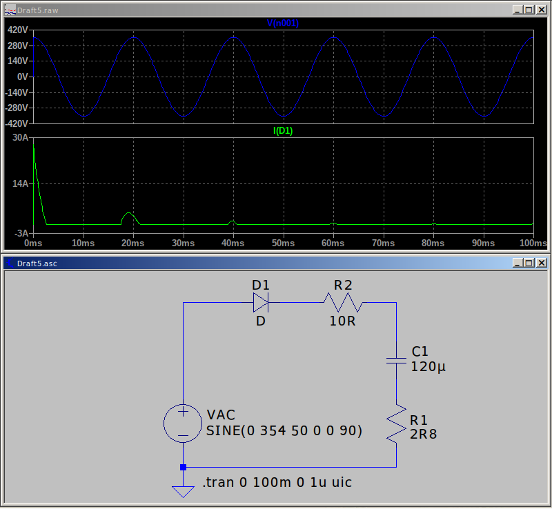

120uF @ 400V has an ESR of 2R8. The board suggests a minimum of 250VAC which is 354 peak.
It's one of those "How lucky do you feel, Punk." things.

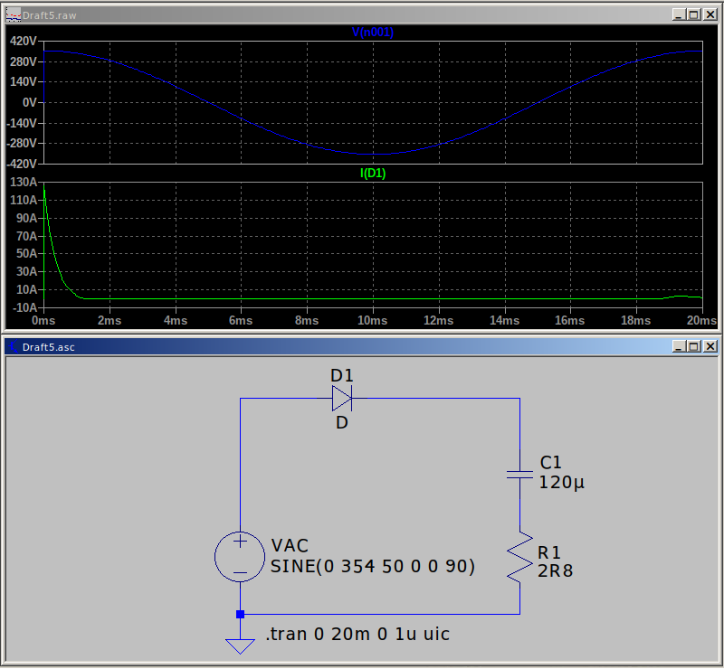

If you switch on at mains zero crossing you get about a single cycle 12.5A peak which is below the 60A Ifrsm for your diode.
If you switch on at mains peak you have 354 volts across 2R8 or about 126A and dead diodes.
I would ask for my money back but if you want to persevere fit the semiconductor diodes. Leave out/short the valve. Leave in the 10R resistor. Move C1 to C3.
