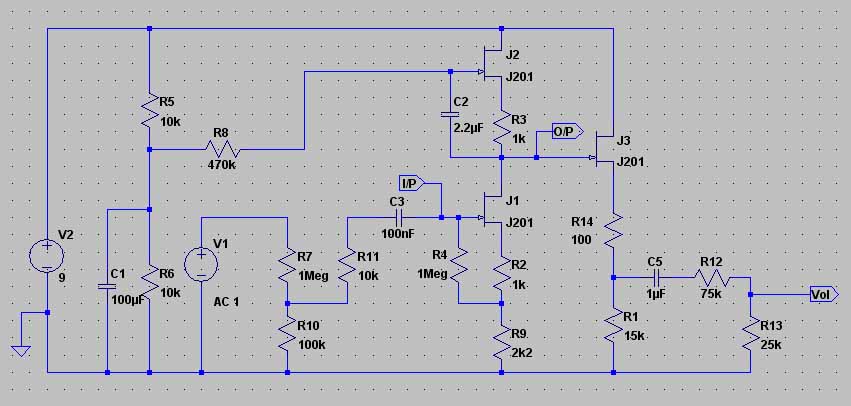

Hi guys. I'm simulating the following SRPP stage in LTSpice:
attachment.php
The idea is to use it as a clean boost stage so driving it into clipping is not the aim. It must accept a range of input signals up to about 1V which explains the additional R9. I added this to lift the DC levels of J1 and, I would think, offer greater headroom at the input. Yes it cuts down on headroom at its drain but that I can spare. For bigger signals I can switch the rail voltage to a generated 16.5V and more than regain it. Thankfully all that seems to be what I'm seeing.

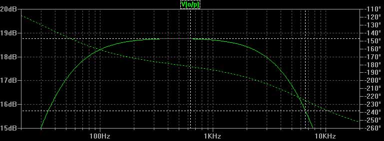

Originally I set it up without R7 and R10 in place with the input from V1 connected directly to R11. The frequency response top end was flat to way beyond the audio range. I didn't think there was anything odd in adding a divider (simulated drive control) to the input which may have allowed me to remove R9 but when I did I got the following response plot:
attachment.php
The top end rolloff now displays a 3dB point of 6.6kHz. Investigating a little further shows that any series resistance in that input line, adding a series parasitic resistance to V1 for example, affects the upper rolloff.
Now I can't really see any mechanism which would account for this but then I'm much more a BJT than a JFET man. Maybe the additional R9 in the source line is having an effect I did not anticipate. Can anyone explain what I am seeing here?

I can't see any SRPP in that circuit, just an active load.
Your HF rolloff is probably due to Miller effect. You have changed your source impedance from 10k to 100k (roughly). This will drop the HF corner frequency by a factor of 10.
This is not a BJT or FET issue - it happens with any inverting amplifier with capacitance between input and output.

The SRPP side of it is covered here. It may not be fully applicable but as I understand the circuit action, (not immediately obvious), it can be described as SRPP. It's really a step beyond the most common name given to it, the mu-amp which is not strictly correct.
http://www.geofex.com/Article_Folders/modmuamp/modmuamp.htm
Of course I do understand that there are shared characteristics between FETs and BJTs, my comment was only to show I'm aware of the fact that it may just be something which FETs are prone to that BJTs are not, e.g. I'm not too up on the scale of parasitic capacitances for FETs whereas I'm familiar with them for BJTs.
At first when I read your reply I thought "It can't be plain Miller effect, it must be way too big?" But with 100k(ish) source impedance and a corner frequency of 6.6kHz we are looking at a capacitance of about 0.24nF. The gain is roughly 20dB so the Cgd (?) would be in the region of 24pF wouldn't it? That seems a bit high but it is getting to the range I would have expected for Miller capacitance.
I've just thrown a cascode BJT into the sim between the 2 JFETs, (I wouldn't expect it to work as a serious solution but it should serve to decrease the Miller effect), and you are right, it does straighten out the top end. (Mind you the bottom end is a rising mess now and the gain has dropped some 16dB, but your point is well made. 😀 )
http://www.geofex.com/Article_Folder...p/modmuamp.htm
I wouldn't take too much notice of that page. For a start the author doesn't understand how to reduce thermal noise, so his suggested bias 'trick' does nothing. Your C1 bypasses PSU ripple and noise, but does virtually nothing for thermal noise which fortunately is not a problem here anyway. It is C2 which gets rid of thermal noise from the bias network. His explanation of the so-called 'JFET mu amp' is wrong; it is just a (poor) active load circuit. His final circuit is an SRPP but I suspect he doesn't really know how it works.
Your circuit is not an SRPP. An SRPP takes its output from the top of your R3, not the bottom. However, as it is followed by a source follower it doesn't make much difference, as you don't need the reduced output impedance a real SRPP gives. Best to get the name right, though.

Dooohhhh! Another Homer moment.
You're absolutely right! I have just noticed thanks to your post that I have the schematic laid out wrongly around J2. I should of course have taken the output from the top of R3 as you have said.
Damn it! That was one of the reasons I started to play with this circuit in the first place, I was trying to improve on other mu-amp designs which made exactly the same mistake by doing it "properly" and I missed the most important change in my drafting. And I spent some time gaining a bit of understanding of it too! That was just a stupid slip and makes all of your comments clear.
I understand what you are saying about the following follower as it were. Though with the takeoff in the right place maybe I can get away without it now. It might pay to just leave it in, unknown cable capacitance is always an issue for a guitar application and it never hurts to have a lower output impedance.
So you answered my original question and put right a glaring error on top. That's real value for money in my book. Many thanks for your time, it's been a pleasure being corrected by you DF. 😀
