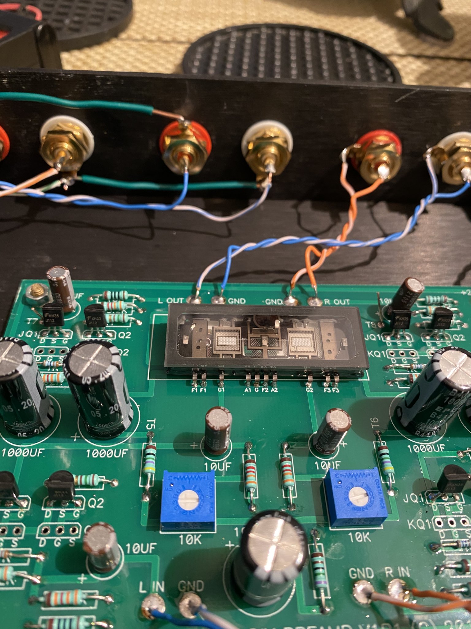

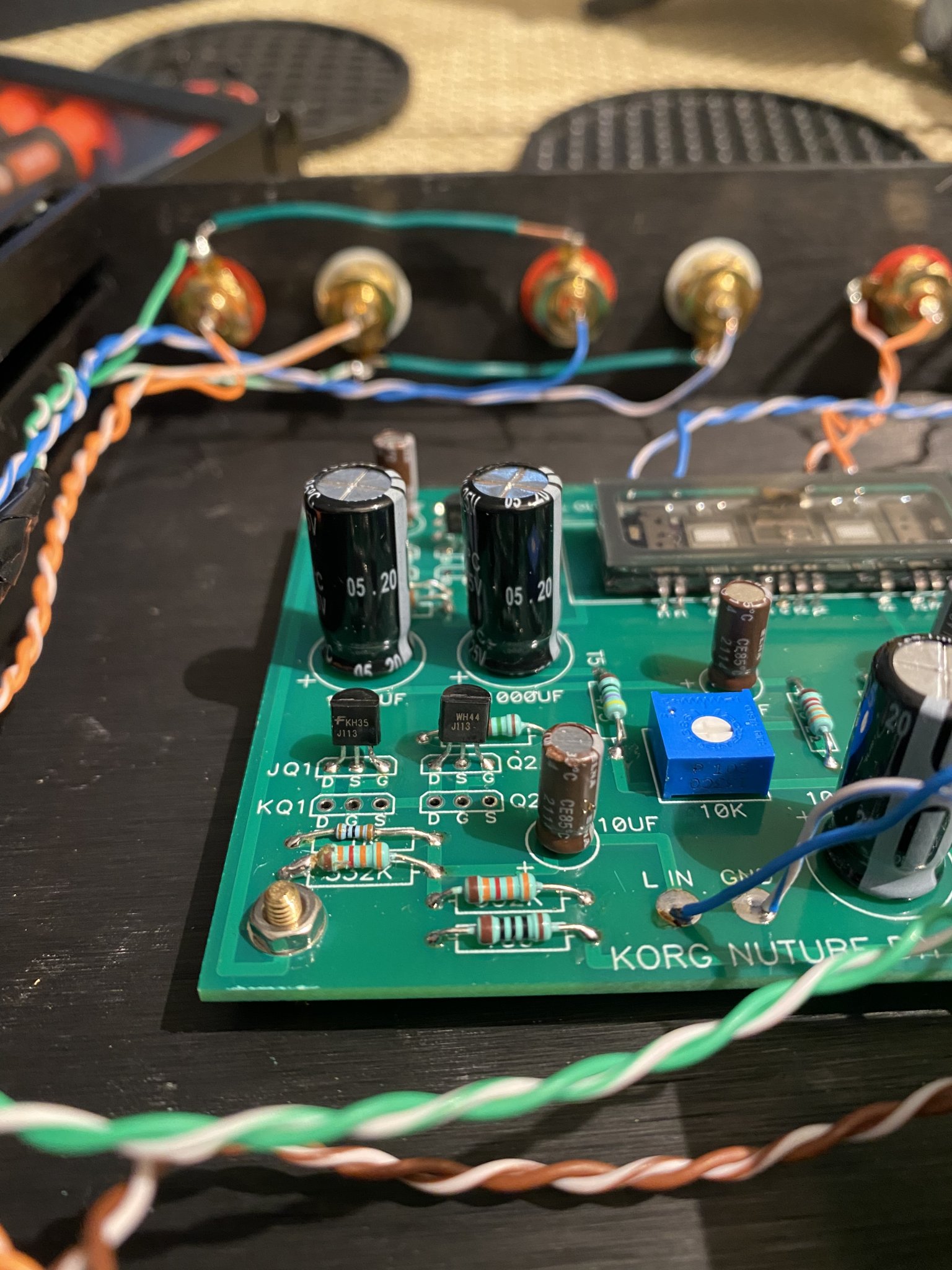

Hello, I purchased the complete b1 korg nutube . I have a question about the jfets. 7 are Fairchild and there is 1 with no marking on the left channel? The reason I am asking is I am having a problem with low output on the left

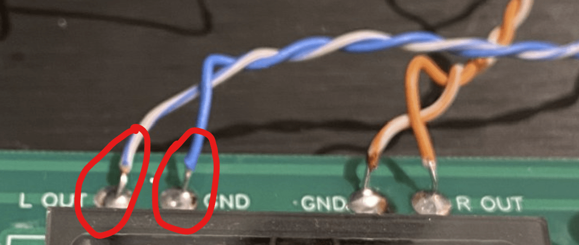

Yeah I think you did nail it. Thanks so much! I will make the changes.elwood625 nailed it - switch these 2 around! View attachment 1021066
thanks so much for your help. Good catch!Left output wiring.
