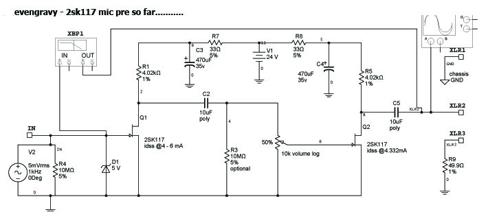

I am new to the forum here but have been slowly teaching myself audio electronics over the past few years (part time). My knowledge is somewhat lacking to say the least. I am trying to design a simple twin stage JFET mic preamp with components I have laying around, I have plenty of these (100 x 2sk170bl, 150 x 2sk117gr) so matching for Idss shouldn’t be an issue. Here is the circuit so far, am on the right track?
Not sure of:
Optimal supply voltage?
Biasing, should I go about this differently?
Am I right to test with a 5mvRms ac signal. Will a condenser mic output be more than this and lead to clipping in preamp?
I wish to eventually add a transformer on input and phantom power, what ratio should transformer be to avoid clipping, 1:1?

well i've been reading up on jfet circuits and I believe that leaving out the source resistors lowers the noise. see http://www.diyaudio.com/forums/analogue-source/28223-ultrasimple-mm-mc-riaa-preamp-2-a.html
not sure if this is a good idea so all suggestions/corrections are welcome.
The main confusing aspect for me is whether the Jfet is suitable for mic pre application, i'm not sure of the signal level to test the input of the circuit with, i'm currently using 5mV but I think a condenser mic will output more that this and overload the jfet input.

Dynamic mics - the only one which you can attach here - have quite low impedances. I do not know if that works well with your circuit. And most microphones do have much more output if "driven" quite hard (loud).
But your idea is at least very interesting: Why should a really simple design like yours not work with microphones if it works with MC pickups? Why don't you simply try it?

would you have any idea of the output voltage ranges of a condenser mic so i can do a few simulations?
Yes, I design them, at least these days.
15 mV rms/Pascal is typical. 1 Pascal is 94 dBspl. So the 15 mV might be typical output for a fairly close miced loud singing voice.
However when used with loud sounds like drums as much as a volt can be obtained.
Dynamic mics usually put out about a tenth of that...say 1.5 mV/Pa.

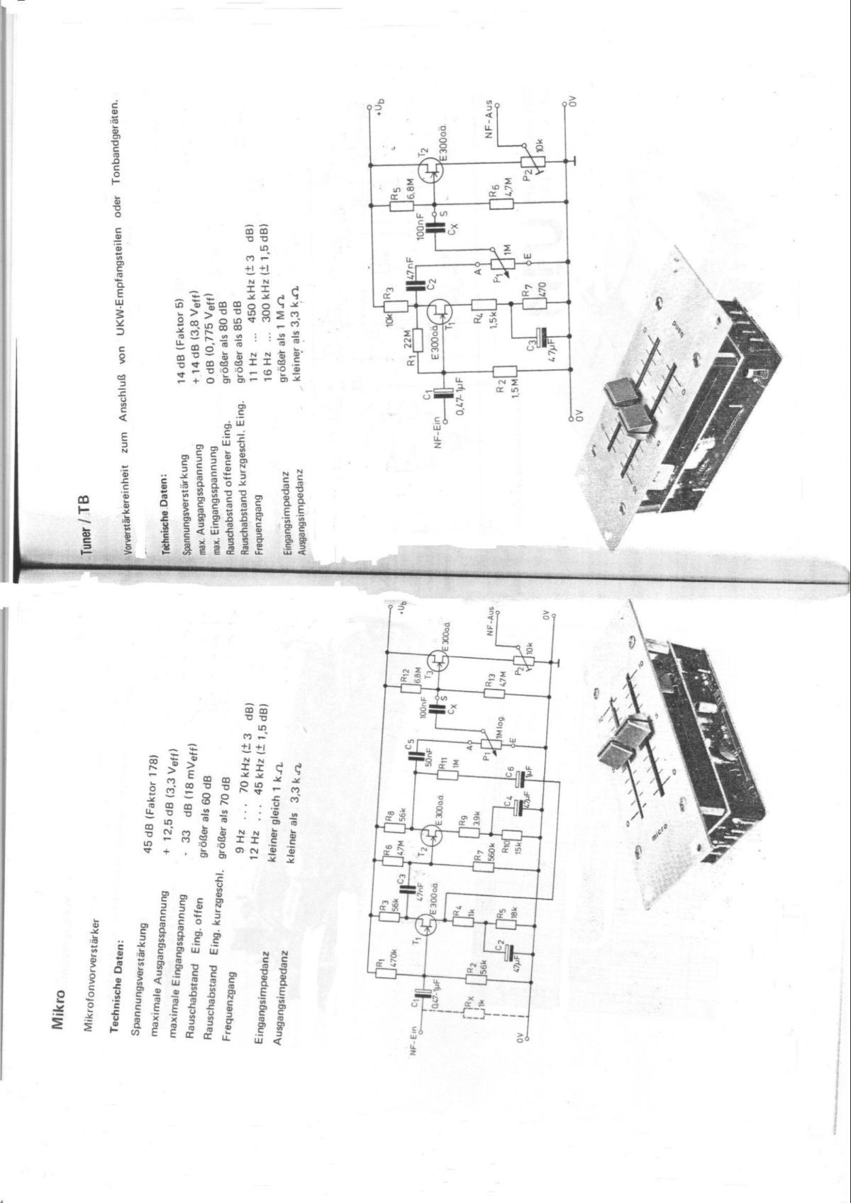

Borbley has 2 versions of an all fet mic preamp - one with transformer front end and one with jfet front end. Neither is inexpensive, but would compete with the best commercial products. I have many of his kits and recommend them highly.

thanks leswatts, this is just the information i needed, in testing situation would you design a circuit using output range then 15mV rms or should I allow more headroom, the circuit is for personal studio uses and wont be used for drum mic'ing, mainly vocals.
"Borbley has 2 versions of an all fet mic preamp"
right, would the circuit schematics be available? im not looking to rip off there design it would be handy to see how they have designed theirs to learn.
