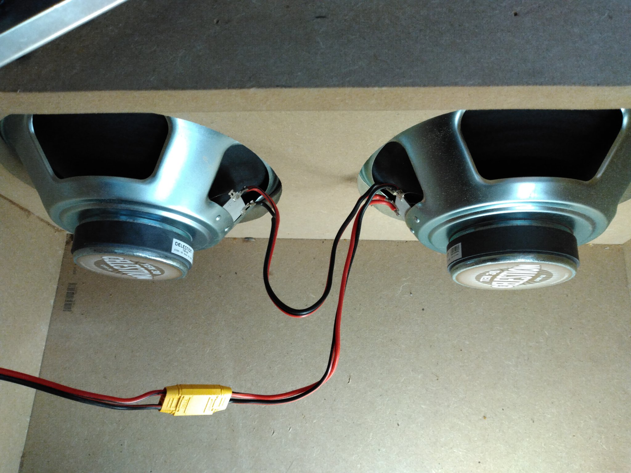

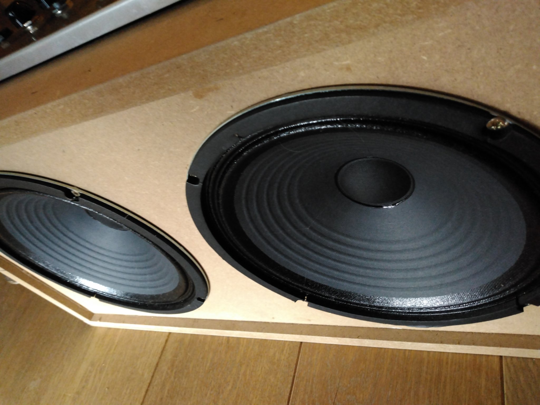

I use 2 Celestion Ten-30 speakers of 8ohm in parallel, they sound great and are pretty cheap!

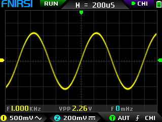

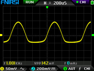

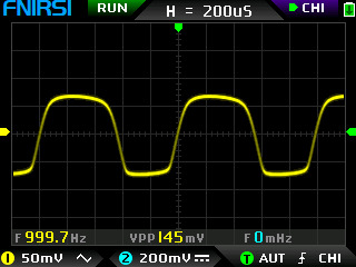

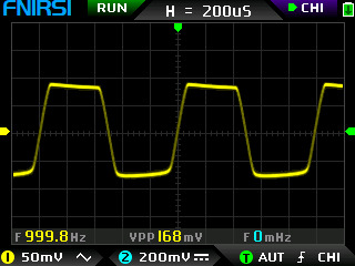

I have add a few scope images of different signal shapes that are possible with both tone shaping stages.

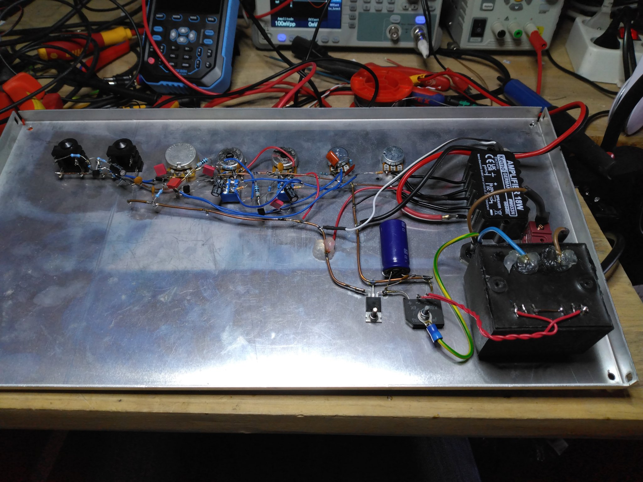

Also some images of my prototype amp!

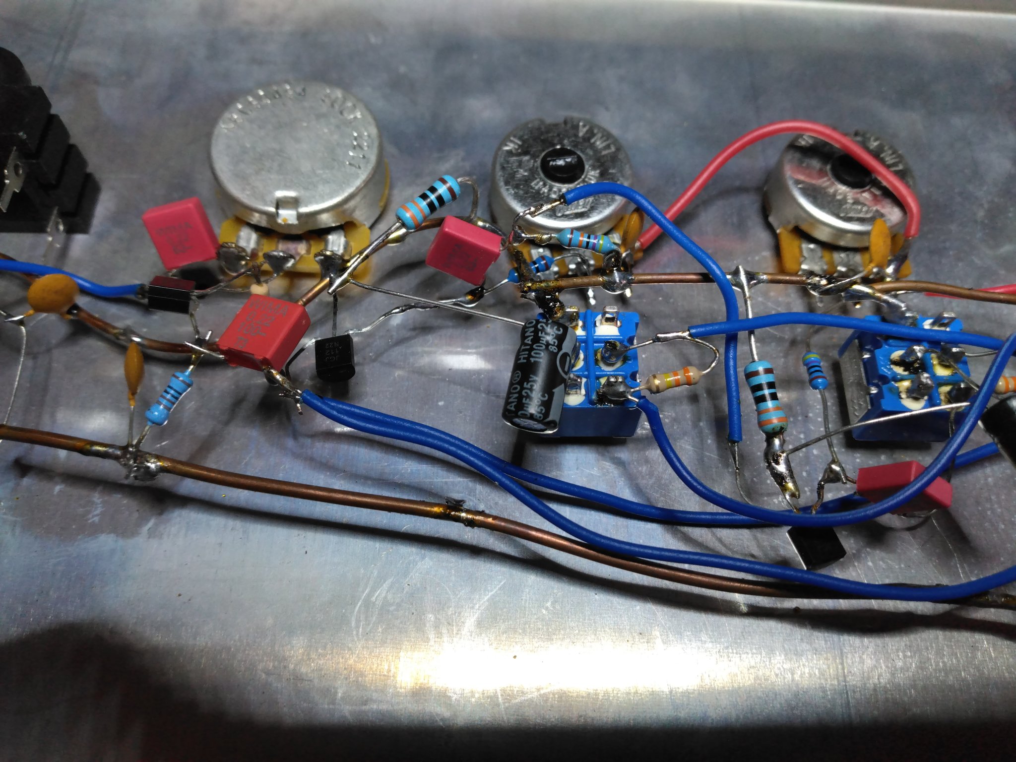

Hello Bitstream and congratulations on your amp build! I haven't seen too much point to point wiring like that on solid state amps.
Not trying to be critical on that approach, as it's DIY after all. But I would suggest adding a mains fuse on the power supply as a minimum
safety. I did not see one in the schematic or the pictures, but maybe you have already added one by now? Also maybe adding some insulation around the leads connections to the bridge rectifier and DC regulator, it's a little close to the chassis..a chance it could touch and short out..
Other than that , I like JFET preamps as well, they do have a good progression of sounds from clean to overdriven to crunch. Maybe not exactly as a valve/tube, but similar in the way it responds, with gradual progression of low order harmonics with input amplitude . Cheers~
And the incoming mains earth connection must go straight to nearby metal work with a substantial brass earth post/bolt, and this earth connection must not be used for anything else than safety protective earth (as happens with your bridge rectifier (*)). Signal ground has to be a separate chassis connection. Ensure the separate parts of the metal case are securely earth bonded to each other (crinkle washers ensure good electrical connection, remove any paint of anodizing layers). To save your future self (or others) from the risk of electrocution you should shroud all live and neutral connections within the box from accidental finger contact.
(*) Should your bridge rectifier case shatter or soften/melt, you will be left without a secure earth connection - this is why earth connections are required to be dedicated.

Very good and important point! We just want to ensure your electrical safety, Bitstream. DIY is great fun, if you have a bit of time to add in those features the risk of you or others getting zapped, or the amp shorting and causing an electrical fire, go down considerably.

When I do one-off builds, I generally do point to point wiring with perfboard and/or solder tag strips. The purpose of that is to have a rigid mechanical support for each component to be soldered to. In the case where one terminal lead of the component is soldered on to a switch terminal, input jack or something that is mechanically mounted to the chassis, that is okay, but to leave the other component lead(s) hanging in free air to solder wires or other components to does not provide good support of the component and no insulation with respect to the chassis, should it get moved. For big radial power capacitors, you can buy clamps that mount the capacitor cans to the chassis, then solder wires to the leads and use heatshrink tube over the connections. For big axial caps, you can mount them to a perfboard and perhaps a spot of silicone glue to hold them in place on the board and/or a zip tie.
Turret boards, solder tag strips or tag boards are well worth the added effort/cost in providing mechanical robustness and electrical safety. There are some beautiful examples of old tube amps being built this way. They are much more serviceable than older point to point amp`s which are commonly referred to as ''rat`s nest wiring''.
Anyone one who`s done servicing on equipment with rat`s nest wiring will likely agree.. It can be a nightmare!
