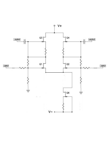

Has anyone experimented with creating a JFET version of the BOSOZ? Seems like an interesting idea. Just wondering if this has any merit.
-David
-David
It has a tremendous amount of potential.
While simply hooking up a 2sk389 in that topology actually
works well, it is easy to envision a fully cascoded and
constant current sourced version, with output followers
if you want to "gild the lily"

I for one would be very intresded in seeing such topology in action. Any posibility that you could post also a schematic? May be this is asking too much
Thanks very much Nelson 😎
Wow! Woo!
I started thinking about BOSOZ, Aleph P....and now this one!
Q3-Q6 could be replaced by mosfets CCS, or resistors...
What devices do you recommend for Q1 and Q2? Would LU1014D work in this circuit?

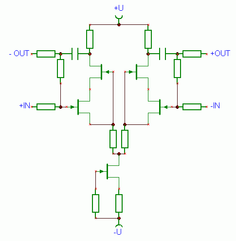

Zen Mod said:simplified enough?
even if I delete degenerative resistors randomly
🙂 Almost. I wanted to use resistors instead of CCS. Just keep the gain Jfets. How could we call this circuit. Bride of F4? 🙂
really depends on your power needs with F4.
if you need smaller swing,then resistors are good ;
for bigger swing you need CCSes and even higher PS voltages......and then even cascoding of jfets.

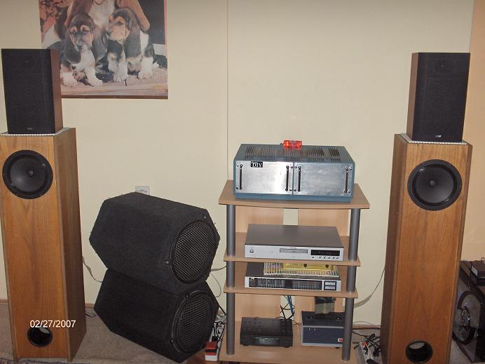

Short explanation of the "items" on a picture: Top: ZEN V9 (used to be zen V3). CD -player: Rotel RCD-02. Below that is what looks like
JVC equalizer. It is not. It's a BOZ in a new enclosure. On top of it is a chocolate can that houses an active X-over for the two 12" sealed subwoofers. They are powered by a smallish amp at the bottom (looks like a satellite receiver, in fact is was a satellite receiver until I put an LM3886 in it).
Overall, I am getting good sound out of my system, but feel that with a little more work, it could be modified to sound better. Somehow I get an impression that, apart from the speakers that did not get appropriate "home" yet, BOZ is the "bottleneck". That's why I was considering building another preamp. I was wondering about BOSOZ, then almost decided on Aleph P 1.0 and then...this circuit
So, most probably, this preamp would drive ZEN V9 with B200 on OB, but it would be nice to know that is has enough capacity to drive F4 in the future. Who knows....
Sorry for such a long post that appears to be OT, but I wanted to let you know what I use at the moment and what I'd like to do, so it could be easier for you to give a proper advice.

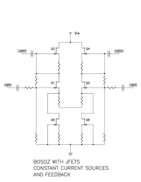

Nelson Pass said:it is easy to envision a fully cascoded and
if you want to "gild the lily" 😎
Yes we want, and the lily is all for it 😉
Like this, perhaps ?
If this Jfet BOSOZ was connected only to an Aleph30, are the output coupling caps necessary? It would be great to eliminate them if possible.
