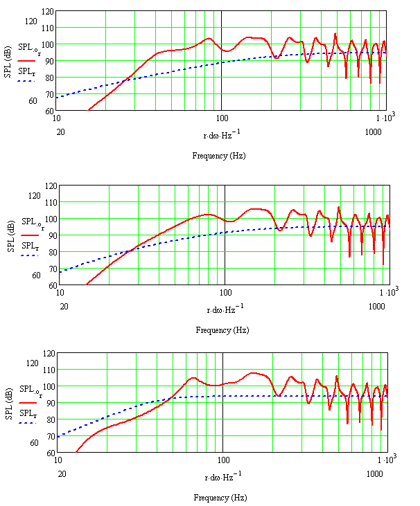

Based only on comparing published specs (which is probably worthless since A-N specs are apparently pure fiction), the cast version of the Super 8 MIGHT can be tuned 'close enough' (rear chamber, throat not optimal), but the basic Super 8 requires a much bigger rear chamber, throat, ergo much larger horn for a given cut-off.
Since typical 'full-range' ('FR') driver back loaded horns (BLH) are just extreme bass reflex (BR) alignments, the quick way to tell if a driver will work in a given BLH is to compare it's max flat alignment (typical box design default simulation) and the closer the box volume (Vb) and box tuning (Fb) is to the horn design's driver, the better chance it can be made to work, though best if the driver you want to use has a slightly smaller Vb and higher Fb since it's better to reduce rear chamber Vb and damp down any excessive HF band-width (BW) than use a contour filter to flatten any excessive mid-bass/lower mids and still probably have an audible dip in the acoustic XO BW (transition from horn to driver output).
Note that if driven with a high output impedance, then the impact of its series resistance on driver Qts (raises it) must be accounted for before making any comparisons.
GM
Your English grammar is better than many (most?) American's thanks to our pitiful government school system, sorry to say.

Don't know, haven't reverse engineered it, but its response shouldn't have much, if any, audible difference than with whatever driver it was designed for if you use a similar spec unit.

I don't know who told you that, but as I pointed out above, if you followed that logic, you could just stuff any driver into a horn and expect it to work if it happens to have an Fs near that of the unit it was designed for. It doesn't work like that I'm afraid. Look at the attached for sake of example. This is the modelled FR of a horn with three different drivers fitted, all of which have roughly the same free air resonant frequency (disregard everything over 250Hz BTW). The top shows the response with the design driver. The middle plot is with another unit, with somewhat higher Q & Vas. The lower plot is for a driver with a still higher Q and Vas. What do you think?
The cast frame AN might work passably, but the LF will be weak compared to what it should be. The other AN units will be worse. I know you don't want to hear it, but you can't circumvent the laws of physics, and hoping that something might work in the face of basic principles isn't going to do you any favours, although it will potentially waste a lot of your time and money for no good reason. BTW, the Jericho, IIRC, was designed for the defunct Fostex FE208Sigma (not the 206, or the current FE208ESigma).
hagr said:.........but I've been told that in a BLH, the frequency and the Fs is the most important...........
In a BLH where you want the driver's extended BW to mate to the horn's output, then the driver's Fs matters in that being basically a big vent reflex (BVR) it's not normally a good plan to tune it below ~0.707x Fs, same as a typical vented alignment unless it has a higher Qts, though its typically excessively large size (witness high Qts BIB alignments) is usually unacceptable.
Where the driver's Fs becomes a key factor is when you want the absolute maximum point source gain BW from a given driver, i.e. in effect a FLH that requires a compression (rear) chamber volume (Vb). Since such a horn is acoustically damped to the point where a driver with a Qts = 2.0 has been damped to a critically damped 0.5, any BW above its point source (rising response) BW will be damped down to uselessness. Note that this is an extreme example to make a point and not to be construed as a viable design except where such a high gain, limited BW alignment would be desirable.
Bottom line, if you choose your drivers the way I suggested, your chance of success with existing horn designs will be much greater than any other way folk's with a personal agenda will offer AFAIK and if you don't know the driver specs it was designed for, then all I know to do is input the horn's specs into HornResp or AkAbak and see what it looks like with whatever driver(s) you want to use. That, or continue blindly on as most folks did before such high tech luxuries were available at any price.

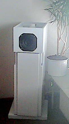

Wise choice. I'm not surprised -in practice, the 206 comes out closer to the 208Sigma (non 'E' model) the Jericho was designed for than the current ESigma model does. The FF225K works quite well in it too, providing high SPLs are not on the agenda.
AN Super 8 CF BIB
Sorry for being off thread with this question....but would a AN Super 8 (cast frame) work well in a BIB? I have a set of these drivers sitting around gathering dust.
The BIB concept appears to mate well with my room and the unused 300B SET power amps I have (gathering dust also).
