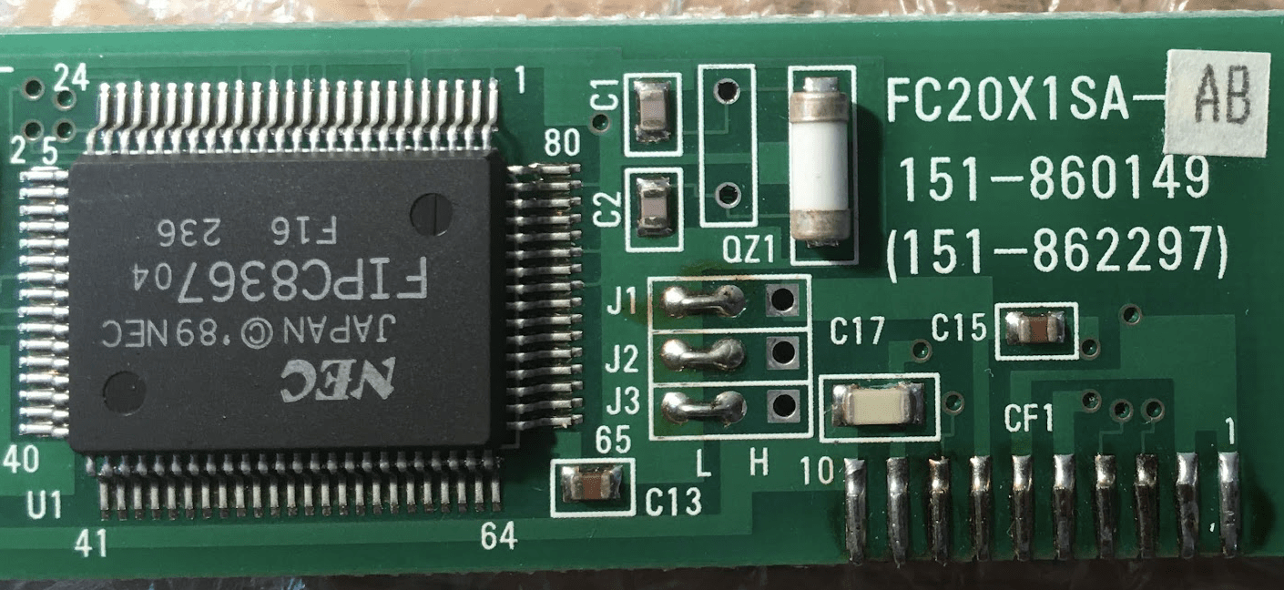

Here are 2 pictures of my "wrong" one (a FC20X1SA-AB, same as yours) :
Except the display itself (VFD module) and probably the chip, I guess all components can be replaced. I didn't try it yet. Normally, if I read the data sheet correctly, the display should work with a 5V input (can't say where right now). Then, there's a fuse (soldered) that I haven't tested yet, but I would check it, as well as the capacitors. I think their function is to keep the display lit if turned off too quickly after lighting (so it won't be stressed by a short impulse). Not sure about that. There is that page (https://www.maltepoeggel.de/?site=vfd), written in German (but google translatable), which can be informative about the display and how it works). Maybe you'll get some usable knowledge from it.

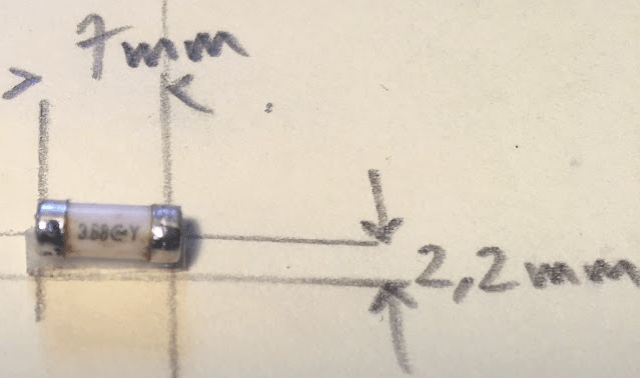

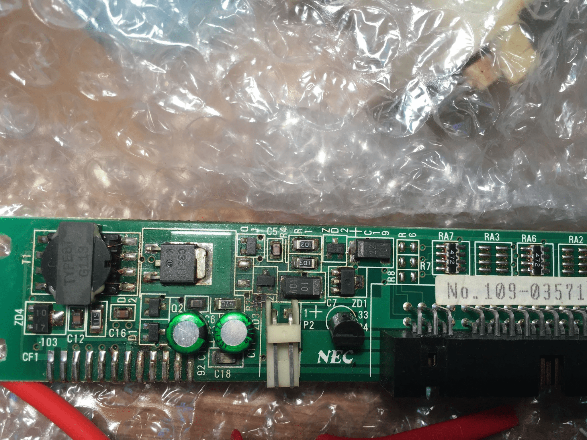

I can confirm that the fuse (white tube near the label, 1st picture) is faulty on my old display. As I didn't try to understand the circuit (and rather unsure I can do that 😉, I can't link it up to other components that could be wrong... But there's no continuity between the two sides of it.
Presently working on my old faulty display, your post took me to it... ! As I said previously, beside the fuse which is faulty, for sure, I suspect the 2 capacitors nearby the input 5V entry to be out of specs. A quick measurement (not easy to make between the glass and the PCB, and as they are in place not precise, even between the plus and minus of the 2 caps which are probably in series) showed a very very low and improbable value (like nF). Not many options, except unsolder them from the PCB and see in real life. I took some air and...

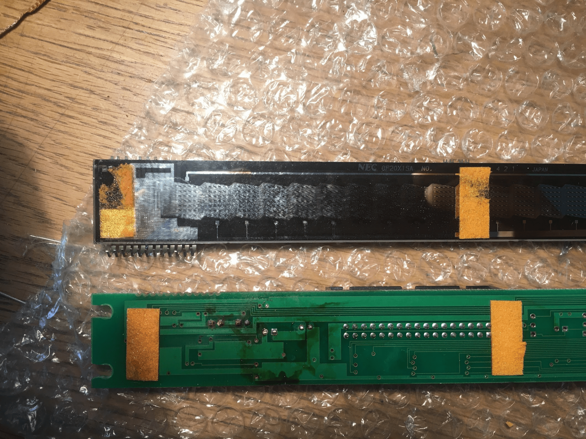

...First I separated the VFD and the PCB. Not so difficult but time consuming to keep the little pins from the VFD glass soldered on the PCB in good shape. And cut the adhesive foam in the middle to avoid destroying some tracks on the PCB. Picture after that.
Then it's easy to see that there has been some trouble in the area nearby the caps. I took me some time to unsolder those 2 little babies (22µF/35V polar Nichicon caps), but nice to be able to measure them properly. Well, at least, one of them, because one pin of the second broke (was broken?) when I took it out. Capacity of the only one I could measure is around 40nF on my Fluke... So at least, we have some culprits: those 2 caps (C10 and C11 on the PCB)
After a good cleaning it's better.
I don't know if I can test the PCB with 2 temporary caps and fuse easily because I would need to re-solder the VFD 24 pins and I don't want to have to make that several times, if the problem is not ONLY about these faulty caps. Moreover, I miss some adhesive foam to make it clean as it was and have to order some. If you experts have any ideas, I'm ready to experiment them!
Work in progress...

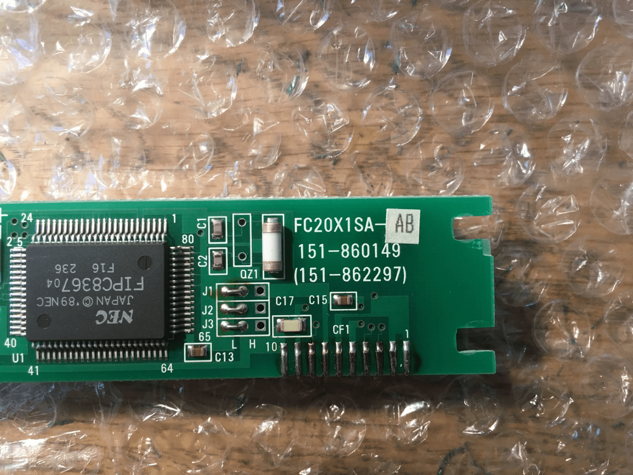

I've been cleaning the PCB thoroughly and I can see the circuit more accurately.
What I thought to be a fuse, next to PCB label, seems more likely to be a Quartz? It's in parallel with 2 caps (C1 and C2) which feed different pins of the VFD controller. Written on it: 3.68 CmY. Unfortunately I couldn't find any information about such a component... If someone has an idea? Same for this controller (NEC FIPC8367), Google doesn't seem to know that component...
This is far beyond my skills anyway.
The only way to know what it is (and maybe find the actual value of it) is to open my Consonance and have a look on the functional display PCB.

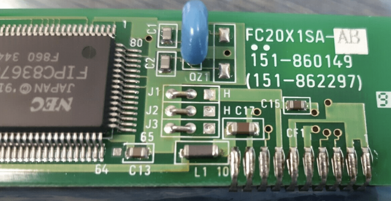

I'm now pretty sure that that component I thought was a fuse is a ceramic resonator, 3.68 MHz, 2 pins. On that picture of a new FC20X1SA-AB on the Bay right now (with a ridiculous $2500 tag price):
it is absolutely clear that there are 2 locations for such a resonator (labeled QZ1), one for CMS resonator (my version) or one for a through hole 2-pins component (this one).
So I re-soldered the one I had unsoldered previously 😉 but with the labeling on the top (so that everyone can read what it is).
I ordered double-sided adhesive foam tape (so I can bond the PCB and the display) and a couple of 105°C 22µF/35V caps of the perfect size. When received, I'll finish the job.

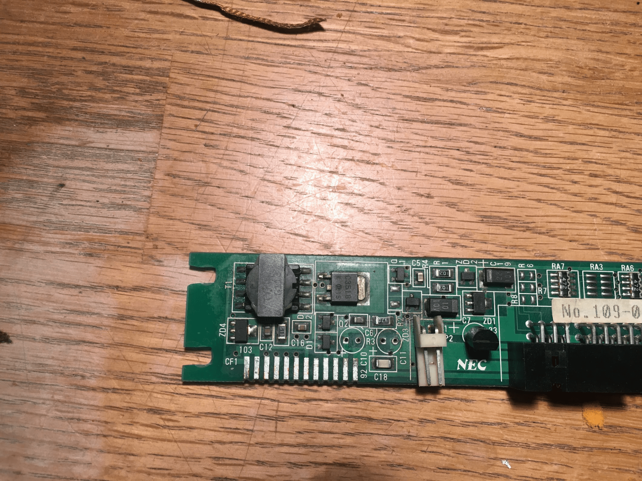

As for my Consonance VFD issue, I decide to disconnect the two-wire power connector to the VFD. Once I powered it back up. the small LED on the Consonance's PCB started flashing and relays started working again. For this reason, feel fairly confident that there is an issue with the VFD. Also, when the two-wire power connector to the VFD is disconnected, I measure about 9.8V open circuit across the connector; however, when it is reconnected, I measure only about 2.5V across the connector and everything stops working. Something on the VFD board must be pulling down the voltage/drawing too much current. Moreover, you can actually see some heat discoloration on the underside of the Consonance's PCB around the power supply's regulator section.

Thanks Forrestc. What you write about too much current drawing makes me think about something. When I connected my faulty VFD to a 5V/0.5A lab power supply (constant voltage), I read 1.5V on the PSU, instead of 5V. So something was draining current and it cannot work with so little voltage. On the board, for sure, the 2 small caps (22µF/35V) are washed up. Is it enough to make this happen? I'm not a engineer, so I can't really say, I'm just able to note it!
I should have both caps and adhesive foam soon, then I'll be welding and reassemble glass and PCB. After that I'll try a transplantation and hope to give (good) news next weekend.
