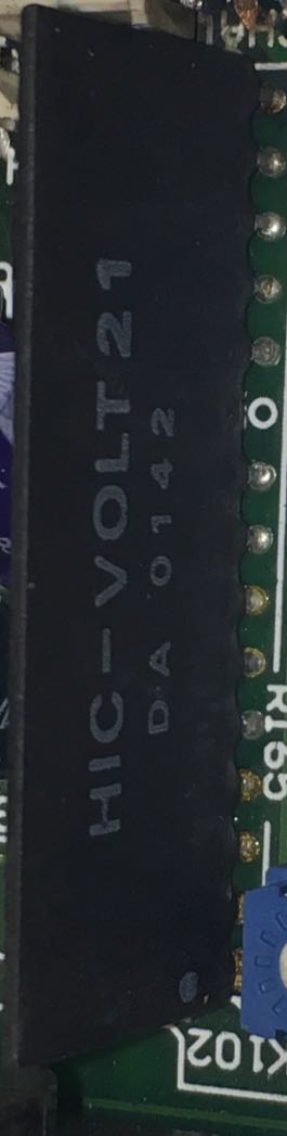

I'm desperately trying to find service manual/schematic of the JEDIA L2.2 / JD-MEDIA LX2.2 / R.C.S. LX2.2 power amp. I asked to the manufacturer but they didn't respond yet. Have you any suggestions to find service manual of this particular amp please?
I need to figure out input stage topology because this amp seems much more prone to the interference comparing the other amps that I have dealt with. I'm also trying to figure out purpose and equivalent schematic of the HIC-VOLT21 proprietary daughter board/module at the input stage.

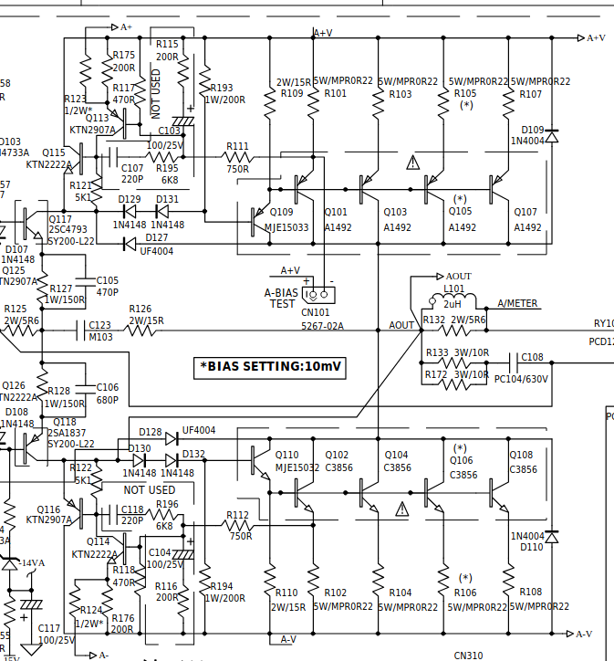

Hi guys, I found the schematic from a different model (L60AS) of the company. I'm trying to deal with interference problem which is excessive. Looking at the schematic, amplifier output topology is uncommon: collectors of the output transistors are at the output side, not at the power supply side. This way, manufacturer able to attach all output transistors to the heat-sinks without using an insulator. So, heat-sinks become part of the active circuitry. I think interference comes from the heat-sinks that acting like an antenna. When I ground heat-sinks using a 20-100nf capacitor, the noise noitceably suppresses.
What I am asking is, what should be the proper way to suppress the noise introduced by the heatsinks since they are on the active side?
