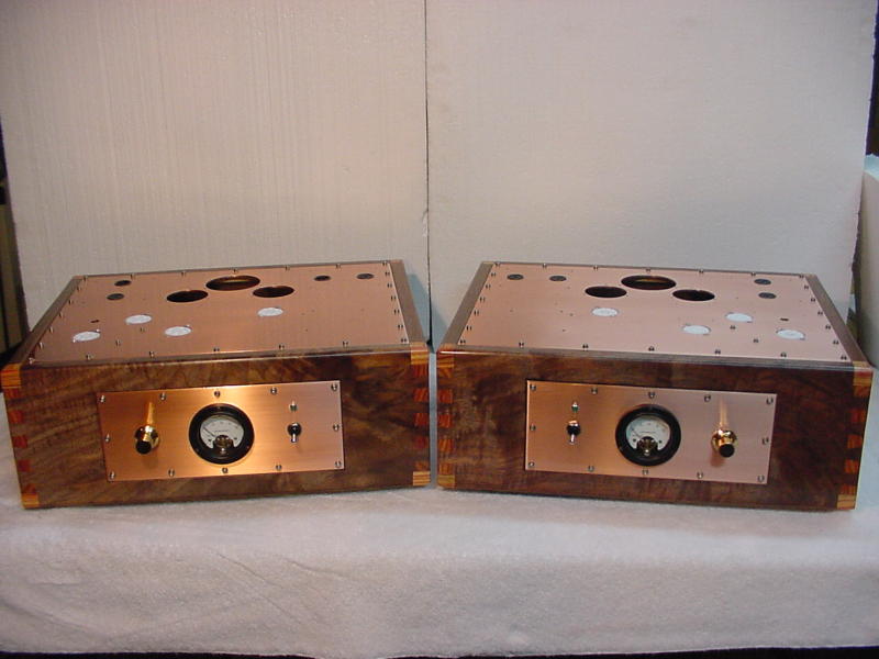

Hello Everyone,
Well, this is my best effort at making chassis from scratch. I will need help making sure I solder all the wires correctly and get the polarity right on some of the parts. These are my first DIY audio amps. Hope these inspire some other new person thinking of doing thier own DIY project.

Paul, those chassis look great! You did a nice job with those corners too. Just curious, where did you pick up those octal sockets? AES?

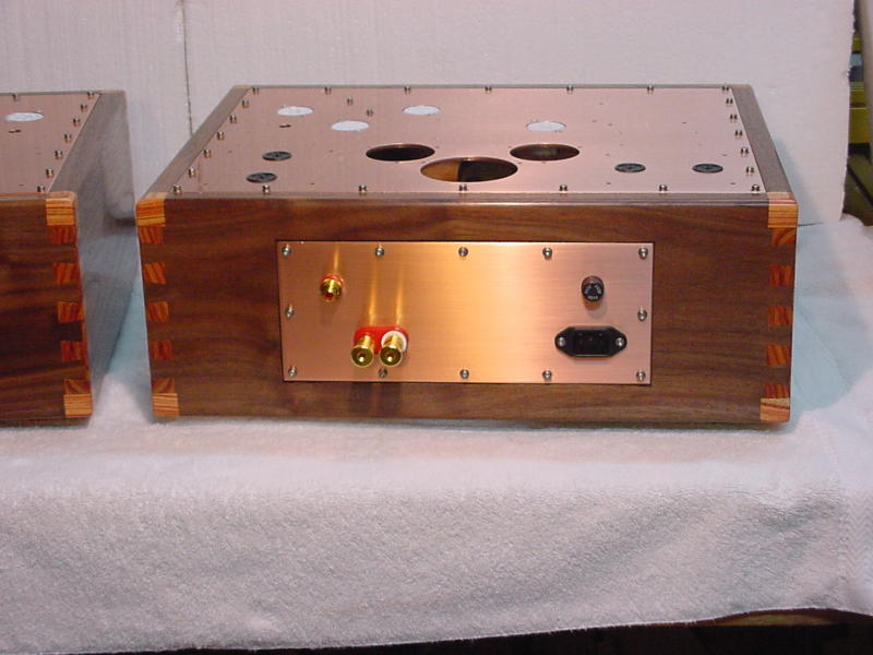

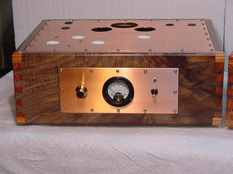

The sockets are Yamamoto's teflon. One is a UX4 for 300b, one a UX5 for 76 type and two are octal for a GZ37 and 6SN7. The majority of the wood is 3/4 solid walnut harvested and milled by a local. The corners are tulip wood from South America and made using an Incra dovetail jig. I capped all the corners with the tulip wood to fix some mistakes and it came out better than expected.
Hello Mr. Daniel,

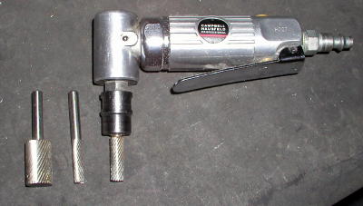

First I must say I am in awe of your work and you have certainly inspired me with some of your ideas. The holes were tough, very tough. I laid out the dia. with a compass, then drilled little holes completely around the inside edges. I then used a dremel tool with a cloth reinforced cutoff wheel to connect the little holes and drop the center out. Next, using a electric hand drill I used a small diameter metal cutting bit to cut through sharp ridges left. Once they looked round, I used drum sanders , varying in size from 1 inch to 2 1/4 inch, that mount into the drill to round the holes, checking with a dial caliper to make them fairly uniform. They might vary by 10 to 20 thousands.

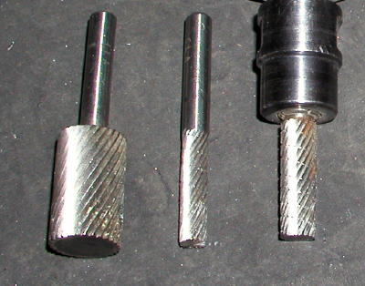

Hi Peter,
The bit on the left is what my metal cutting bit looks like. It was a cheapy though and seems to wear fast. I mounted the copper in my wood working vise to hold it vertical while I worked on the holes. Once they were all done I spent about a week polishing the plates to remove all the scratches. I wanted a mirror finish, but a local plating shop quoted me $450.00 just to polish them. I used my 8 inch bench grinder and a buffing wheel with compound to get close and then brushed them with 3M metal sanding pads by hand to achieve the brushed look. I coated them with a clear acrylic, non yellowing, paint. Four coats.
