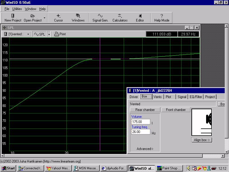

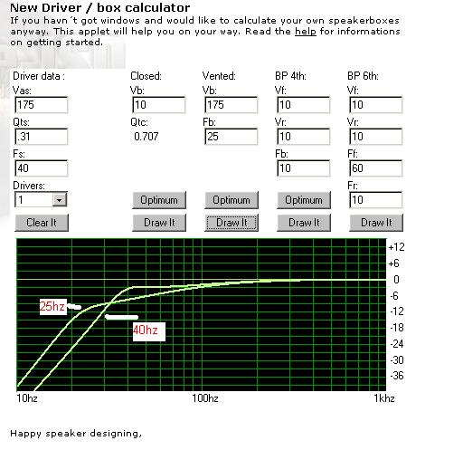

hi ive ordered a jbl2226h woofer..
i dont need 20hz..only 30hz🙂 🙂
i have a choice
37hz 130litres
or
25hz 175litres.
Fs=40hz
Qts=0.31
Vas=175litres
Xmax=7.6mm
Xmech=20mm
(both oneway)
Eff=97db
600watt rms
i know its a good driver,and the guy at www.speakerbuilding.com *almighty subwoofer* as done a similar thing with success🙂
i know it wont go that low efficiently,but what sub is efficient + low bass ??
( i have winisd proper version at home)il use several programs to check port length 🙂
what do you think.

I would go with the 37 Hz version. It won't go quite as low, but you will have a more powerful, stronger bass.

i think that the higher efficiency higher tuned one would definately be good!!

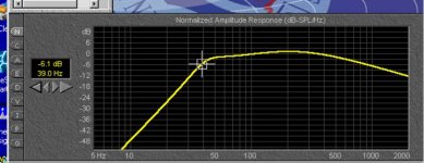

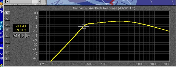

I've been scaling boxes around these drivers for sometime.
Tune the box anywhere from 40 - 43Hz. Anything lower,
and kiss your efficency goodbye. Not to mention, this is
a woofer, and, not at subwoofer, so, these speakers
are useless under 40Hz.
If you run a sinewave generator through it, it should
unload below 25Hz.

?can ppl speak english
EXCUSE ME
can anyone hear the words that are coming outa my mouth!
MY ONLY CHOICES ARE:
1.shiva
2.peerless
3.jbl 2226h
NOTHING ELSE!! NO JBL2245 NO NOTHING! !!!!!!!
i live in New Zealand where subs cost double what they do in US
with shipping.
I chosehigh efficiency .
Amps here are very expensive.
AND
a jbl2226h DOES THE SAME SPL AS A SHIVA when tuned to 25hz
so there.
