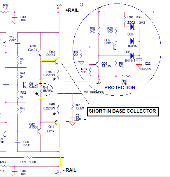

here is the schamatic:
scs175_preliminary_sm.pdf - File Shared from Box.net - Free Online File Storage
the restitor i am talking about is R44, the capacitor i have replaced (now i know it is correct value the one i put into)
is C20.
i really suspect, that since this component are really near the transistor Q11 whch is a C3421 it may be damaged itself and causing the resistance to burn out.
Now a buzz sound come out from the speker at every volume ,and without no input connected.
You really need to check all the transistors Q10, 11, 12, 13 & 14 to make sure they have not blown. If I was servicing this amp I would automatically replace all of them as they may be damaged.
I suspect the amp may have been overloaded at some stage. The subwoofer also needs checking as it could have gone short and caused the damage. Its unlikely the capacitor C20 was the case only part of the symptoms.

one question... did you test the trannies out of the circuit?
the reason why the resistor burnt is because the power +/-rail goes direct to that resistor due to short in base collector of Q13 & Q14. Now since you are already making a check-up why not check all associated transistor, resistor values. check for short circuit on the PCB track. I see you make some jumpers.
the values i posted about transistors q10- q14 are measured after i removed them from the pcb, is it this what you meant?
what you mean for jumpers? the wire i put where the tracks were burnt?
in that area i carefully check shorts (which i may caused) but everything was ok.
do you want me to check other areas?
can you explain this like for dummies? :trapper: 😛

THIS IS RIGHT 😀
YES THE WIRES. MIGHT BE TOUCHING SOMEWHERE WHEN THE SUBSWOOFER IS IN ACTION DUE TO VIBRATION.

YOU MIGHT CONSIDER TO CHECK THE PROTECTION ENCIRCLED WITH BLUE

i'm having hard times in my homeworks.....
1. in SECURITY circuit you posted, there are differences between diagram and real world:
components R 48, 49, 54 and ZD03 are missing on the pcb.
should i go on to take out the PROTECTION components and test em one by one?
I don't know how test the C22 cap and i don't have a capacimeter.
2. I can't figure out how to check the +- rails. I am not able to identify them on the pcb.
where should i put the tester ends to measure resistance?
below it is 2 new pictures with some detailed added, please download them to zoom in more.
3.The other trans already tested which seems working, should i replace em, should i hfe test em (dont know how) or i don't have to mind bout em?
thanks

Can a trannie do such a thing if not properly cooled?
I'm asking this because it is really strange, this time dependency and also , the fact the heatsink is so slow to warm up, when the trannie itself took a second to go hot.
I bought an extra kit of this two components, but now i have only one left, i would like to fix this issue but i am loosing fatih...
please guys help!

Have you measured the impedance of the subwoofer? And the insulation between coil and basket?
3,5ohm in the coil, and no i did not check the basket insulation, i will do it today.
