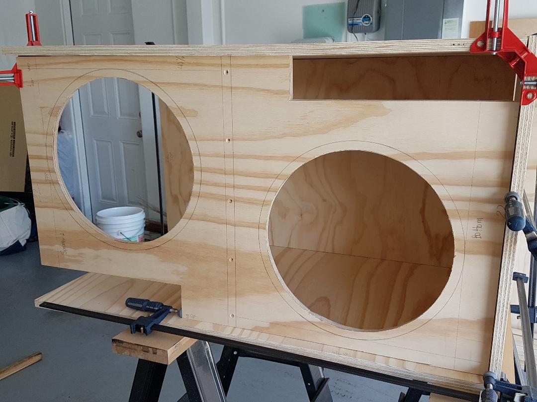

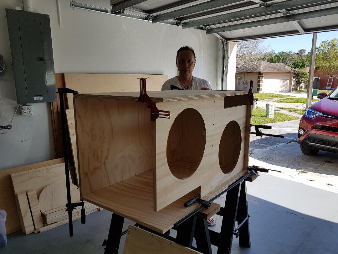

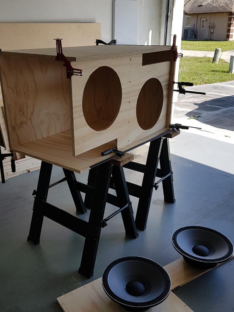

Hi GM, I bought 3 sheets of Arauco ply for $35 a sheet 4 x 8 and 7 equal plies with exterior glue. They're heavy but not as heavy as Baltic Birch. These will be use for playback DJ music there will be 2 cabs built as you can see by the wall on the garage all panels have been cut. The breathing your talking about is for a whole rectangular cab with no stiffeners, correct. If you look carefully I have pre drilled a center piece to separate 2 equal cabs in one. These cabs are 10.66 cu ft tuned to 40 Hz the ports were calculated by another top poster here on diyaudio. The ports are 7.9" deep and 15" wide by 3" high with a center piece support ply. I oversized it a little to compensate as I will be mounting a Penn Elcom 2 angled casters on the bottom and 2 angled handles both metal, plus a recessed wooden handle ala F1. So I also plan a piece of 1" x 3" wood support from baffle to rear of cab just to prevent some resonance but I will also put 1"x2" strips on all inside perimeter of the cab to help joinery as well. Please give me your thoughts, thanks.
So I put this project a few months behind and pulled it out of the garage and started working on this 215 sub. So I am looking at wadding saw poly fill in WallMart like this its 1/2" thick at $12.97 a bag and the amount inside is enough for 1 sub 41.5"x23.75"x23" cab. Is this the right stuff to use? Theres an eBay ad for a 1/2"x18"x36" poly wadding for $10? Which one should I get, Thanks!

I did, but each 'cab' ideally needs to be braced against 'breathing' with them crossing behind the driver and notched out to support/brace it in lieu of the 1 x 3 baffle/rear wall brace.
FWIW you only need to add glue blocks along ~70% of its length and can be just a few short pieces spaced along this length. Note that if you want some driver protection against dropping the cab on a corner, then don't block the corners, creating a crush zone.
