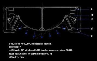

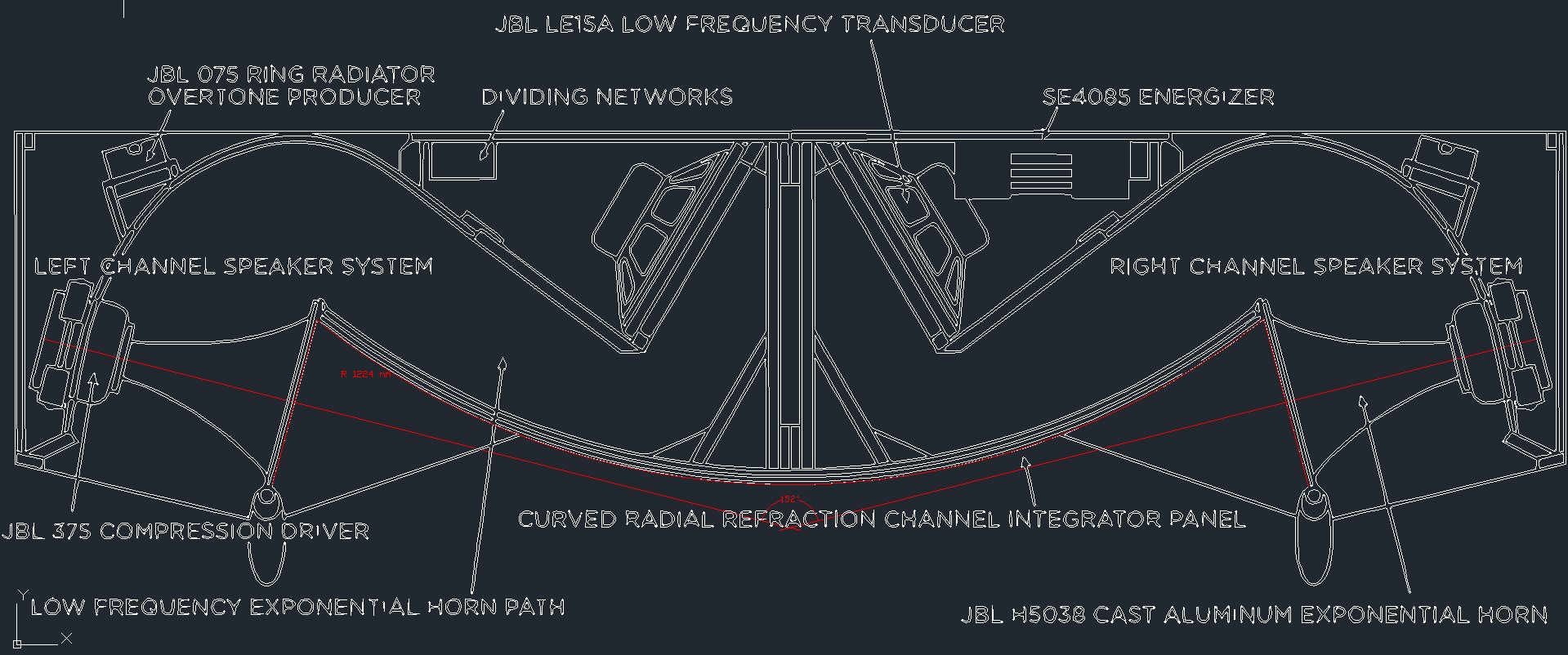

I write here not to hijack the other thread. Yesterday evening I converted the diagram that can be found online (here: https://www.coastalvectors.com/blog/wp-content/uploads/2012/02/Paragon-Diagram1.jpg ) in dwg to be able to see some more specs.
Not very interested in the inside of the speaker, rather on the front side.
I've read that the original one needed to be lifted around 40-50cm from the floor to perform its best. I think it is due to the fact that mid-horns are diffusing horizontally into the curved baffle, but not so much vertically. A full range speaker should diffuse more on the vertical plane, so the curved baffle has to be more extended vertically as well.
Is it correct? Is there anyone who tried something similar?

From my own perspective based on what I've read, the curve acts as an acoustic lens. The key being that it offers a steady 180 degree stereo field. Each driver cannot see the other (blocked by the lens) and as you move to one side the opposing driver becomes more direct, thus you get the direct as well the near reflection and keep a steady stereo field. It's a 1950's idea so it isn't going to be perfect, but some of wanted to try to build something for a stereo "illusion" in really awkward rooms and thought it might be an interesting approach.
From a quick experiment with no measurement, imo it works. BUT I'm under no illusions it's not meant to replace good stereo triangle in a good room.
