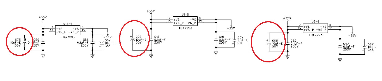

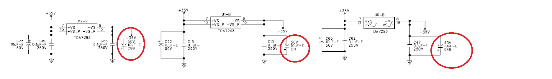

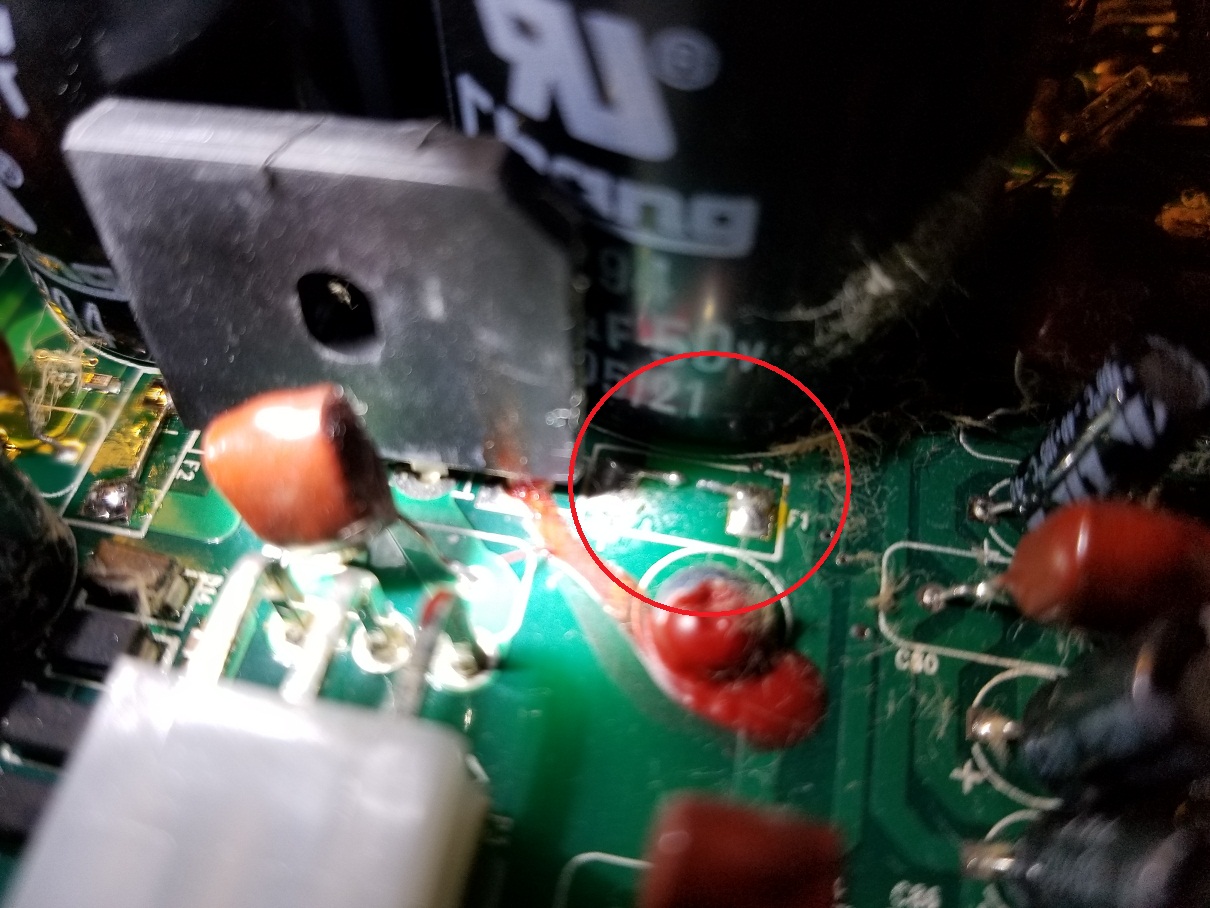

I am way out of my knowledge zone on this one but said I would at least look at these non working JBL LSR4328P monitors. Looking at the power amp pcb I saw three caps blown off the board. Attached picture. I replaced them, hooked up my bulb limiter, fired it up, bulb dimmed out. Bypassed the bulb, turned it on and pop, pop, pop. All three. That's all I know. Based off where the caps are, are you thinking TDA7293's are bad? Looks like the blown caps are all on the +VS rail. I'm guessing that the other monitor is the same problem but haven't taken it apart yet.

Those are smoothing caps so just remove blown ones and measure voltage before proceeding. The voltage will be there with or without them.

It looks like it's only blowing the + side of the power supply, a shorted bridge rectifier would feed AC straight to the capacitors and blow them up.

Sorry xrk, but I haven't measured it because I'm not sure how. I'm assuming I have to bolt the power IC's back to the heatsink which means when I plug the power transformer, which is bolted to the inside bottom of the box, back in to the pcb it will be face down in the box. And do I need to plug the speakers back in also? Am I overthinking this?
Imagine you had everything ready to go with replacement fusible links and new caps. But leave off the caps and measure the voltage where the two cap pins are. We just need to know if the voltage there exceeds rated voltage printed on cap.
