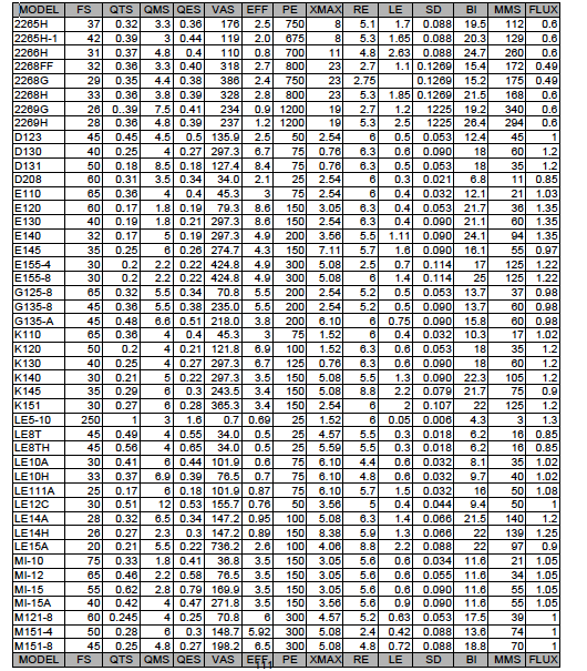

I have a fine used JBL K140 / 8 Ohm speaker. I would like to make a cabinet for it, to be used for bass-guitar purpose. As my son is playing the 5-string bass, I need it to go down to 32 Hertz. There is an equaliser before the poweramp, so some variations can be dealth with. It do not need to be especially sensitive, I just would like to have that wonderfull presice sound from the JBL.

Perhaps this chart will help you:
http://www.lansingheritage.org/images/jbl/plans/1975-kit-plans/page14.jpg

The K140 is a 15" with an FS of 30Hz, handles 150 watts, and is quite efficient. Granted, there are some modern speakers arguably better, but it was designed specifically for bass guitar use, albeit in an age where most bass players only had a low E at 40 Hz rather than a low B at 31 Hz.
Tuning a fairly large box around 32-36 works great, the K-140 does work well in horns too, but most bass players prefer front loaded to folded horns.

So far, thank's for all the answers. That scheeme looks mighty fine, but I do not understand anything about those data's. I am an old radio and Tv repair man, and I know my way in amps ect, but my experience in building speaker cabinets is very limited. I made a box for a Goodmans Audium 100 P for my bass 25 year ago. 'That's all! Well, the purpose of a cabinet with the JBL id for my son, who plays jazz in a big-band, so it will never be stressed to its maximum. I sure would be sad to ruin souch a nice speaker. I do not understand the sentence: " Tuning a fairly large box around 32-36 works great," Could You please explain that to me? I once read an article about determining the 2 low resonance points of a speaker/cabinet, by a variable tone generator, an amplifier and a 100 Ohm series resistor. Is it something like that?

By fairly large box, I mean around 8-10 cubic feet, 224-280 liters.I do not understand the sentence: " Tuning a fairly large box around 32-36 works great," Could You please explain that to me? I once read an article about determining the 2 low resonance points of a speaker/cabinet, by a variable tone generator, an amplifier and a 100 Ohm series resistor. Is it something like that?
Regards Soeren Poulsen Denmark
If I recall correctly, about 12 cubes, 336 liters would be as big as you would want to go, but a box half that size will work.
There are a number of on-line port calculators that will spit out port size after you input cabinet size. Go with a big port, around 6 inches (125 mm) diameter would be good.
If you decide on a small-ish cabinet tuned low, the response will fall off more towards Fb (frequency box, the tuning frequency).
A falling LF response is actually preferred by most bass players, an Ampeg SVT 8x10, the most professionally used bass cabinet in history rolls off at 12 dB per octave from around 80 Hz or so.
Longer ports tune lower, always best to make the ports a bit longer than needed and cut them down when you test.
Testing Fb is easy if you have a variable tone generator.
The test you were describing also requires an ohm meter, and does not as accurately determine the Fb as what I describe.
If you don't have access to a tone generator you can probably find some closely spaced tones somewhere on the web.
Put a white or silver dot on the edge of the cone, turn up the power till you see some cone movement, then sweep around the predicted Fb, the cone will move the least at Fb. Below Fb the cone excursion goes up rapidly, and excursion will go up about a half octave above Fb, then come down again.
No need to tune below 32 Hz, but if your son ever starts to like to slap strings, be forwarned that that output can go down to 10 Hz or lower.
A friend of mine destroyed his D-130 with one slap. The K-140 is more robust, but it still only has 5.08 mm Xmax, if you see the cone move more than 10 MM (less than 1/2 inch) peak to peak it's time to turn down.
