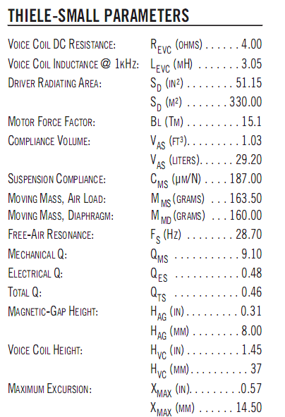

I have a brand new JBL GTO1014 (4 ohm single coil) sub that waiting for over one year under my table.. (I've sold my car in last year 🙁( )
Anyway, recently I decided to use it as a home theater subwoofer in home.
I've calculated a ported box in WinISD beta and it recommended a 45 lt box which is tuned to ~25Hz.. And as WinISD says it will give ~23Hz (-3dB) with that box...
So,
I'd like to ask that should I build that box or do you have any better recommendation considering WAF (a smaller box with close F3)..
Thanks a lot in advance for any kind of help..
