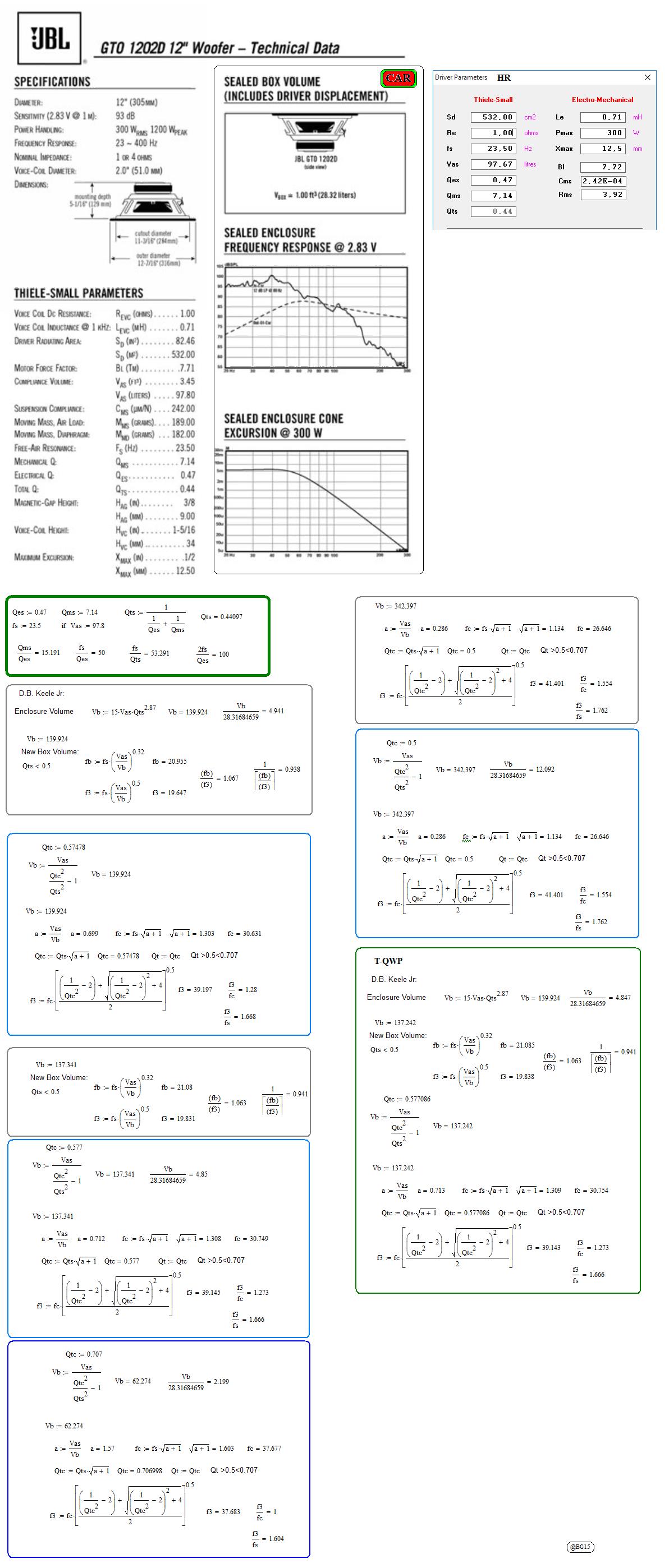

This may help ppl, specs.
http://www.abtec.co.nz/JBL-GTO1202D.php them girraphs provided i wouldnt trust much.
However.. Google image searching the driver finds alot of sub builds, prehaps can findya summin there.

I don't have one of the subs sitting in front of me to ask it personally. But using its T/S parameters I came up with an EBP of 50. An EBP 50 or lower usually works best in a sealed. The sub will still work in other enclosures. Maybe someone with much more experience than me can come up with something.

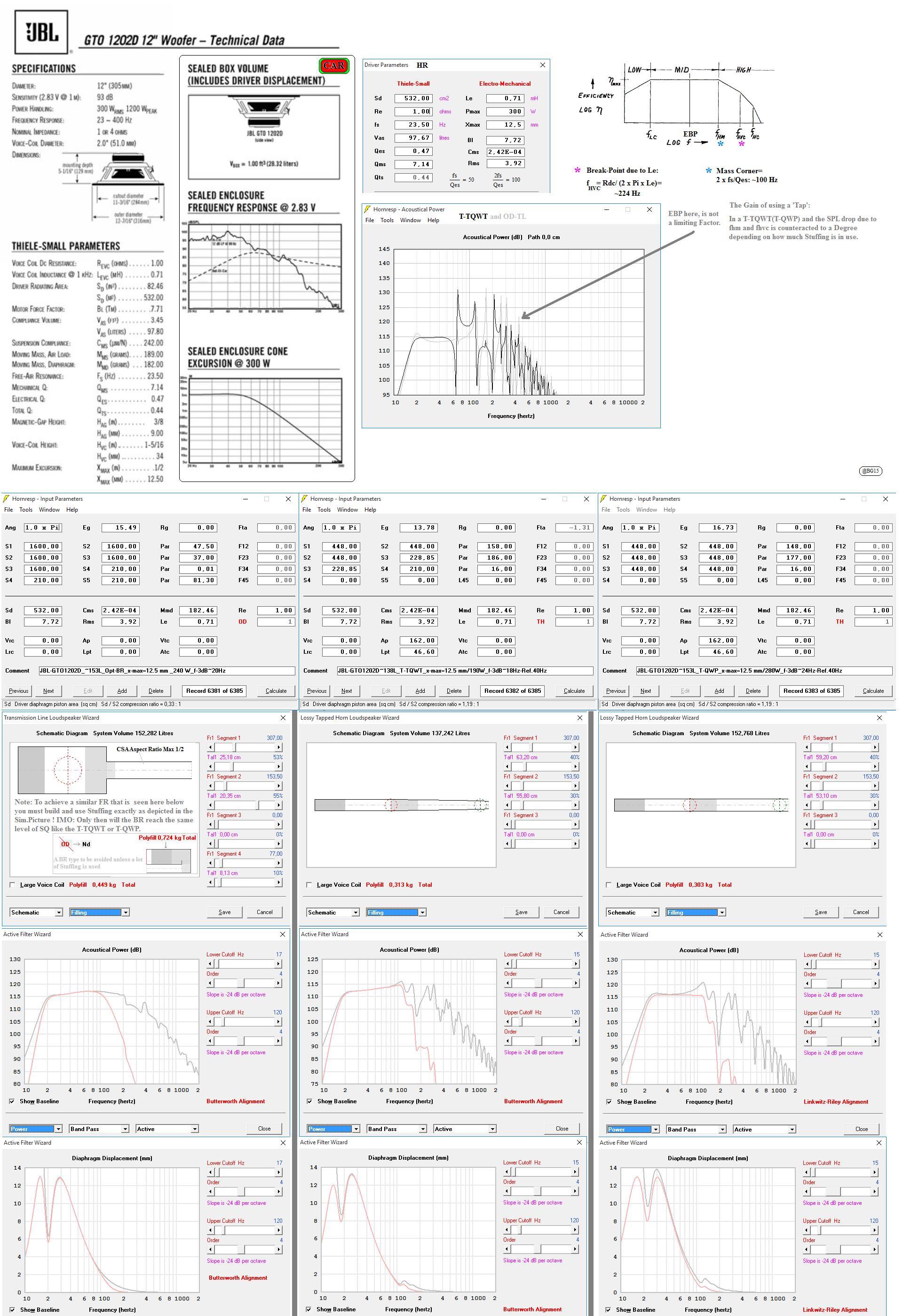

Guys there's a spec sheet that's referenced in post 8. It's original from JBL and recommends three box designs. Is the ported one any good. I was thing to use THIER box size and then use Winisd to work out a slot port instead of round. What do you guys think ?
They "optimise" there designs.. For a car enviroment witch has a huge amount of cabin gain. And also need to make them fit in cars. I wouldn't recommend one of there designs.
Ya do some sims.

FYI:
b🙂
