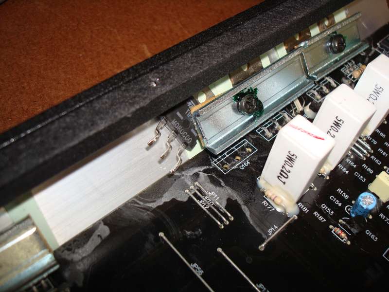

I will take some more measurements like you suggest when I get home tonight and report back. I've attached a pic of the guts for reference. Are you talking about measuring the voltage across the resistors c/t the transistors in the power supply section (these would be the upper and lower left in the pic?

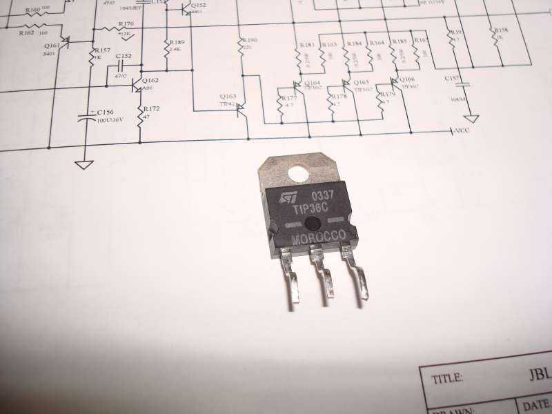

Well, I believe I have the problem figured out. One of the output transistors labeled Q164 on the circuit board which is a TIP36C was shorted between all three legs. I pulled this one out (there are three in parallel) and fired the amp up and it seems to be working fine now, played some light music through it and all was well. Some pics below of the failed part.
Question: Should I just replace this one part, or all three of them as a set? How about the TIP35's on the other side of the board? What else do I need to check on the board with this type of failure? or does the fact that it appears to work fine mean everything else is O.K.

You need to replace all 3. Replace the other 3 at your own discretion. If you're ordering from a distributor that cannot guarantee matched date codes, order at least 5 transistors. Generally, they're pre-packaged in either 1, 5, or 10 piece packages. With singles, you may get 5 different date codes. Having matched date codes helps ensure that the transistors are relatively closely matched (which is needed for good reliability).
Check the base resistor for the failed transistor to make sure that it's within tolerance.

Just wanted to let you all know that I ordered all new output transistors TIP35C and TIP36C just to be safe and installed them the other day, amp seems to be working perfectly. I ordered the components online from Newark, never used them before but I will again they seemed to be very fast shipping and a little cheaper than the others I've used (Digikey, mouser, etc.) all the components had the same date codes as well. Thanks again everyone.
