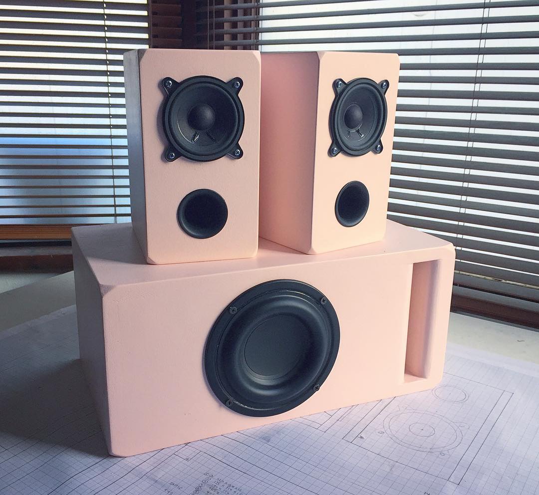

I plan on having two of these and maybe a larger one later for the LFE channel (that one might be ported). I have made several other cabinets recently which have all be slot ported. I'll attach an image of my last project.
If I ran two of the sealed type would it make any difference to perceived low end response?
I have no limits on size but smaller the better to keep the GF happy if I got vented. I have made slot ports before, as i say, but maybe a round tube port would be better for size?
I want punchy rather than low and my room seems to give a fair amount of whoomff to the low end that I find difficult to correct even with two large roockwool traps on my rear wall (again, girlfriend isn't happy about these so any further developments need to be considerate, hehehehe)
