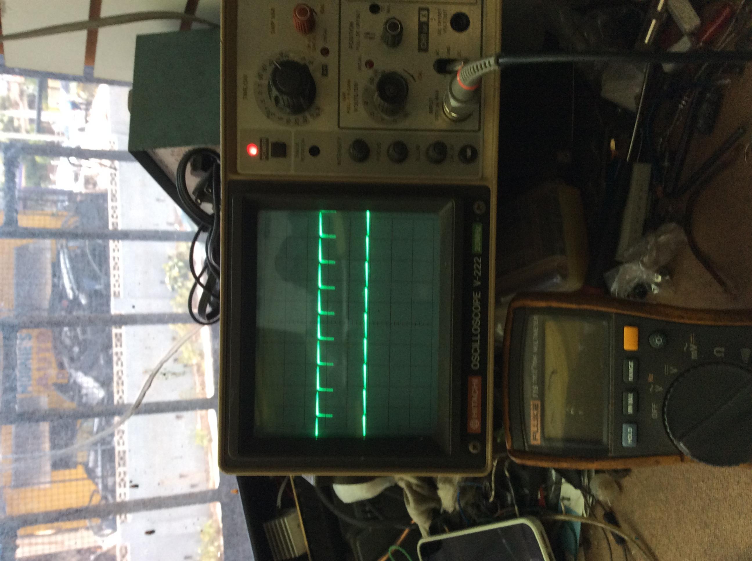

I've add a pic but based on the cycles of the audio wave you may not recognize the pattern based on the music I was playing (I don't have a signal generator to feed a particular audio signal). But voltages as stated is 40+/- on rails but you can see in the pic it's on with bothe power and protection leds, and at this particular photo it's faint, choppy audio.
If there with it for about couple minutes it will come up and play, and play instant if I cycle the power, but if left for a long period then it's this "booting" again before I hear audio.
How do I check for the oscillation, I know with my ground probe on center-tap I'm getting 43.56v on the gate of the output, and almost same on the source the drain is 0.

The rail-rail oscillation will be on the drains of the output transistors.

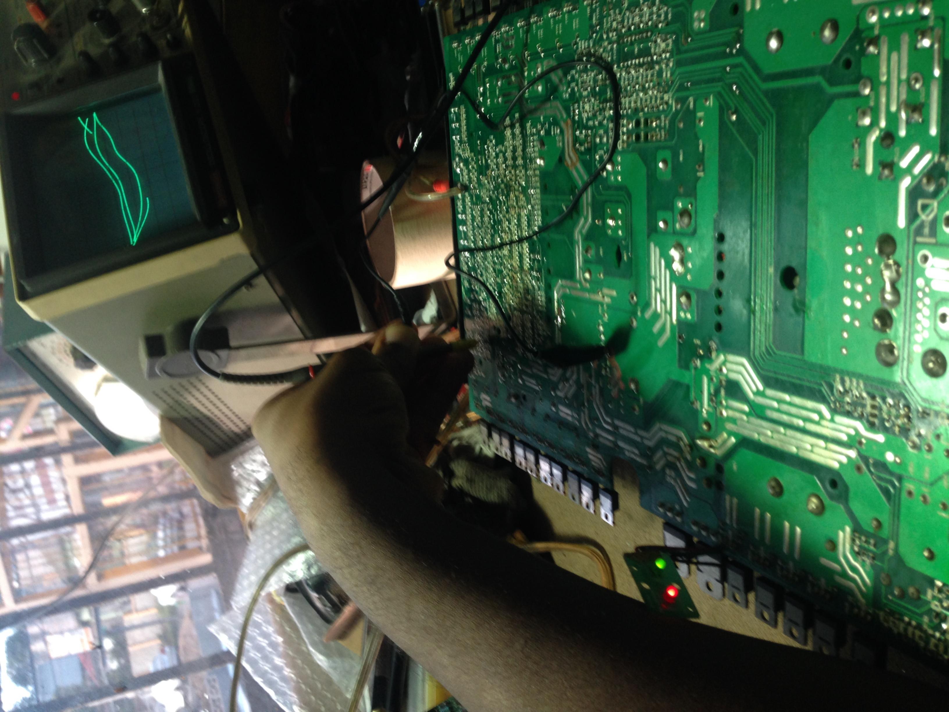

Good evening Mr Babin have read and reread but based on as illustrated it's an hard topic to explain, my thing is what reference point do I ground my probe and what setting do I set to take readings on my o scope?

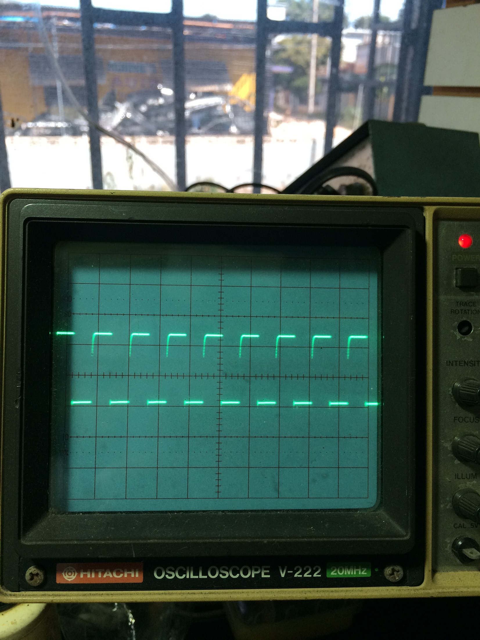

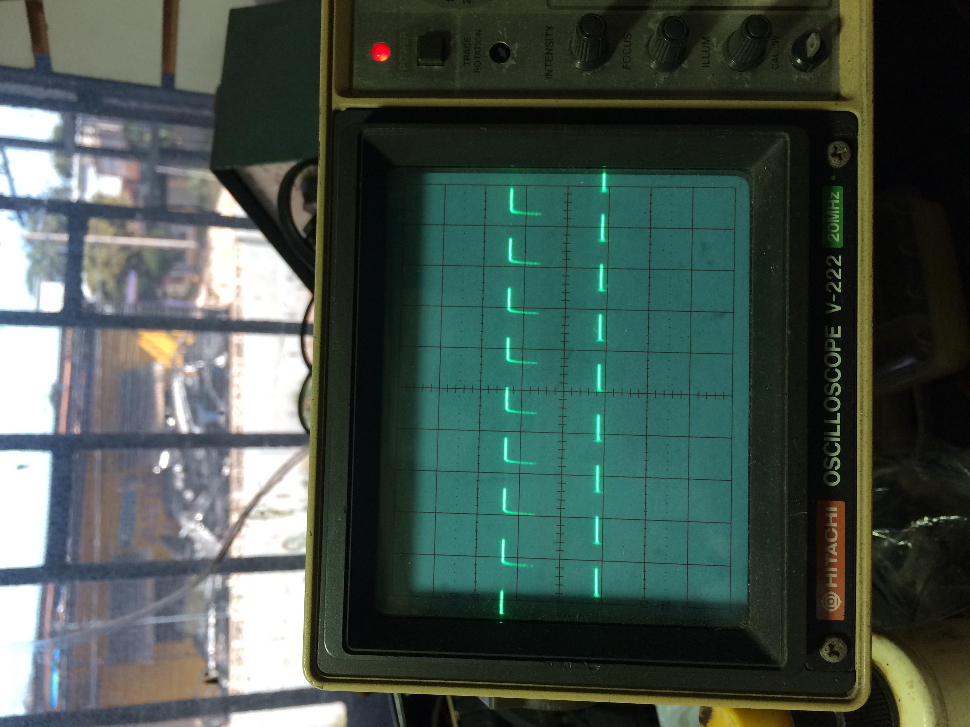

The scope ground can be connected to the 12v power supply ground for virtually every test.
Start with 10us and 20v/div
To prevent it from functioning normally, place the probe, then power up just long enough to see the waveform (or lack of waveform) then power it down.

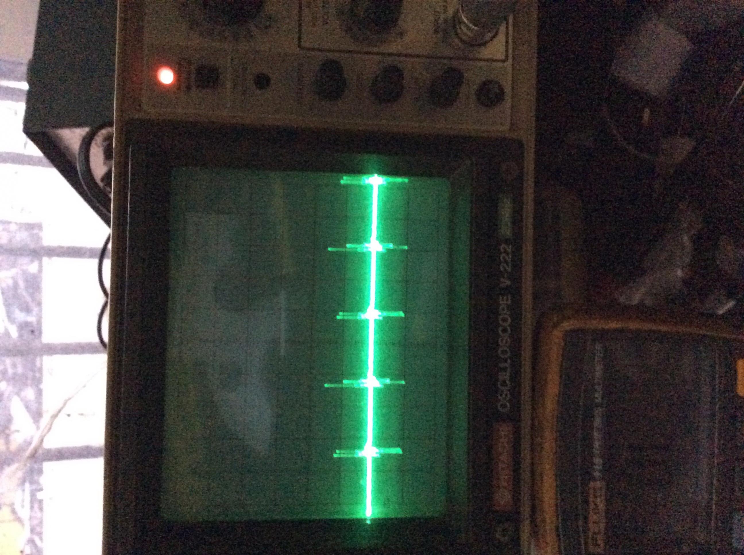

Were both traces aligned to the center reference before you connected the probes?
Is the scope set to DC coupling?
What's the vertical amp setting?
Connect pin 3 of U108 to the negative terminal of C178 with a jumper wire.
What do you get on pins 9 and 11? (two different photos)
U105 is the most likely suspect. Post the DC voltage on all of its terminals if that's easier than replacing it.
