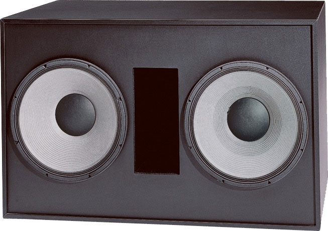

I have 2 jbl 2245H and I´m thinking of building a monster subwoofer. I have found the JBL 4842 and I like the specs. Now the problem is I don´t have any drawings.
Does any friendly soul out there have one or perhaps an idea where to find one?

I don't have the Cabinet C4642A plans. Dimensions are given, construction looks basic. For gigs, the C4642A weighs over 200 lbs.
For home audio I always favor a pair of separate stereo woofers over a single double-speaker box. Stereo woofers improve the full stereo image.
1) JAES papers report that the listener can pick out the physical location of a bass speaker down to 60Hz. So a single box woofer would need to Xover at <60Hz.
2) Two physically separated woofers will smooth out the room modes. You can equalize a single impulse at the listener, but you cannot equalize room modes just smooth them out through use of multiple woofers carefully placed around the room.
If you want to build a single double-speaker box, it would make sense to orient the drivers to counter balance the moving mass.
Push-Pull-Slot-Loaded woofers (PPSL) have counter balanced moving mass and drive their air into a center single slot which has been reported to generate greater dynamics than standard push-pull woofers that drive their air into open opposite ends.
For home audio, sealed woofers are easier to equalize than ported, and also have a 6db/octave natural roll-off slope that is a closer match to most room gain effects.
The Altec Heritage forum recommends designing a modern enclosure for the 2245H with improved bracing, improved port placement, improved wide radius ports, and a lower bass tuning for home audio. They comment that most of the Altec cabinets were designed for movie theater efficiency over home audio deep bass.
Cabinet C4642A uses the newer port.

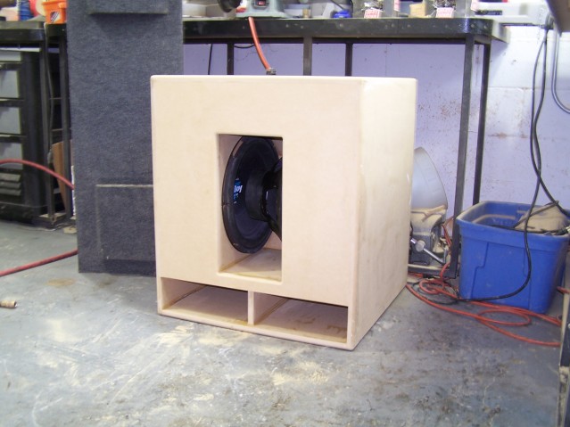

Bjorno and tip
Thanks Bjorno!
I´m afraid the construction is not conveniant for my room although it would be cool to have 😉
Thanks again!
