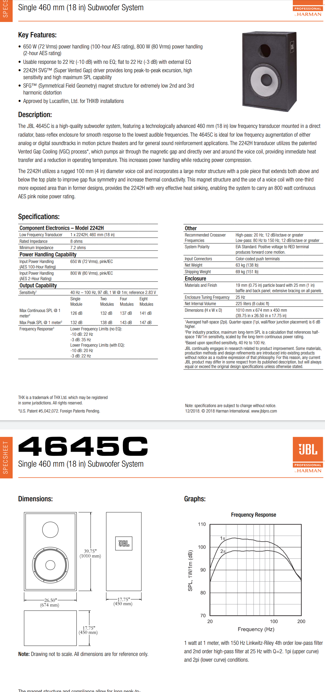

I got jbl 4645c subwoofer for free. 18" driver pro audio. Well actually got paid 400$ to clean out a storage room which had 2000$ worth of quickly sellable merchandise(this story should top those stupid stories " found 2000$ McIntosh at thrift shop for 10$")
Not sure I want to keep the sub but will there be any issue powering it with spa 500dsp.
Jbl recommends 1200 watt pro audio amp. I don't plan on blasting music loud. Just want to try the thing.
I attached spec sheets. Don't like to blow and damage things.
I appreciate feedbacks

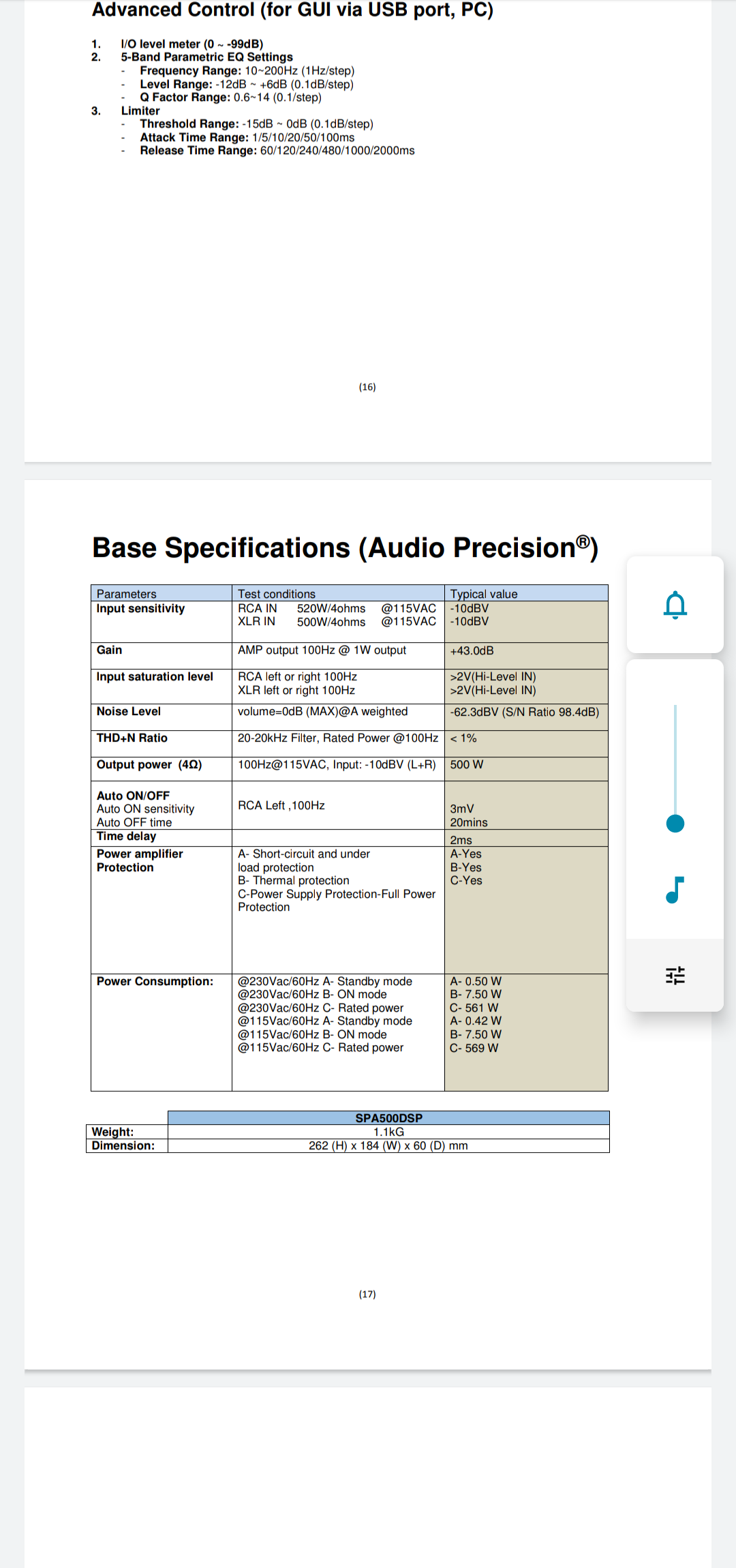

Dayton 500dsp seems to be around 230-260watts at 8ohms. I called Dayton once to find out power rating at 8ohm as they don't provide it. Only 500w at 4ohm

If you got the amp try it out, you won't hurt the driver even if you were to clip the amp... which probably isn't possible given it has a limiter built-in. Be sure to check the DSP settings to see if the limiter is enabled.
Spoke with parts express they said there is a limiter circuit that prevents the amp to be over driven. Not exactly a clipping indicator but a circuit that prevents the amp from damaging itself. That's all they said..

Conventionally, an amp driven to square wave levels of clipping produces 2x its unclipped, rated power, assuming no interference from limiters etc and no collapse of the power supply.
That would be 500(ish) Watts in your case.
The 2242 driver in that cabinet can take 650W average for 100 hours continuously, 800W average for 2 hours or an implied 3200W for very short term peaks, though that would assume that power were being applied at frequencies where excursion was well under control.
Basically, your amp isn't big enough to do real damage to the driver.
If you do manage to find a frequency where excursion is not well controlled and dump the entire output of that amp onto it at that frequency, you'll almost certainly hear excessive distortion before being near to damaging it.
Do use the recommended HPF though, as otherwise you might damage the driver with less than full power if you fed it high power content below its tuning frequency.

I powered the sub with spa500 dsp
Spa500 needs higher line lever voltage than what vintage 80 receivers output from pre-out. I usually use headphone output when feeding signal to spa500
Forgot to grab 1/4” to 3.5mm adapter and used preouts.
Volume was set to max on spa500. Hpf was 44hz and using the sharpest Cross over slope
Limiter light came on when playing loud(1130oclock on 40wpc denon receiver ). 2-3 min till I noticed. U think everything ok with the amp? No damage. It plays fine . Was cold to touch even when red limiter light came on
Need to try feeding higher voltage from headphones jack tomorrow
I tested the sub in big warehouse. I don't think I will ever come to these volume levels at home. It's amazing how small plate amp can power this huge subwoofer

No you didn't hurt anything. The beauty of integrated DSP processing like this is it makes the plate amp virtually bulletproof.. no amount of abuse will cause damage. I do pro sound for a living and in that application I see systems pushed into the limiters for hours on end.. with no damage to anything, amps and speakers get warm or even hot in some cases but everything lives to play another day.
Thanks again. Really appreciate. I can sleep without nightmares about damaged amplifier. Perfect timing
