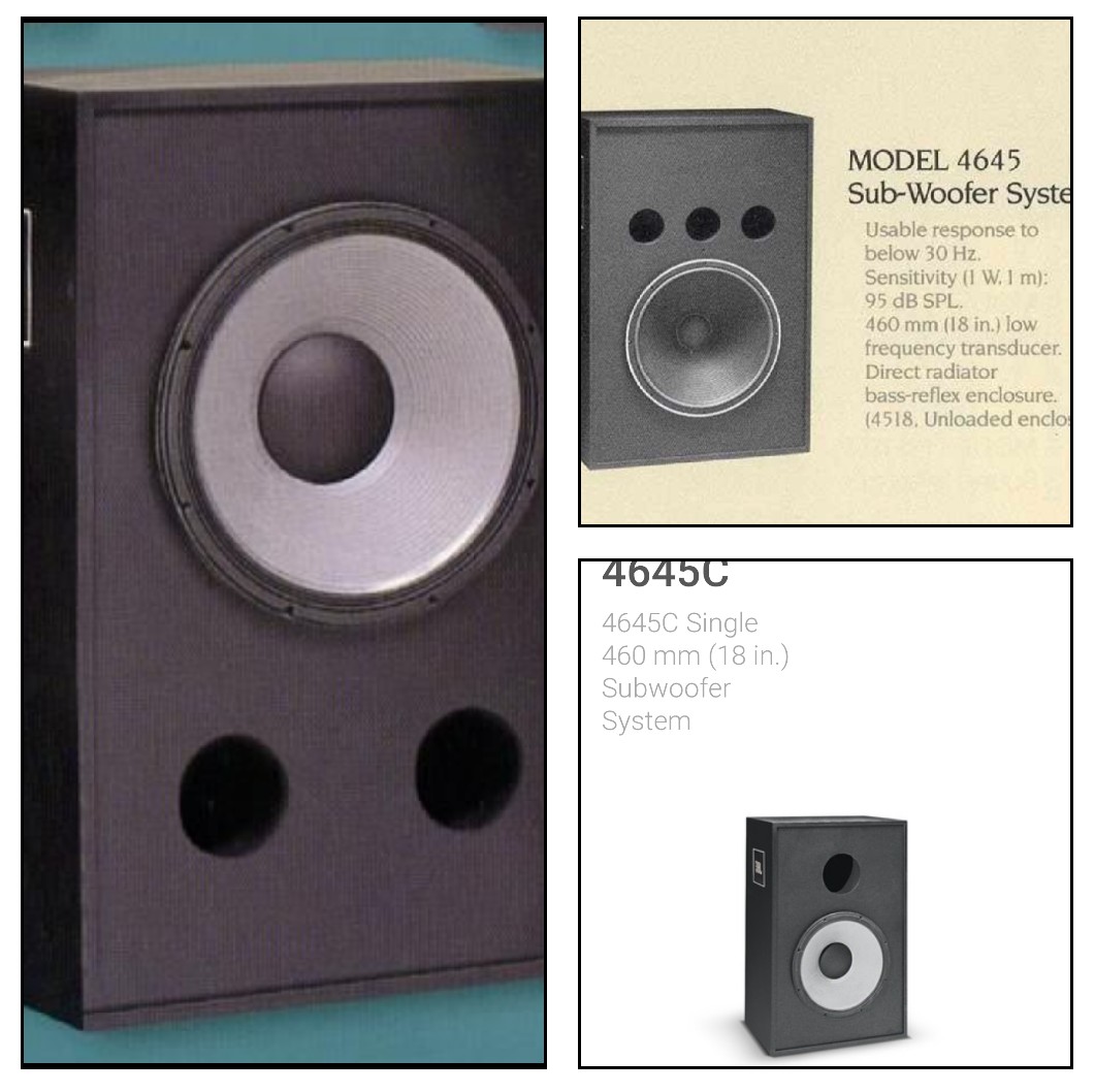

All,
Would it be an option / good idea to put a different woofer in the 4645 ?
More output, more Xmax etc ?

Do you mean the novel JBL 2242H (JBL 4645C and B) or the classic 2245H (with 3 vents).
Do you need a new driver?
Its a vented box tuned to that driver, anything else needs retuning ( new vents) , so leave it alone
The 2269 is virtually a drop in replacement.All,
