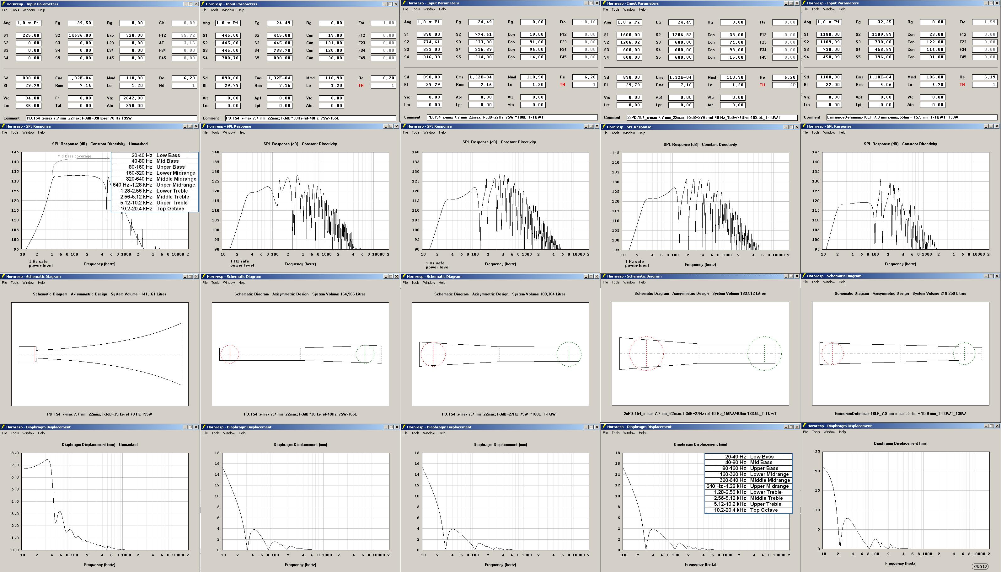

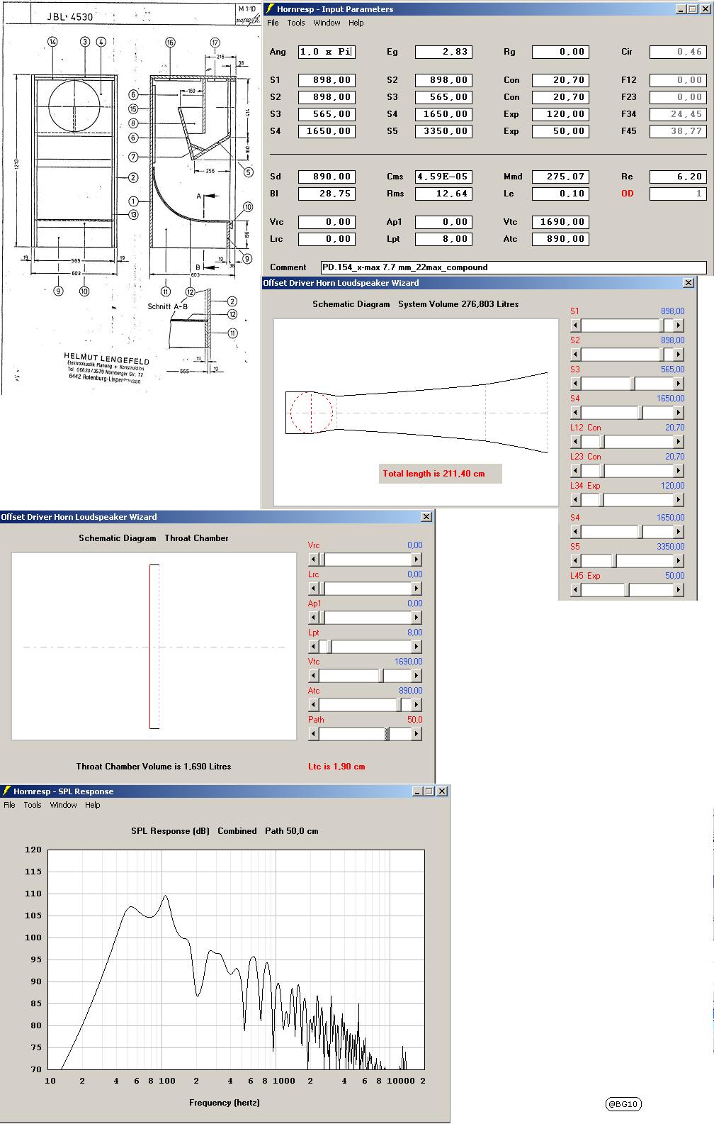

..No deep bass out of a 4530, it's too short..
Agree, See the quick ‘clone’ simulation= Picture (1) and the picture (2) where the PD.154 driver is used too for bass but IMO a sub bas should have at least similar performance to the in picture shown Eminence-Definimax-18LF driver.
b
@bjorno; not only PD154 data, your other calculations are way off too.. (VTC, ATC, S1, horn lenght..!?)

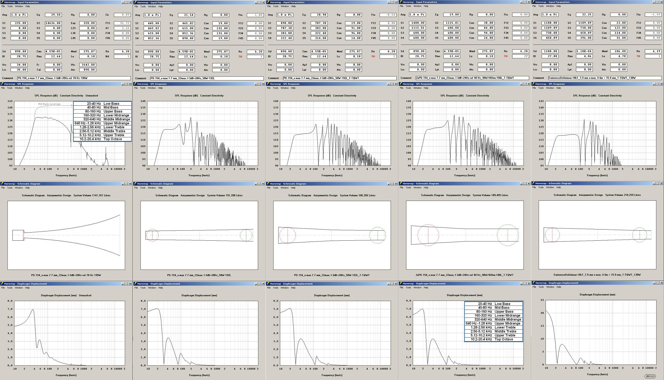

Here are the revised pictures (correcting the T/S data):..
My ‘bad’ PD.154 data was consistent with the larger than in reality Mms that only scaled down the SPL not the performance more than marginally.
I choose the OD template because the picture I submitted of the original depicts an offset driver and not uniquely a separate compliance chamber.
The first smallest CSA radius at the very first bend is about 10 cm i.e. the CSA would be 10 x 56.5 = 565 cm but starts shrinking conically from the CSA=16.8 x 56.5= 898 cm^3: (21.6-3.8-1.9 = 16.8) cm).
The more sections and CSA’s the (OD) horn uses, is IMO more closer to the original than a perfect exp expansion but you may have followed your own simulation very closely but that’s completely another issue.
b
Did you used the tool option "combined response" from the cone and the horn mouth ? It sims like not. The dip in SPL in reality appears between 150-160Hz like in my simulation and not at 400 hz. Compression chamber has a 34 liter and not 1,69 liter. 4530 it's a rear loaded horn.
