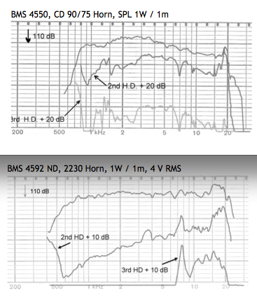

The Beyma looks like a great option as well. However I wonder how it measures. One thing that sold me on the BMS is the great distortion measurements that you can see here:

The BMS coax seems no smoother in the top end than the 1", they both use the same diaphragm diameter. The HF peak in the 4550 is at 18 kHz, and can be easily flattened with EQ, though it is 2000 Hz above what I can hear...
There are compelling arguments for 90 x 40 and symmetrical OS, though the shorter vertical height would tend to tip me towards 90 x 40 because the acoustic center of the center speaker would be closer to the TV screen.

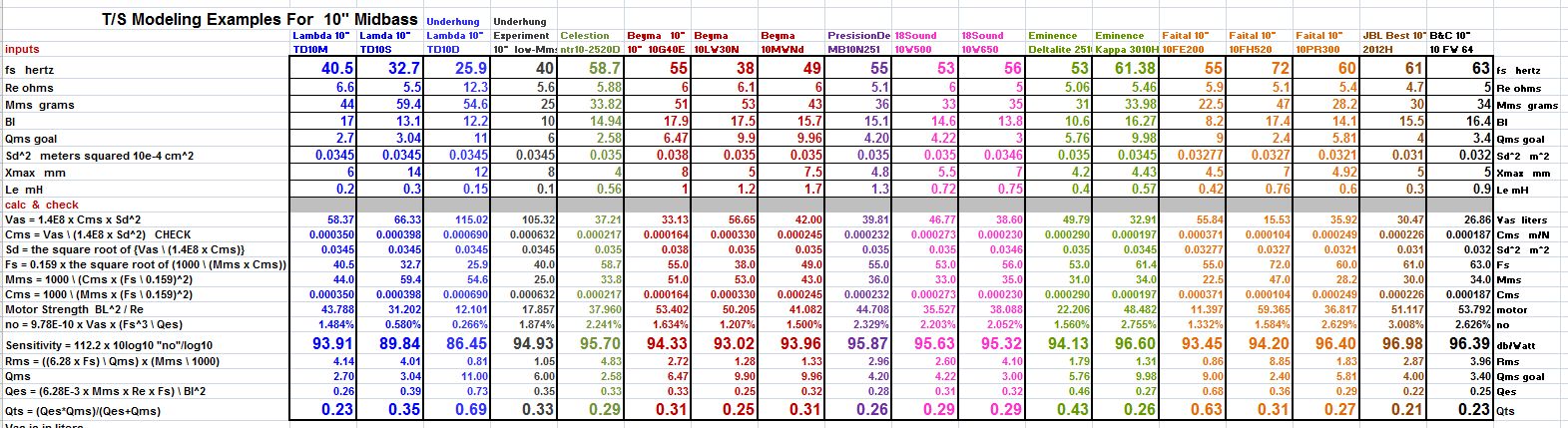

When you consider 10" midbass alternatives try to avoid nasty cone break-up, and rapid beaming from poor cone shapes and dust caps to at least 2.4Khz. The EconoWave threads have extensive measurements, analysis, and Xover work to save time and get the best design. A 10" or 12" midbass can cover most of the 80-1,100Hz human vocal range with a smooth controlled directivity function.
