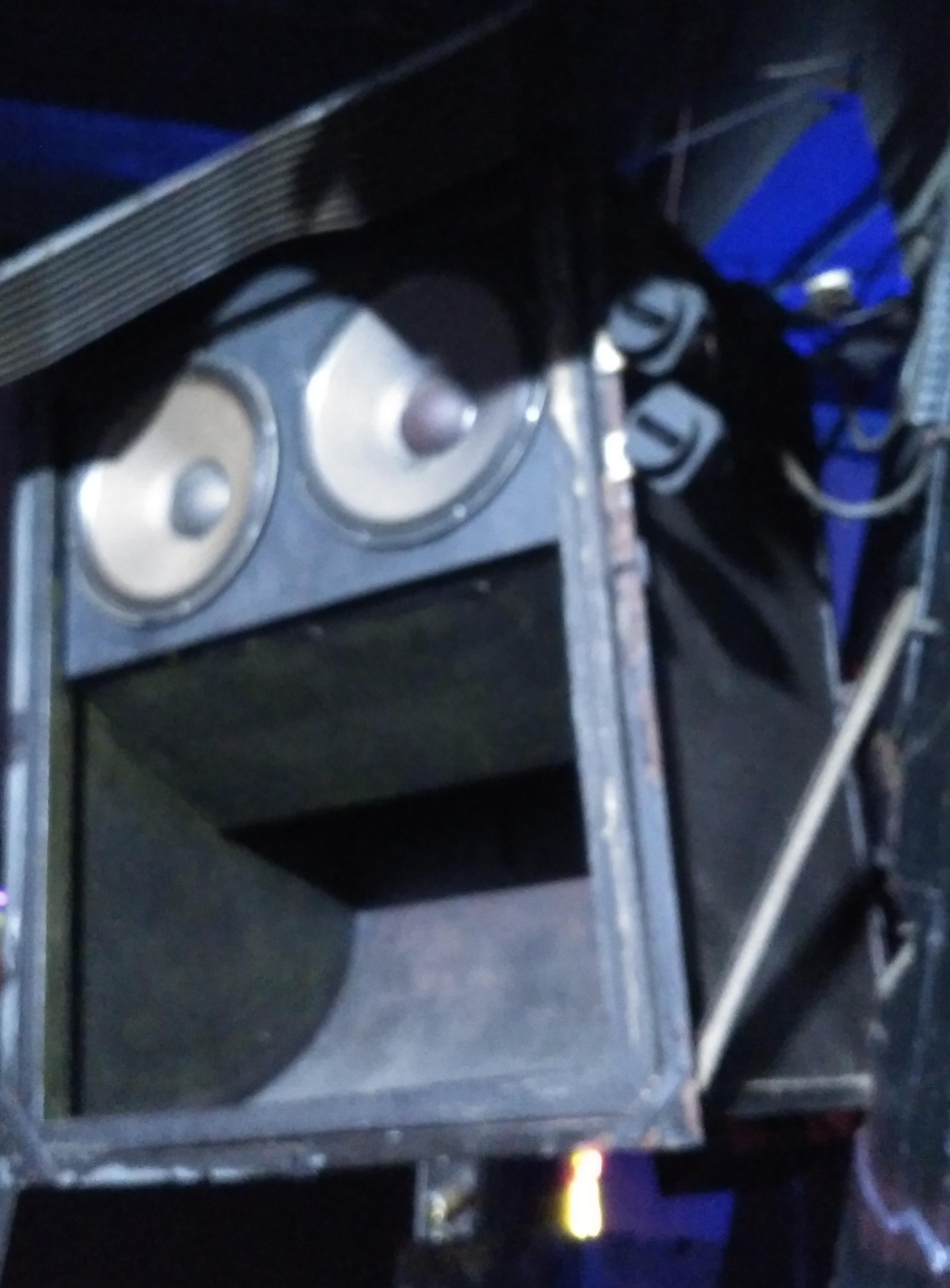

4 JBL speakers with 2 tweeters each on the side. 2x Speakers with (4x) JBL 2402H - and another pair with (4x) 2405H, totaling 8 High Frequency Transducers. Generated sound pressure level (SPL on paper) ~122 dB @5 meters x4 speakers 150W (+2 subs on the dance floor) ~107.5 dB/W/m (1W, 1meter).

they are BIG! (pictures taken today)😀😀😀
