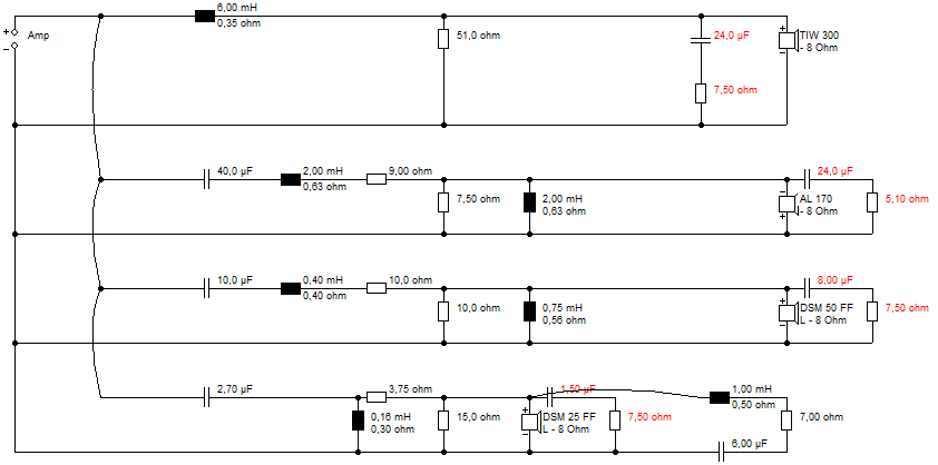

I wanted to share with you something I found. It's the schematic of the aesthetically pleasing, but not terribly well received JBL 250 Ti:
What I wanted to point out to you in particular is the extreme use of bypass caps in the crossover design. We may laugh at this now, but as the title of the thread says, this was considered the very height of audio design fussiness. 🙂 Notice the repeated use of 0.01 uF AND 0.0055 uF to bypass most caps. The idea was that the smaller uF, the less likely it was to be inductive, and that you could build a nearly perfect cap this way.

I simplified it to default settings and took out the bypass caps. Not much to it, really! 😀
I marked impedance correction in red. The little LCR network on the supertweeter is a shallow 2kHz notch. I am guessing the mid marked MF is a 4 ohm unit. I think I got polarity wrong on the supertweeter, but you get the point, I think. Thanks for that, Erik.
I can only make a case for a bypass cap on the tweeter section really, if Radio Frequency interference was a worry.

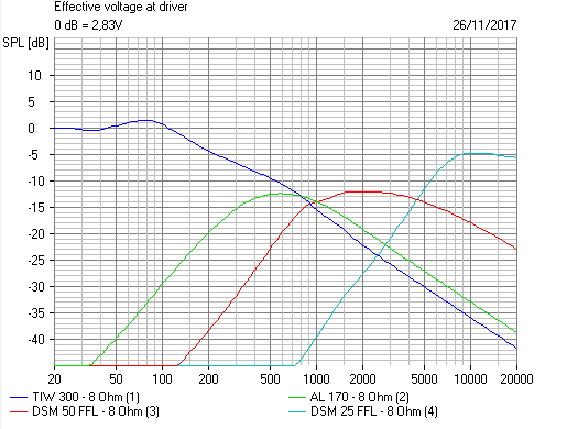

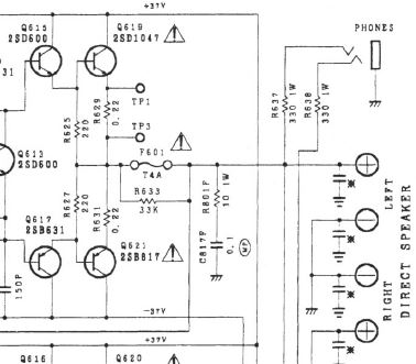

Happily most audio amps have a 10R/0.1uF metal oxide/MKT Zobel at the output to keep stable around 100kHz with varied load conditions, even no load at all. Because it is quite possible for a speaker cable to behave like an antenna.

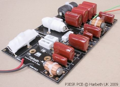

Interestingly, Harbeth use pure MKT and even ferrite coils on tweeter circuits. Must sound rubbish! 😉
Which they don't, as most people acknowledge. They make some of my favourite reasonably sized commercial speakers. That does not mean however that Alan's design choices must be blindly followed in every circumstance.
