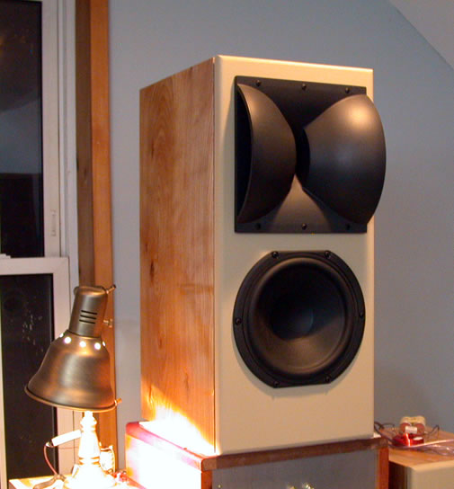

Unlike the original JBL4425 which had a JBL2416 compression driver, my JBL2342 horn is coupled to the JBL2425. And instead of a 12" woofer, I decided on an 8" Peerless 830869. This of course negates the essence of the JBL4425 which features physical alignment of the woofer and compression driver centers in the vertical plane. This is not an attempt to clone the JBL4425 but rather to examine the sonic performance of the horn combo with newer, modern woofers.
The 8" Peerless is chosen for it's extended range. Presently, the system is actively crossed at 2KHz (18dB/oct) with the Synergies. Passive components are used to voice the response.

Overall, quite impressive. I like the JBL2342+JBL2425 combo. Smooth, no typical Titanium brightness. The Peerless 830869 is surprising. Though I loath crossing 8" at 2KHz, I'm able to do it and yet retain the vocals with this Peerless. And it goes down to 40Hz too. It'll be interesting to cross this woofer with a Dome tweeter at 2KHz. I'll leave that for another day.
I will attempt to cross the Horn lower later. The JBL4425 was crossed at 1.2KHz. At this frequency, it would not be a problem to replace the 8" with a 10". A good excuse for a future project. 🙂

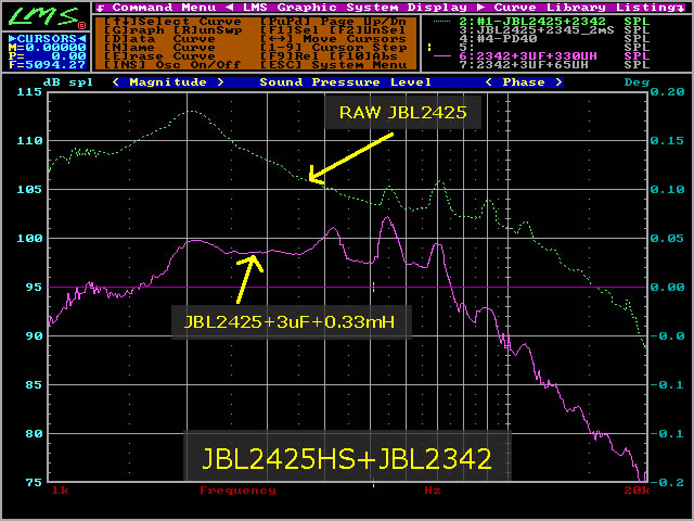

Take this JBL2342 for example. According to the JBL4425 specs, it is crossed at 1.2KHz. But when I swept the horn, there's this peak at 2KHz. From 2K to 15K, the slope is quite linear at about 6dB/oct. However, on the left of the 2KHz, the horn seems to be dying off. If one is to cross below 2KHz, like 1.2KHz, wouldn't the peak present a problem. Seems that it's common to cross before the peak. Even with the JBL2445, crossing at 500 to 800Hz is still on the slope.

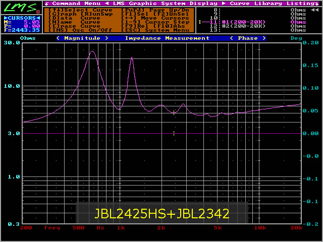

The other issue I have is the impedance, or rather the resonance of the JBL2425 driver. It looks very much like a bass reflex, two peaks with a valley in between. If I am to assume that the valley is indeed the resonance (ie 1KHz), wouldn't crossing at 1.2K be too close.

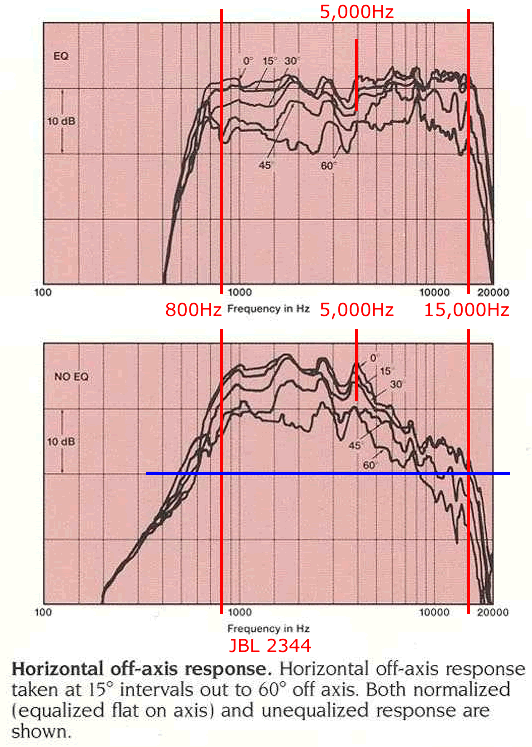

I'm a little unsure about some parts of your measurements. The curve with crossover looks a little unfamiliar and the peak at 2k and overall shape is not as I would expect. I am more familiar with the 2344 horn than the 2342, which is a little smaller, but it doesn't look quite right. Another odd detail is a narrow peak at 4200 Hz which is fairly prominant in the curve with network and not there at all in the curve without network, so I wonder if the measurements are totally accurate.
The peaks are related to the length and cuttoff frequency of the horn. Being finite in length it behaves a little like a resonant column with some resonance harmonics. That causes the 2k, 4k, 5.5k, 9k peaks. Those are also slightly visible in the impedance curve. Although the first 2 impedance peaks are stronger and look like the peaks of a bass reflex cabinet, it certainly isn't bass reflex! I believe they are a combination of the compression driver parameters and, again, the horn length. If the compression driver were tested into a terminated tube (effectively a long damped pipe representing and infinite horn, then a single large resonance around 1k would be seen in the impedance curve.
So maybe try to re-do your response curves and see if a more plausible curve results. You might look here for what the curves of the big brother (2344) looks like.

Sorry for the confusion. The plots are not very accurate in the sense that they were not conducted in an anechoic chamber nor was the JBL2432 mounted on a standard IEC baffle. In fact, the horn was simply placed atop my subwoofer test box in my lab, about 1 m above the ground. Once I know what the response looks like, it's easier to work. Otherwise, I'll going round in circles trying to figure out where the problems are.
The lower graph, where I had the 3uF+0.33mH is a quick attempt to EQ the response flat. Presently, the horn is crossed actively with my Bi-amp crossover kit at 18dB/oct. For a start, I'm crossing at 2K. I'm aware it's rather silly using the JBL2342 as a tweeter but at this frequency, it allows me to evaluate the Peerless's performance.

You are quite right. The impedance sweep was done with the JBL2425 coupled to the JBL2342 horn.Although the first 2 impedance peaks are stronger and look like the peaks of a bass reflex cabinet, it certainly isn't bass reflex! I believe they are a combination of the compression driver parameters and, again, the horn length. If the compression driver were tested into a terminated tube (effectively a long damped pipe representing and infinite horn, then a single large resonance around 1k would be seen in the impedance curve.
For a network I wouldn't add an inductor as you are losing bandwidth with it. You probably have some excess sensitivity so you might try a series resisitor to pad down sensitivity and a small value capacitor around (bypassing) that R to let the top octave come up some. This would be a passive approach to "CD horn compensation".
I will definitely try this CD HORN EQ, a capacitor with a resistor in parallel. I had the inductor there because I plan to cross the horn to a super tweeter at about 7KHz. A bit of an overkill, knowing full well that the JBL2432 can go up to 15K.
With regards to the JBL2344, the lower plot, where that's no EQ, 800Hz is on the downslope of the horn. Typically with a dome tweeter, I will avoid crossing where the tweeter is dying off. However with horns, it's common to cross like that. I'm aware that 800Hz is not where the horn unloads. Would it be better, sonically, to cross the JBL2344 at 1K to 1.2K instead.
Also, it appears that if passive EQ is used, I'm looking at sacrificing about 18dB of sensitivity for a flat response. Not that it matters in hi-fi. Just curious.

We crossed the 2344 at 1000. The 2342, being a little smaller would make sense at 1200Hz. The exact crossover point is always a somewhat arbitrary tradeoff between the exact frequency response of the two units and the power handling you need. That is, there are frequently bumps in response that make a particular crossover point a little better than the next. Obviously, higher crossover points will reduce diaphragm excursion and help power handling but, if you have modest requirements for absolute output, you can push the boundaries a little. Having a 3rd order active crossover also helps in that regard.With regards to the JBL2344, the lower plot, where that's no EQ, 800Hz is on the downslope of the horn. Typically with a dome tweeter, I will avoid crossing where the tweeter is dying off. However with horns, it's common to cross like that. I'm aware that 800Hz is not where the horn unloads. Would it be better, sonically, to cross the JBL2344 at 1K to 1.2K instead.

That is true. In a passive network you are "throwing away" the excess sensitivity to flatten the system. Of course, a power handling benefit acrues in that the system will absorb a lot of watts a the those lower horn frequencies. Most of it is wasted in the network but you won't be blowing the compression driver.
In the 4430 and 4435 systems we aimed for 93 and 96dB system sensitivites, respectively, and had just enough raw sensitivity at 15kHz to hit that.
In an active system you can use active EQ and retain the full sensitivity, very few watts would be consumed from 1000 to 5000 or so. It probably wouldn't mean much in terms of total output on real music, unless you wanted to use a low power amp for the horn (say, a single ended triamp for that section).
