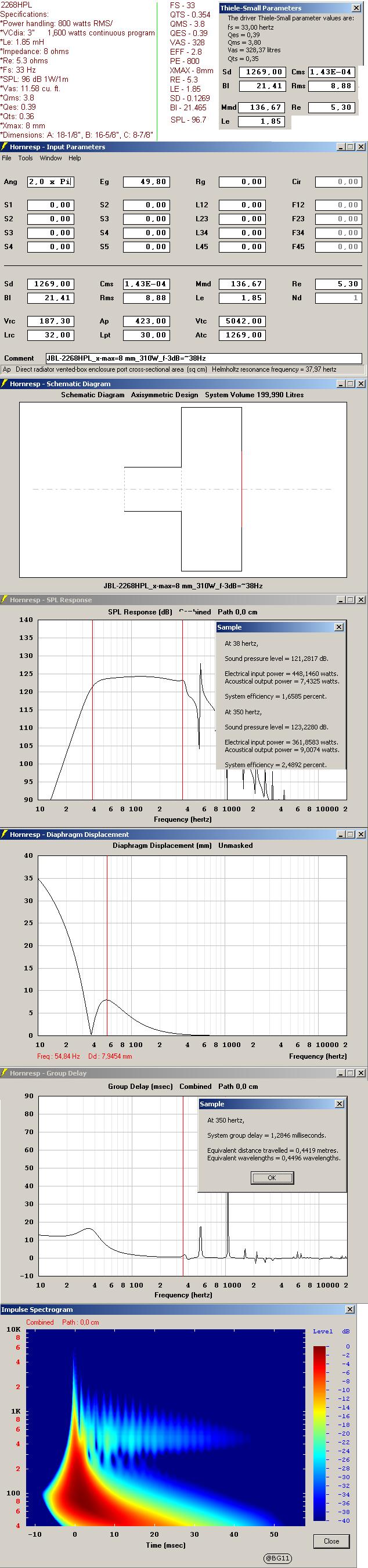

..lower than 200 liters - 7cubic foot) properly optimized.
Here is a possible suggestion that uses a net volume of less than 200L and a baffle thickness of 36 mm: The picture.
Tweak this HR sim. further to suit your requirements!

Bjorno,
Thanks a lot! for all that simulations. The results seem nice.
If I understand well the project is a 200L /38Hz Bass Reflex? I am not so sure looking at the schematic diagram.
How can we explain the behavior above 500Hz?

Hi Masillia,
Don't worry about the dips and peaks:
They are artifacts from the fact that the box when empty,was simulated without any damping materials.
To cure: Line the rear internal wall with a suitable layer of foam or a sheath of polyester and the ripple will in practice disappear...
As the simulation shows, you will reach 350 Hz without flaws but this depends on your box internal layout as you will reach the speaker driver mass-corner when at ~170 Hz where the FR starts sloping.

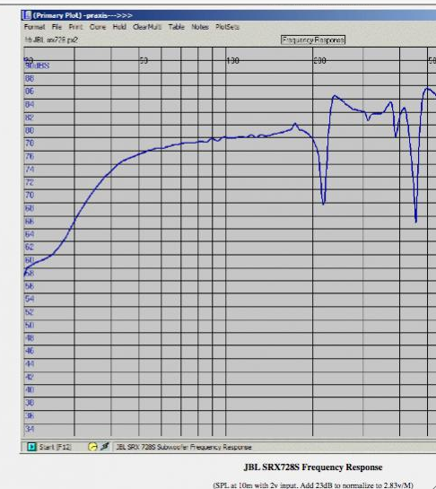

The 2268H is quite flat in the upper response:
2268H
In testing the SRX 728, which uses the 2268H I found there was a big peak/dip around 230 Hz, probably from the port.
The spec sheet graph stops before that point ;^).

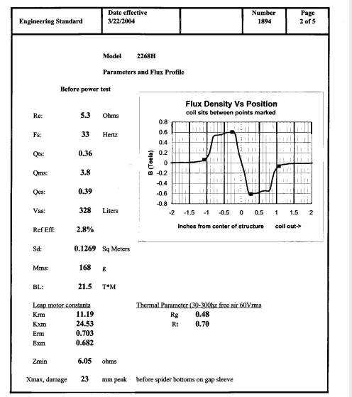

bjorno, the JBL specs I found wrongly put the Xlim of 23mm as the Xmax figure. where did you find the Xmax of 8mm for the 2268HPL?
Are the parameters different for the 2268HPL than for the 2268H ?

Massilia,
The JBL TS parameters that you referenced are the ones that show the Xlim of 23 mm as the Xmax figure, bjorno used 8 mm as Xmax, which sounds right, though I’d like to see the source, as I have seen many discussions speculating as to what the actual Xmax is, usually guessing about 11 mm.
My actual experience with the SRX 728 was setting up a DBX DriveRackPA for a DJ using pink noise and Smaart. I did not get to listen to it with actual music, but the 728 and the 718 are well regarded for subs in their price range.
My test had filters engaged, so it does not show the upper range, the graph below from one of Wayne Parham’s sub shootouts shows the port artifacts better than my test, and the LF rolloff looks very much the same in both my test, Wayne's and the JBL published graph. Since the port artifacts are narrow dips, rather than peaks, they should not be very noticeable.
As you can see, the present tuning of the 738 looks to be just below 50 Hz, I would suggest lengthening the ducts to tune the Fb down around 38 Hz, which would reduce the 50 Hz “bump” that is “coloring” the sound.
A lower tuning will sound much more “damped”, and be easier to EQ.
Though tuning lower will reduce LF output in the 50 Hz range, the lower, more gradual extension may actually sound “louder”, worth a try before building a separate cabinet, which would disassociate the LF/MF (if you don’t cut the bass portion of the 738 off, ruining it’s resale value), not a good idea with such a high crossover point.

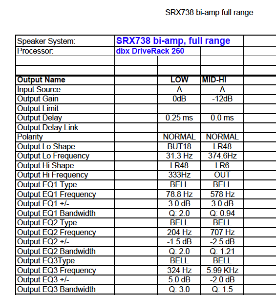

Bruno,
Yes, the 23 mm is Xlim (Xmech) as stated in the bottom of the Engineering Standard #1894 (spider bottoms on gap sleeve), but I have yet to find an official JBL correction or Xmax figure, the Parts Express version of the specs say 8 mm for Xmax (thanks bjorno).
JBL’s tuning shows a .25 ms delay on the low for the DR 260, I had not looked at it when I wrote my response.
I could understand those tunings sounding quite “off”, they appear to be attempting to correct the (too high) box alignment chosen to help compensate for the 12-15 dB disparity between woofer and mid/high sensitivity. Lowering Fb would help in many ways.
Unfortunately, latency and filter types in different platforms are different, what works on one DSP does not necessarily (or even typically) translate to others.
JBL’s “tunings” were often not very good, it is interesting to hear Vertec users say the V. whatever presets make the box sound completely different and better, implying that the old settings were indeed lousy.
Anyway, the delay null test I outlined will work for any DSP platform and filter choice.
