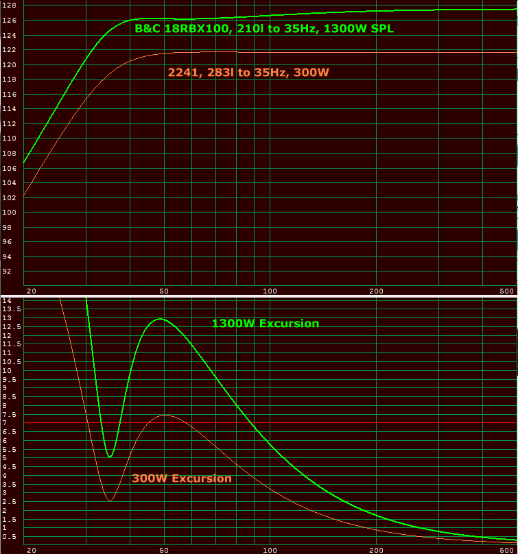

A more modern driver like B&C's 18RBX100 will be able to get louder over the same frequency range in a smaller box, but will need more power to do it. The port will also have to be bigger to support that extra SPL.
Note these sims assume that small signal behaviour scales up linearly with power - it doesn't, so the exact shape of the response and max SPL will be a bit different than predicted here. The relative difference between the 2 drivers should be broadly proportional all the same.
