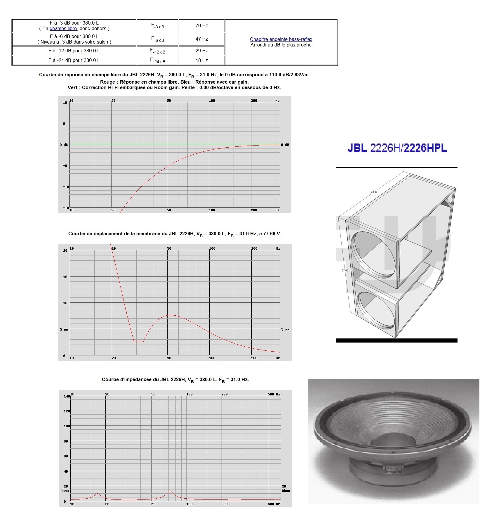

Guys I've got my project for my 4 JBL 2226HPL the total output impedance for the four will be 2 ohms. My JBL amp is 2,400 watts rms @ 2 ohms and also see my box design and let me know what you think on my project. Regards guys

Your speaker is tuned very low (~30/32Hz) with a very long port what is good for the excursion protection.
https://www.jblpro.com/pages/pub/components/2226.pdf
Port 4.2" x 15" x 20" (*)
Internal Total for 2 drivers
27.4" x 34.4" x 15" = 231.7 L / 8.18 ft³
Net - Port - Drivers - Angles
231 L - 24 L - 12 L - 5 L = 190 L / 6.7 ft³
*) note: this comments are made with 2 dimensions only (measurements) available by you (pic)
2x JBL 2226HPL
190 L @ 31 Hz
Excursion@25Hz = ~10mm, excursion@20Hz = ~20mm
(this for RMS power@excursion)
Pmin ~2000 W@3 Ohms (2x drivers)
Pmin ~4000 W@1.5 Ohms (4x drivers)
First, there's no need for such a big port (surface/length), and here I didn't check more,
Second, I'm guessing here that your tuning is to low, why? I'm more inclined to the 35Hz and up tuning, again I don't know your design variables/constraints.
Third, this woofer is a 600 W (RMS) driver (8 ohms/Re 5.0 ohms) so your amp seems adequate (+/-) but needs to address the 1.5 ohms without shutting off or you will have to put the two drivers vs. the two speakers in series.
Next pic (#2), what you get with different tuning and port,
2x JBL 2226H, VB = 190.0 L, FB = 35.0 Hz, 104.6 dB2.83Vm 😀

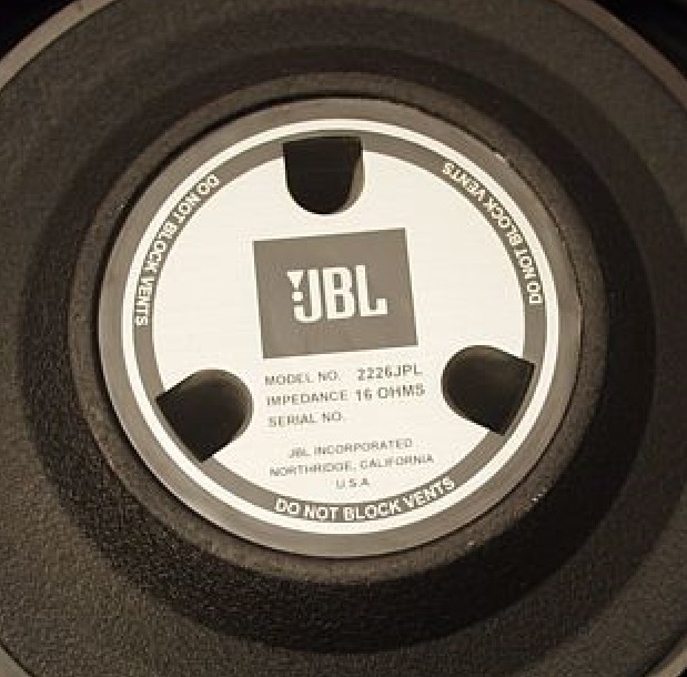

Did you measure the impedance of the driver, isn't it a 16 ohms driver like the JBL 2226J (I don't know, just asking) 😕
They are obtuse (JBL) about the real impedance of speaker and driver.
JBL Thiele/Small Parameters
The JBL 2226HPL can be the same as the JBL 2226H - 8 ohms [Re: 5.0 ohms/Le: 1.75 mH (H)] or the JBL 2226J - 16 ohms [Re: 10.0 ohms/Le: 3.5 mH (J)]. The speakers for the JBL 2226HPL the JBL SR4715 dual 15" sub say in their references that it's 4/5.0 ohms for the 2x drivers meaning if you connect parallel the 2 drivers it will end as a 5 ohm speaker meaning it's a 16 ohms JBL 2226. But the same thing works for a (2x) 8 Ohms paralleled giving a 4 ohms speaker meaning it's a 8 ohms JBL 2226 driver. It can work both ways. 😀

PL in HPL stands for Protector Less, i.e. without rubber protector for the magnet. They are from JBL assembled speakers.
