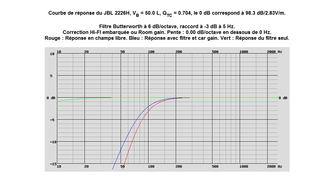

jbl 2226hpl closed box?
What do you expect?!
You don't get nothing lower than 50Hz and F3 will be 90Hz (50L / F12@50 Hz).
Now check a 150L (are you thinking about an extra size enclosure here?) then you have F3=100 Hz but you will have some boosting (necessary) at 30-40-50Hz and equalization or DSP (I just don't use electronic equalization/boost). 50Hz@-10dB in this case (150L) and very low Qtc (QTC < 0.5).
There were excellent designs being made lately for it JBL 2226HPL, why don't you take advantage of it? From what you say you want a tight musical sealed enclosure/speaker. I can post for you one (BR) that will be similar (tight/ideal) with a fair response in frequency, in musical/jazzy terms, this is possible. And this alignment would give you a fair response (sub) usually not used in 3-Way speakers of small dimensions.

That's not certainly a subwoofer as you already guessed, if you insist, a big enclosure say 120L tuned low (32Hz) will give you a better low end.
