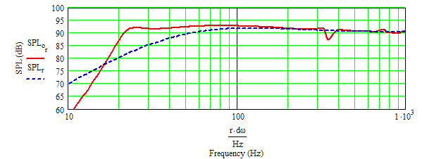

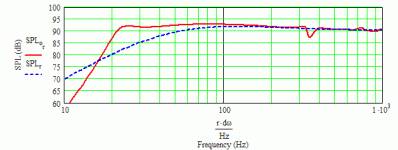

Jaycar 12" T/S
Hi ubza1234,
Maybe your Jaycar Driver is equipped with similar T/S like in this simulation:
b🙂

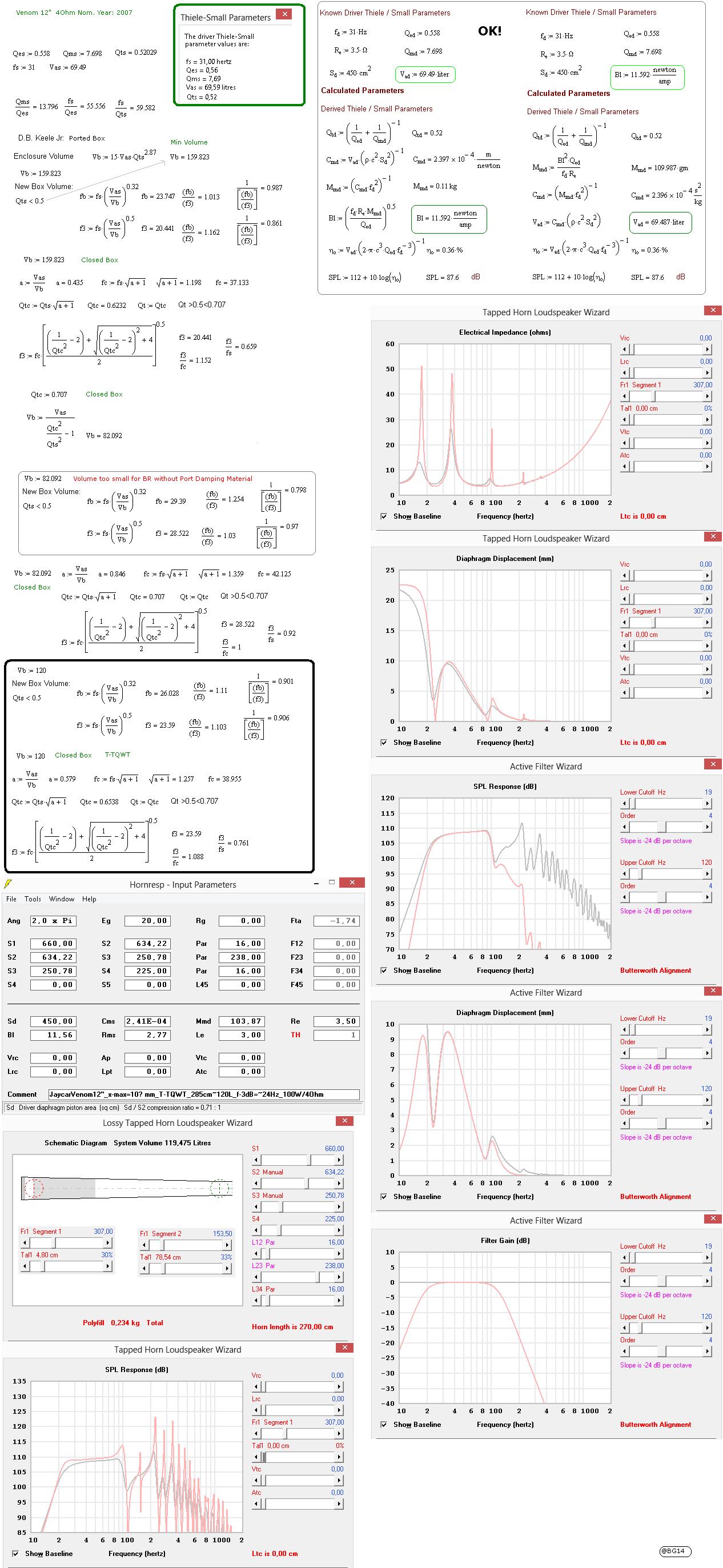

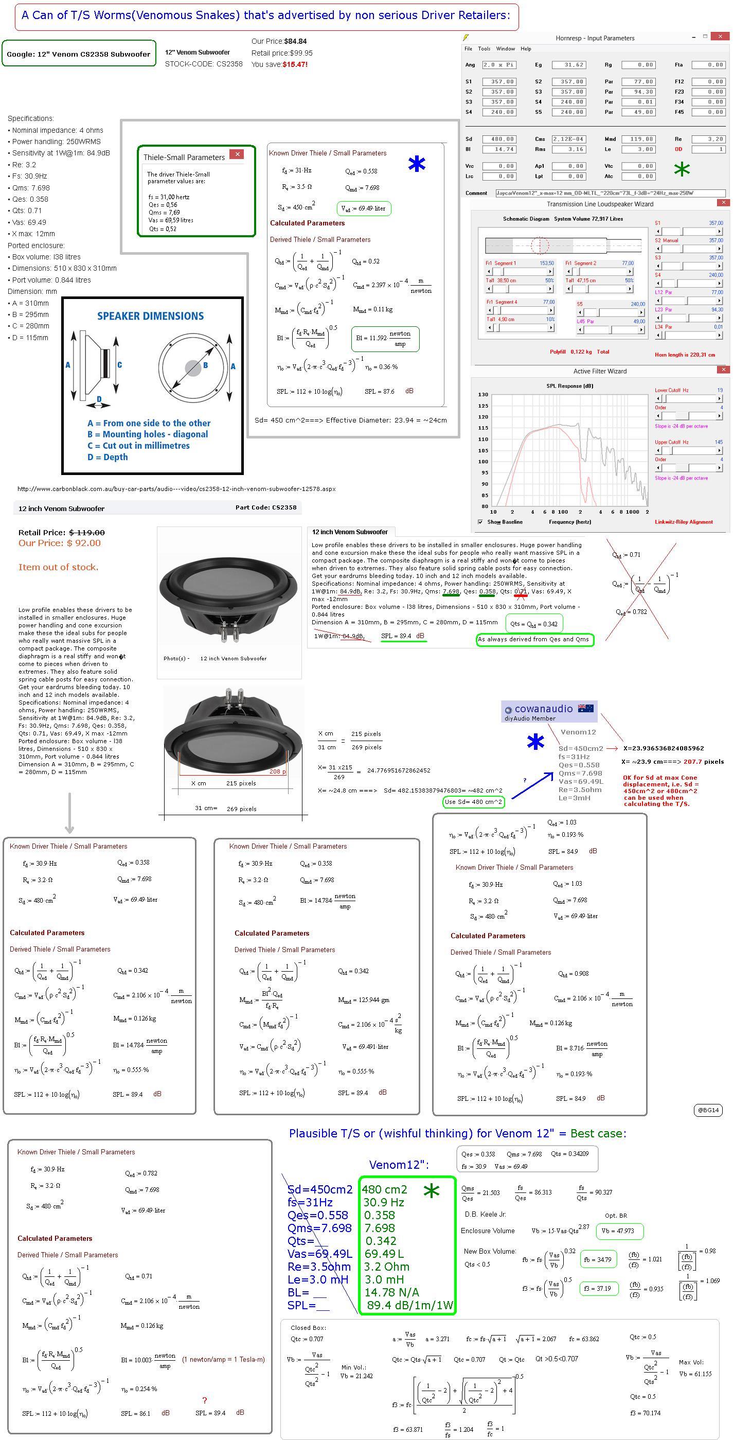

Do you have a Picture of your Venom Driver= a minimal effort is to provide this Forum a clue/hint of what 'Old Venom Driver you possess. You should measure the 'Effective Cone Diameter' and calculate the Cone Area too.
I Googled and found this:
Akabak simulation of a TH using a 12inch Venom CS2358 Sub-woofer Driver:
http://www.diyaudio.com/forums/subw...ative-tapped-horn-project-44.html#post1219484
MR2 AUSTRALIA
JAYCAR CAR Audio - GREAT Quality without the huge pricetag! - Hardtuned.net
Buy a CS2358 12 inch Venom Subwoofer online - Audio / Video | CarbonBlack car parts
The outcome from these Links:Maybe totally wasted 🙁 due to the lack of any Driver hints other that it's an old 12" Venom Driver.
'Guestimations' can be found here: (Posted Picture)
b🙂

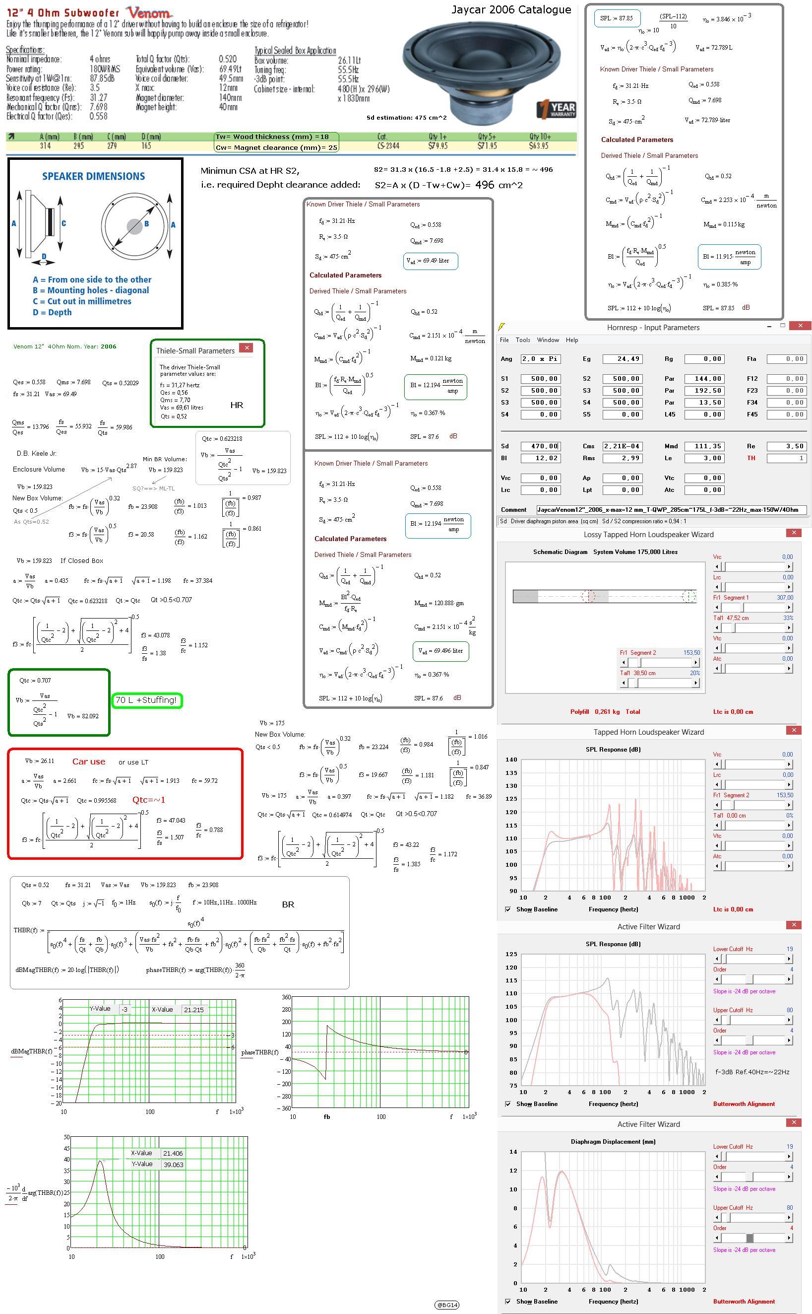

I have some old Cattledogs here, let me look. From memory the Venom line was designed for sealed enclosures with smaller than normal boxes for a big hump in responce to make use of the raise in bass of the small volume of a car body

From 2006 catalog:

Hi ubza1234,
Thank you for posting Pictures of your Driver.
The minimum internal Volume choice would be for a stuffed Closed Box= 70L.
IMO:If you ever decide to build any type of Ported Boxes(SQ) for Home use: No less than ~160 L is Rec.
b🙂

Yeah, did this default 160.61 L/5.672 ft^3 [net], 24.6 Hz Fb golden ratio reflex [6” dia. x 16” long vent], but got sidetracked on something else and forgot to post it.
