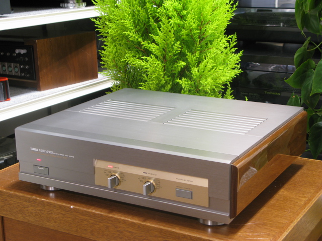

Who have heard this Yamaha Phono Preamp?

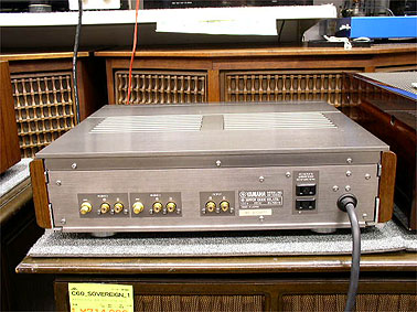

MC SNR Figures
The manufacturer either has access to lower noise transistors than I have seen or has screened devices to get those with the best noise figures. I can believe that by going 2 sigma out on the distribution curve that it's possible to get an En that is 50% that of typical. If they used 2SJ74/2SK170 devices and paralleled them they might get En down below 0.1 nV/sqrt(Hz), which is approximately what they would need to get ~95 dB SNR for 500 uV. BTW, I am assuming the 500 uV is applied at 1.0 KHz. Does anyone know for sure?
I assume not J74/K170 but rather J72/K147 and the described duals seem to be (at least from the photo) J73/K146
cheers Uli
Transistor Type in Yahama MC Amp
Uli,
Thanks for the additional information. Do you know what the parameteic differences are between those transistors and the 2SJ74/2SK170? Also, it would be interesting to get SPICE models for the devices Yahama is using.

Never seen that before. The MC noise figure is quite impressive.
Maybe just the A weighed measurement filtering effect? ''S/N比(IHF-A補正)''.
I have never seen one in the States. In fact I have never seen an advertisement for one of these. I am going to do some research.
any news ?
Service-Manual include schematics is here:
YAMAHA HX-10000 Service Manual download, schematics, eeprom, repair info for electronics experts
